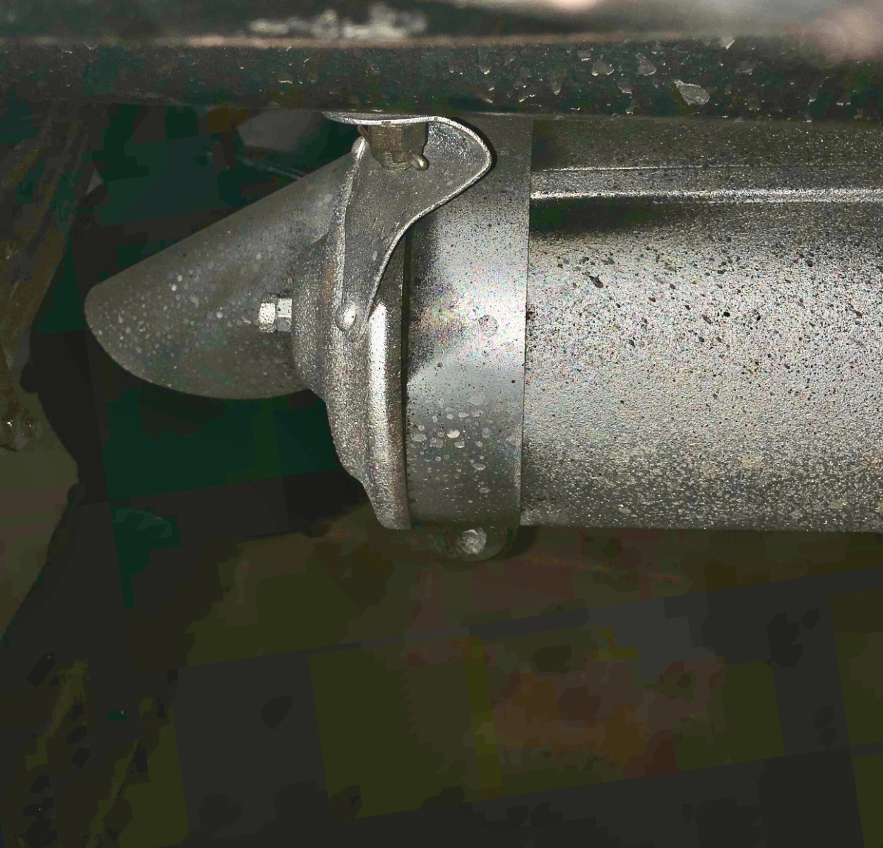

Have run one of these spot welded mufflers, they are just the normal take apart with spot welds to keep from blowing off the end cap on backfires. Most of the exhaust soot comes from the rear opening of the muffler anyway.
The small amount of soot from the seam is just spilling back, onto the muffler. Here is my install, but using the available exhaust deflector, to direct the exhaust down and away from the spare. Works good. Note some soot from the rear cap seam, as this is a std. take apart, not the spot welded muffler.

Thanks Dan, I’ll be ordering one of those deflectors.
