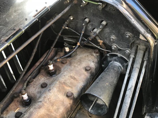

Anybody have a picture showing how Ford mounted the 1915 mag horn? A Google image search didn't find anything I trust.

The bracket for the horn is Lang's p/n 6437E.
If you search the "Vehicles For Sale" section of the forum, look for: "Nice Original 1916 Touring", listed by Kim Dobbins, listing date September 15, 2019. One of the photos shows the horn location:
Mag Horn.jpg (80.43 KiB) Viewed 2789 times

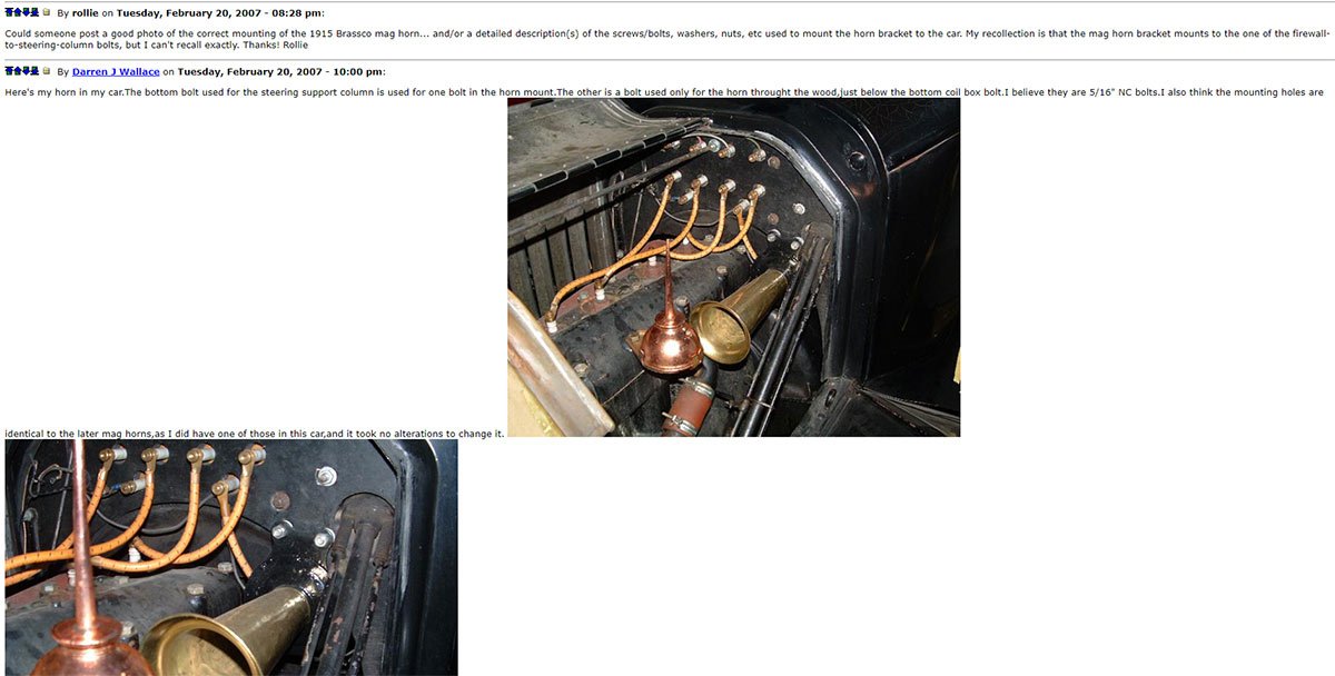

Also this from 2007.

That's about the only place you can put it if you don't want it to stick out.

If we assumed :twisted: that it was in the same location in 1917 the holes are more clearly noted in this discussion.
http://www.mtfca.com/discus/messages/29/31511.html
