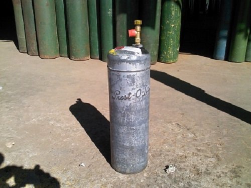

The tank you're looking for is a 40-cubic foot acetylene "B" tank with the valve offset of center.
I find them mixed in with regular acetylene "B" tanks at the local welding supply houses, Airgas and Praxair.
You can lay these tanks horizontal on your running board with the valve at "12 o'clock".

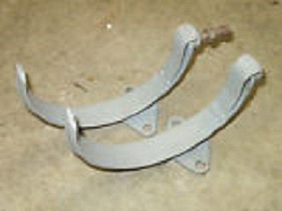

The tank mounts in either strap type, or forged brackets, attached to the running board.
I use the forged type brackets.... :)
The "good"..... 8-)
The gas is clean and won't foul your burners, light your headlights in about two minutes with no cleanup
when your through driving. Just close the tank valve and the lights go out in about 10 to 15 seconds..done.
The "B" tank lasts twenty-four hours with 3/4 burners. That is a lot of night driving!
Cost to refill a "B" tank is about 1/4th the cost of carbide rocks to create the same amount of acetylene.
I just drive the T over and swap tanks when I need one
Maybe someone can post the strap type that was often furnished by Prest-O-Lite.
ONE OF MY SWAPS
ONE OF MY SWAPS
PREST-O-LITE B TANK 1.jpg (44.41 KiB) Viewed 2876 times
FORGED TYPE BRACKET
FORGED TYPE BRACKET
PREST-O-LITE BRACKETS 2.jpg (14.26 KiB) Viewed 2876 times

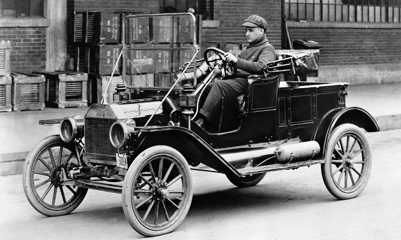

FORD COMPANY VEHICLE WITH A "B" TANK IN FORGED BRACKETS
