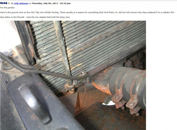

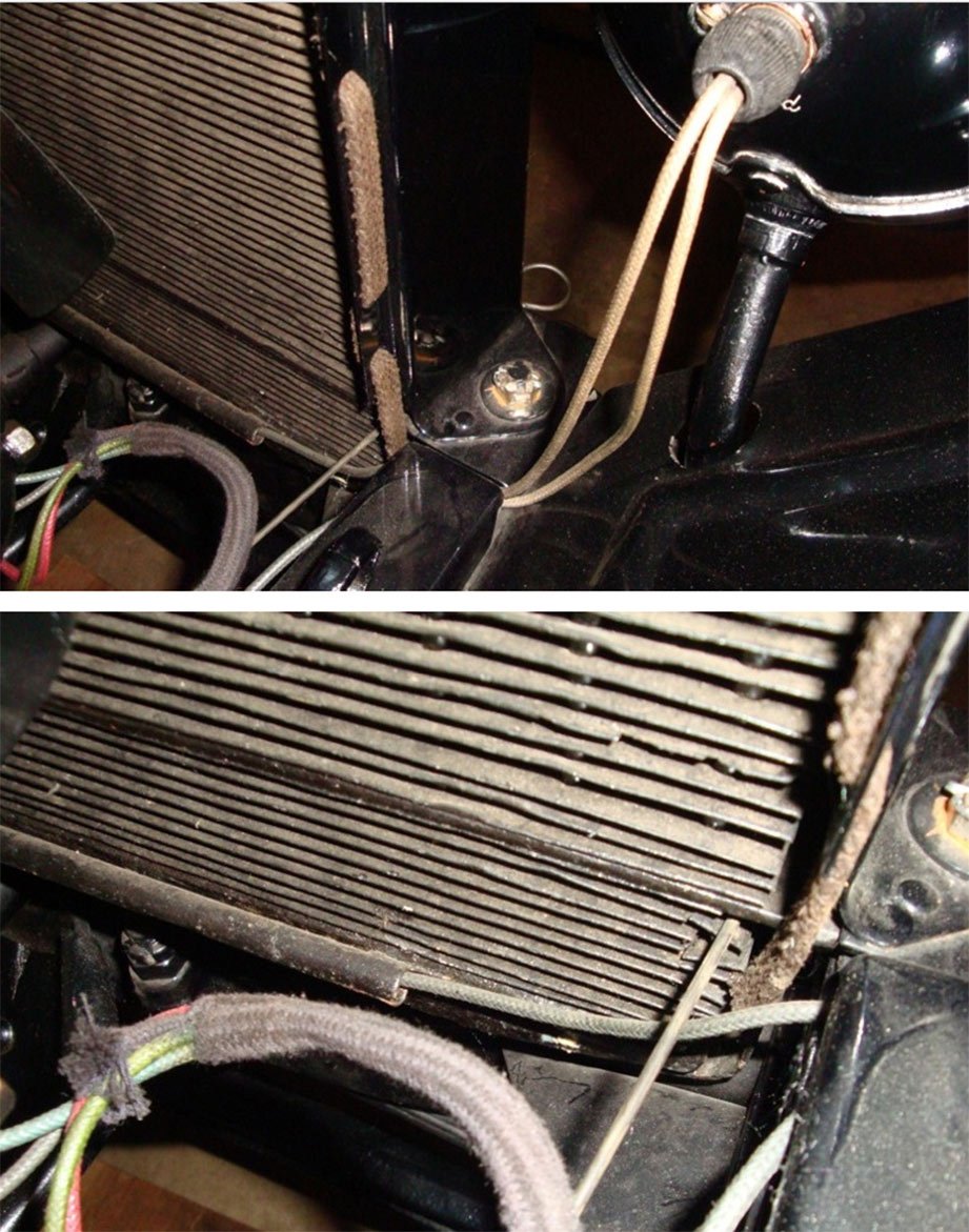

Working on a '19 non starter car. I have the mag headlights figured out. They work fine with the 28v bulbs from Langs. Question I have is the diagrams show a tube running between the headlights for the wires. I cannot find how this tube is attached of if it just floats. Does anyone have a picture of this detail or confirm how it is attached if at all? Thanks.
Re: headlight wiring question
Erik posted this:
http://www.mtfca.com/discus/messages/70 ... 1499522080
Also this: http://www.mtfca.com/discus/messages/17 ... 1309378046

Thanks for the pics. Clears it up nicely. It appears the tube was part of the old type rad so would be lost with modern core. Anyway, I have soldered one in so the wires will stay out of the fan. Thanks again.
