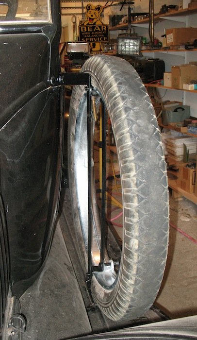

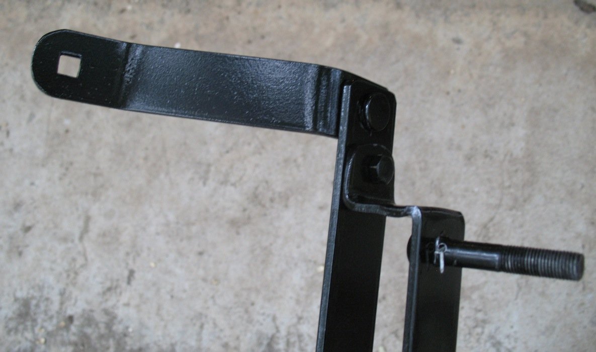

Post by Steve Jelf » Fri Sep 04, 2020 11:32 pm

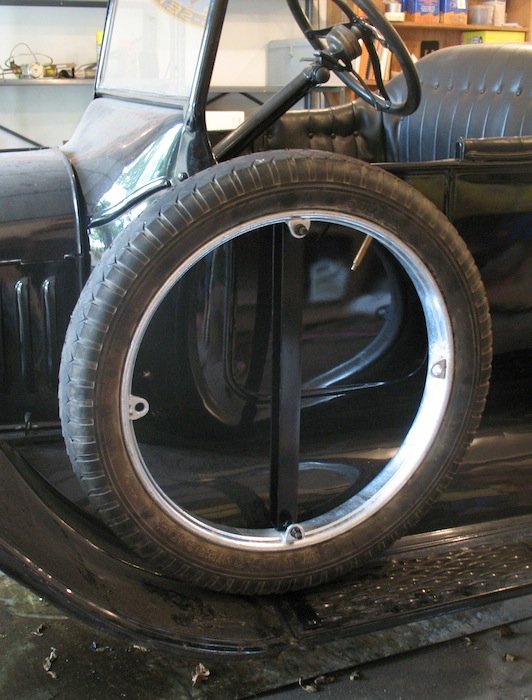

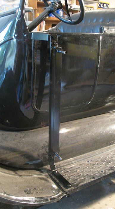

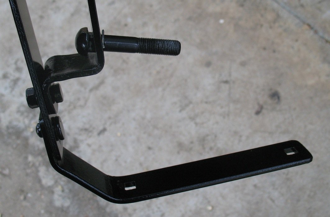

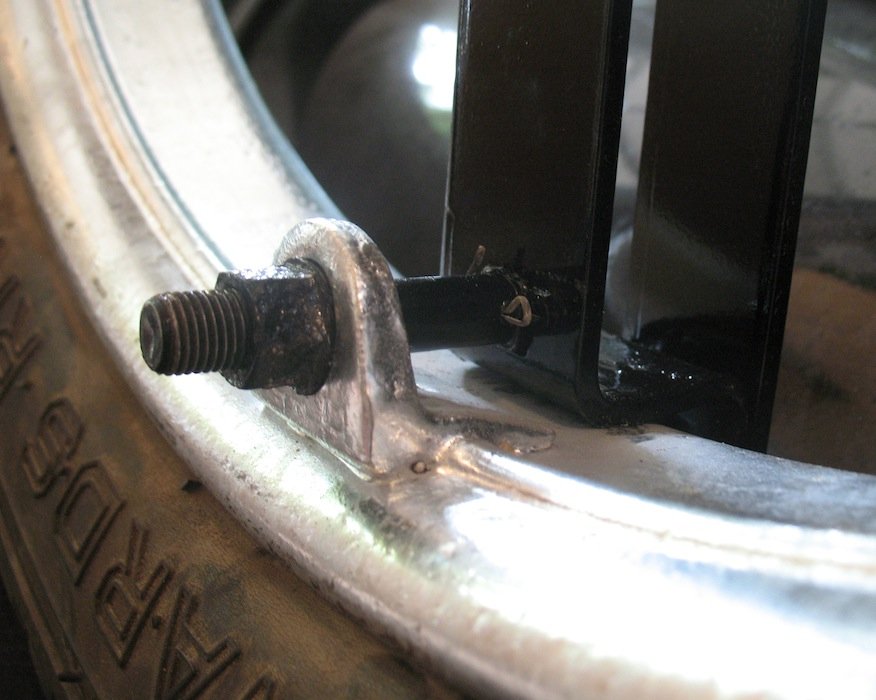

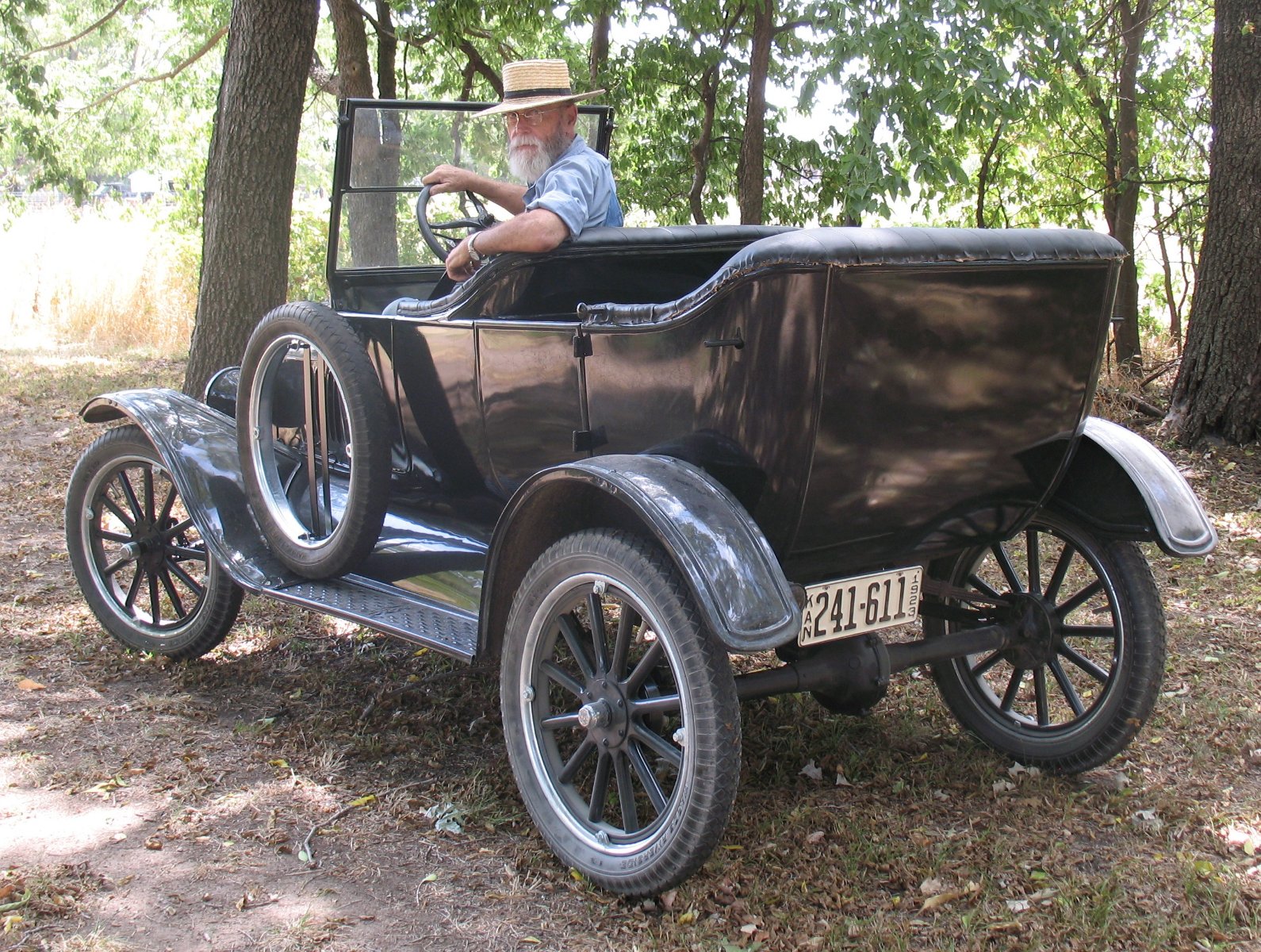

Here's mine. If I were doing this again I'd make it a little more stable by adding a brace attached by the next running board bolt toward the rear.
Top end.
Bottom end.
The whole works
Posts: 7345
Re: Spare Tire Carrier Heresy
Post by Steve Jelf » Fri Sep 04, 2020 11:36 pm
This worked OK, but eventually I installed a stock carrier on the back of the car to clear the running board for cans and camping equipment.

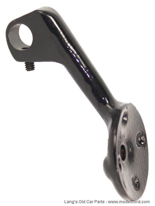

Post by DHort » Sat Sep 05, 2020 2:20 am

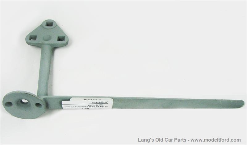

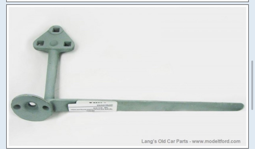

You need the carrier directly above this post. No need to put holes in your fender. Hopefully the three holes are underneath your body where this carrier is positioned. I have this carrier on my 1920 and I believe 1924 is the same. If the bracket for the light doesnt cover up the tail light portion of the carrier you could always cut that part off. It should look OK.

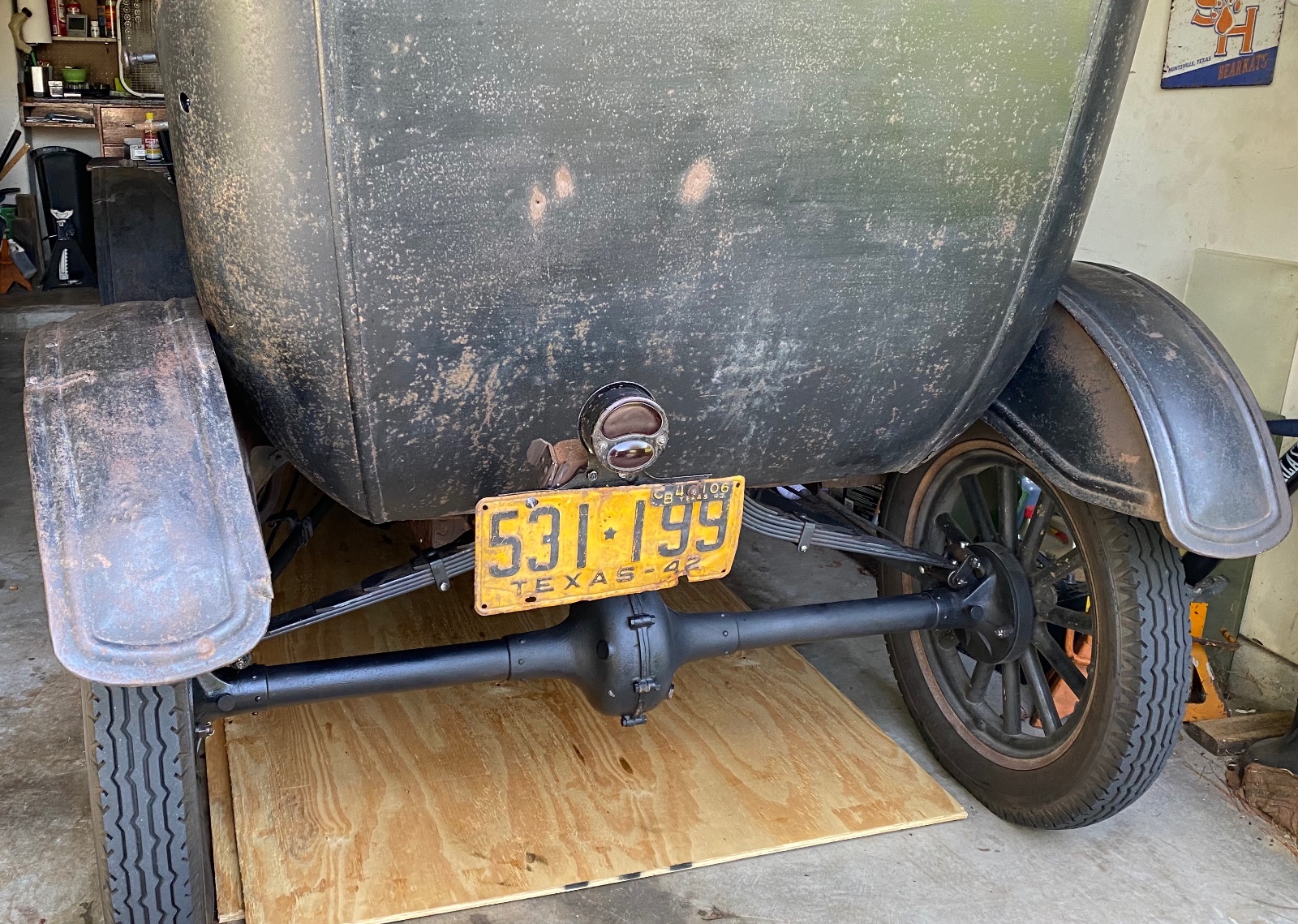

RustyFords
Posts: 1559
First Name: Don
Last Name: Allen
Location: Houston, TX
Post by RustyFords » Sat Sep 05, 2020 6:35 am
I’m having trouble visualizing where the bracket (in the.photo below) goes, and what the long skinny part of the bracket is for.
1924 Touring
Posts: 7345
Post by Steve Jelf » Sat Sep 05, 2020 10:50 am
I believe the part sticking out toward the right is the license plate holder. You would drill it to suit your plate, as there's a wide variety of hole positions from state to state and year to year. If you have a plate that's too long for it, you mount the plate to a piece of 3/4" flat stock which you drill to fit the bracket. I'm not sure where the whole thing mounts.
Posts: 5340
Post by RajoRacer » Sat Sep 05, 2020 10:58 am
That bracket is for a Touring & it mounts under the body on the left rear cross wood.

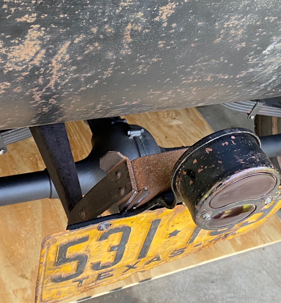

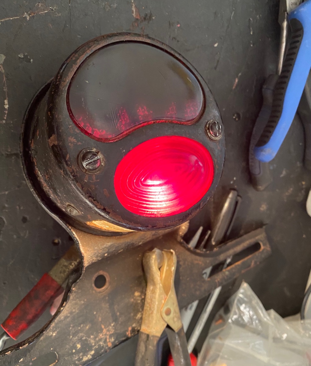

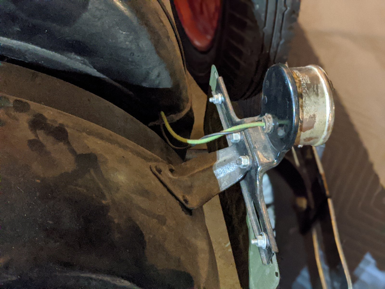

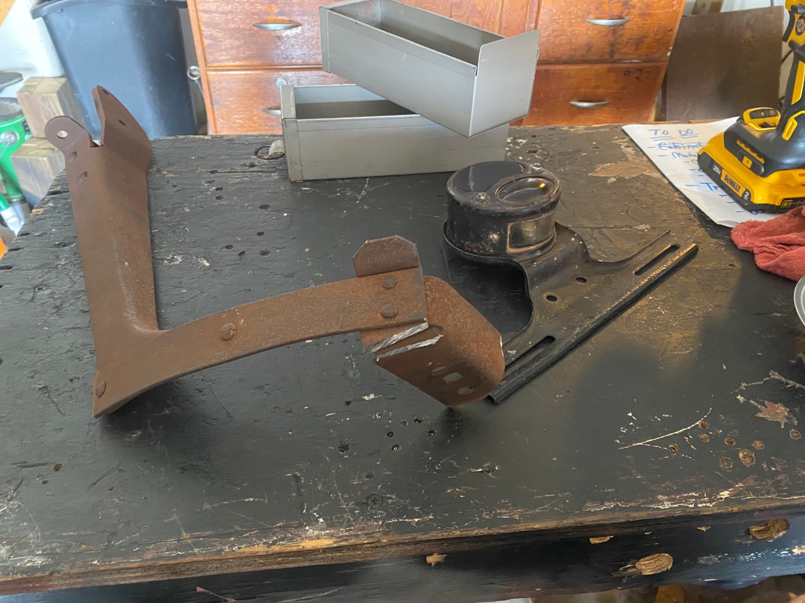

Post by RustyFords » Sun Sep 06, 2020 12:34 pm

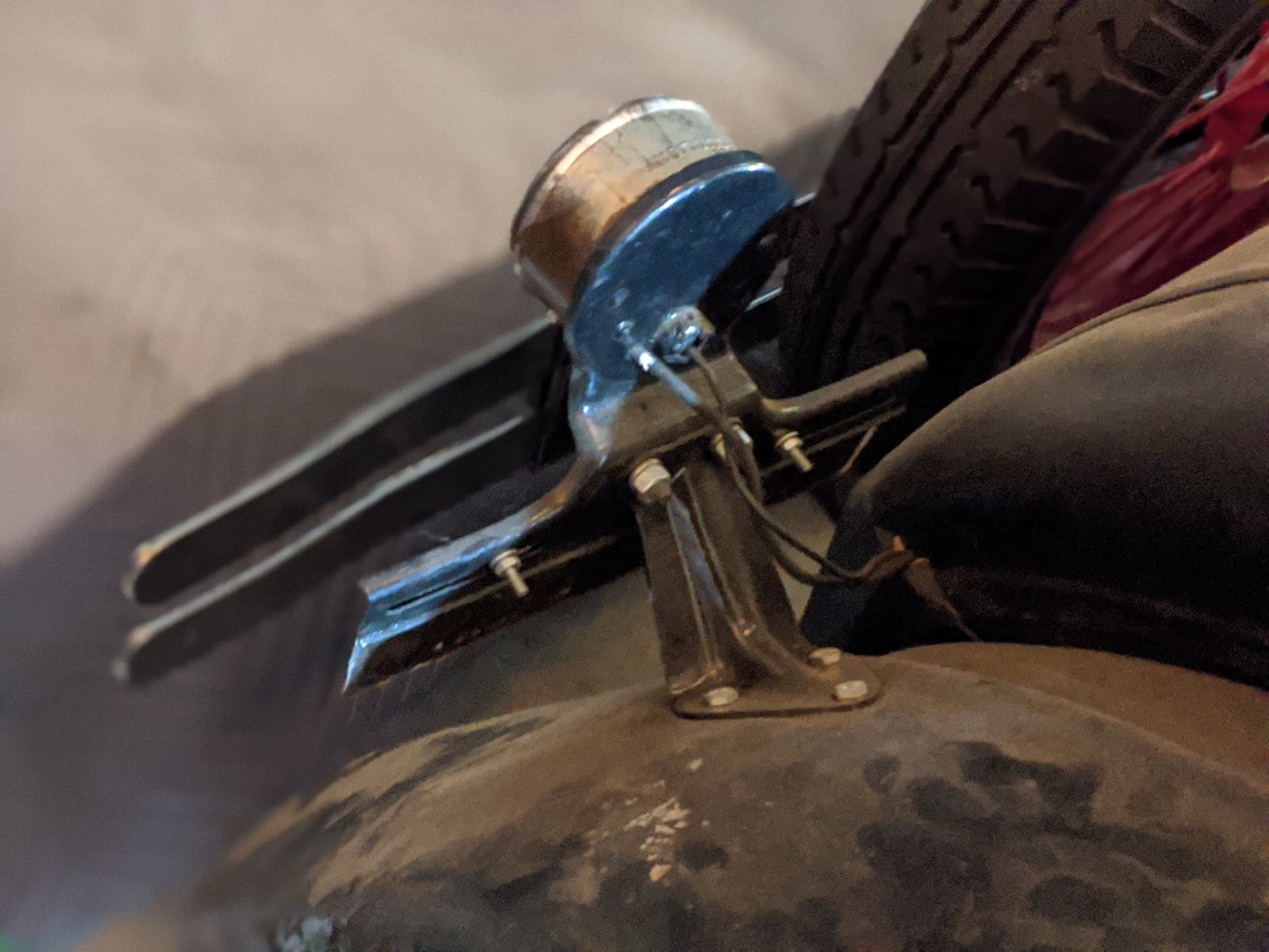

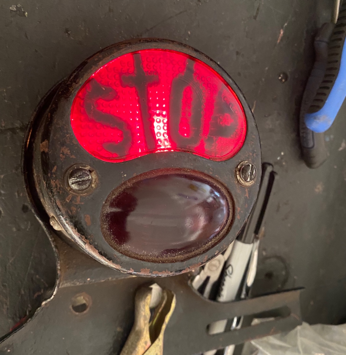

Thanks for all the superb tips. The bracket that mounts under the rear of the body gave me an idea...
I have two of the spare carriers that mount on the rest crossmember, both of which are beat up and heavily repaired. So I cut one of the arms off of one of them and made a taillight bracket.
It mounts to the crossmember, just like original and keeps with my “pre-1945 farmer hack”.
It’s just mocked up in the photos. It’ll come back off and get cleaned up, etc.

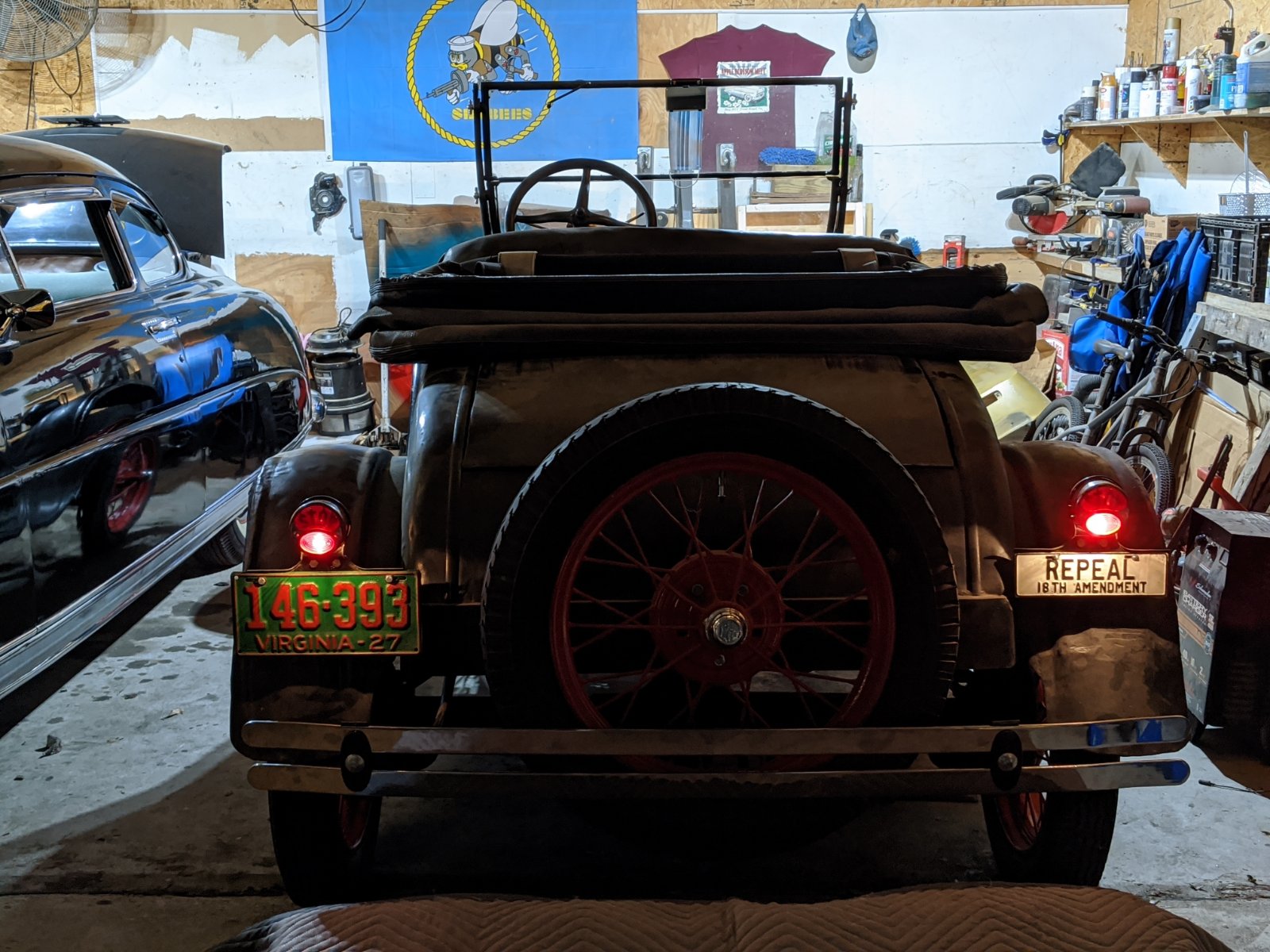

The vendors sell 'improved car' right side tail light brackets too.
Here's mine.

That’s a great looking runabout Terry. I love period political sign...how cool.
