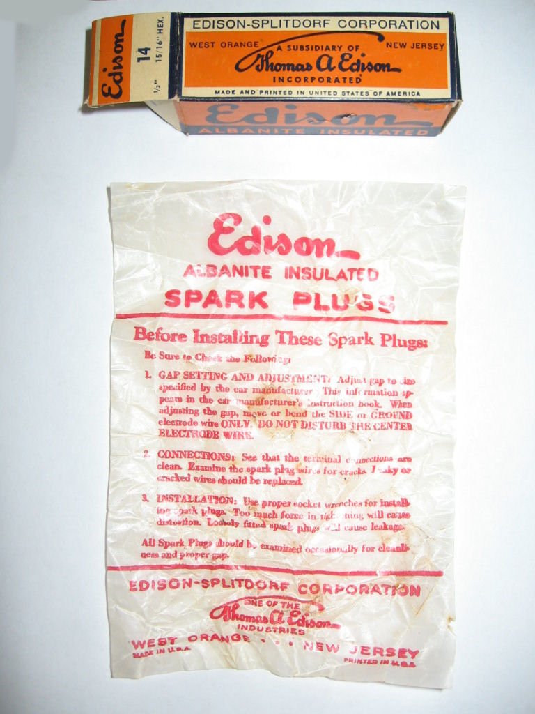

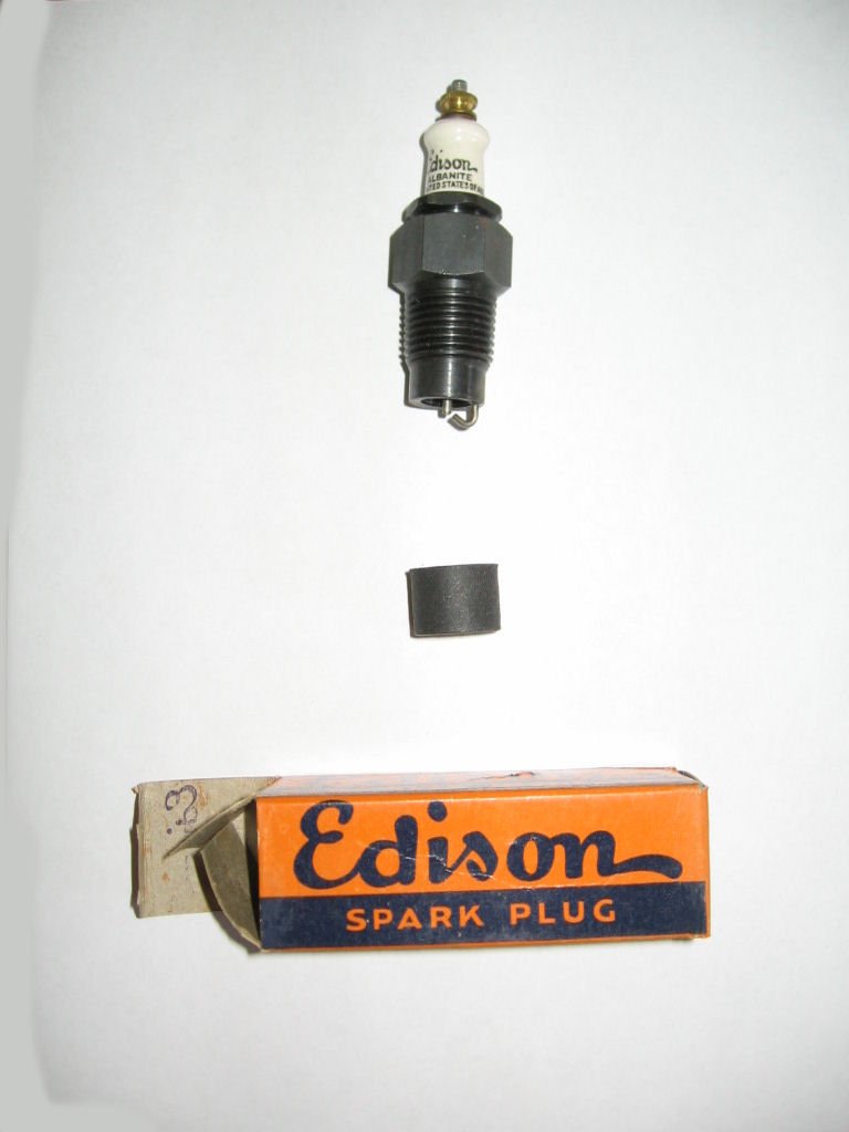

If you have taken photos and can move them onto your computer, you can just drag and drop them into the posting text box and the forum software will resize and insert them automatically, like this:
