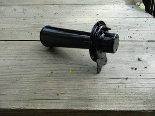

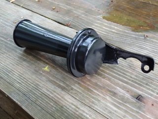

Is it a Magneto horn or a Battery horn?
Magneto horn operates on AC power and the Battery horn on DC power.
Magneto horn:
Battery horn:
Magneto horn:
Battery horn:

Horns are like starters, don't matter which terminal is which. Without knowing what brand of horn it is, it could be single terminal which would use the body for the return loop, could even be 12 volts like used on Dodge up to about 1926. If it does not work, it may just need a cleaning and lubed. Many of the older horns, there would be a screw holding the back cover on. Horns did require periodic maintenance such as lubing.

If it is a claxon horn such as a Sparton horn made for a Model A, but many times used on a Model T, it has a small electric motor which turns a wheel which moves against a diaphram and makes the familiar OOGA sound. This type horn needs a drop of oil at the bearings and perhaps a little fine sandpaper on the commutator. There is a screw which can be turned with or without the cover on the back of the horn. This screw regulates how tight the wheel is against the draphram and changes the sound of the horn. If it is too tight, the horn will not work. If too loose, the motor will just spin without making a noise.

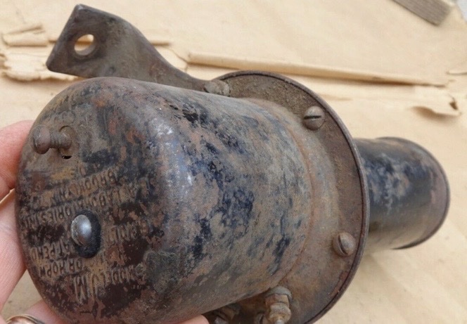

In addition to the horn that was in my coupe's trunk, there was one bolted to the bottom of the frame where the emergency brake handle is attached. It used one of the two bolts that attaches the brake handle to the frame. The horn looks like the first one in the photos posted above. It has a "thing" in the center of the back of the cover that can be turned with a screw driver. When you turn it, you can feel a click as it is turned. I assume it adjusts the sound or what??? There is also a "regular" screw located near the corner of cover. I wonder what that is for. The nuts on the small bolts that attach the cover to the bell can be turned easily so I could take it apart. Is there any reason to take it apart before I test it? I assume it is a magneto horn. How can I test it?
There is label attached to the side of the cover. It contains the following: motor horn, 6 volts, E.A. Laboratories Inc, Brooklyn, NY, made in usa, and a large EA.

EA, and others, provided horns for model A's. They are motor type horns, a different beast altogether than the T horns.

Are the photos reversed in the 3rd post? Isn't the top one a battery horn and bottom one a magneto horn?
- Posts: 5511
Re: Testing a horn
They are in the correct order.

Your horn description of an E. A.Labs horn is indeed a motor horn. Should test easy on 6 v DC.
As posted by others, the Model T used a battery vibrator or buzz horn, no motor, as the Model T battery horn goes BLATT--BLATT..
Those motor horns go AH-- OOO-- GA.
This is probably what your horn resembles, the cover is big as it covers a motor mechanism.

The horns as ID above are correct. What horn you have without seeing it? Could be aftermarket? Just because someone posted something does not make it correct. How about a link to where you saw the information? Even the 1928 Model T parts book show the two as shown above as magneto, small tomato paste can cover and battery, tuna can back covers. There really would not be room for the points on the battery horn under the smaller cover, it need the larger cover for them to fit.
http://www.mtfca.com/discus/messages/50 ... 1432183198
Tuesday, May 19, 2015 - 08:47 am by John Regan;
I agree that the top pictures are of a magneto horn. If it has 2 power connections on it then it is the likely the early version which started in 1915 and ran up until just after Ford began using the twist turn type of combo light switch and horn button mounted on the steering column which I think is sometime in 1918 or so. There are other characteristics of the earliest horns such as a shorter bell, brass bell ...etc. If the magneto horn has one power connection then it can be used on just about any of the later T's starting with those that used the combo switch/button. If you look closely at the 2 different horns I think you will notice that the rim around the flange part (the part that the horn bell is welded into) is much deeper on the battery horn and the battery horn motor cover is a much larger OD at its outer rim area. The magneto horn motor cover is much smaller in diameter at its outer rim and the magneto horn motor cover will not fit over a battery horn because the battery horn motor is much larger in O.D. under that cover. The later 26/27 horn motor cover is fairly shallow and will not fit over the magneto winding I don't think. I may try to fit one up today to verify that. All battery horn motor covers are held on with just 2 perimeter screws while the magneto horn is held by all of the perimeter screws. The diaphragm for both motors is almost the same with the magneto diaphragm being about 1/16" smaller in diameter than the battery horn but the hole pattern in it is nearly the same. I make up extra diaphragms, bells, and mounting brackets and several guys have bought those and fitted them successfully to magneto horns. The original diaphragms were made from spring steel but often have pin holes rusted through them because water goes in the open front end rather easily. I make my new ones from stainless spring steel but otherwise are the same as factory. It really helps to do that if you can get a piece of the right stuff. The broken bracket on the 26/27 battery horn pictured can be replaced and are currently being reproduced in 2 versions - paper thin steel and full 1/8" cold rolled steel as original. Usually the bracket outlasts the horn so you might be able to salvage a bracket from a junk horn that is otherwise beyond hope. If you are restoring a horn and needing a part send me a PM and I might be able to point you in the right direction.
My note; The motor in this case is the magnet coil that operates the plunger in the battery horn that is controlled by a set of point not a rotating motor.
