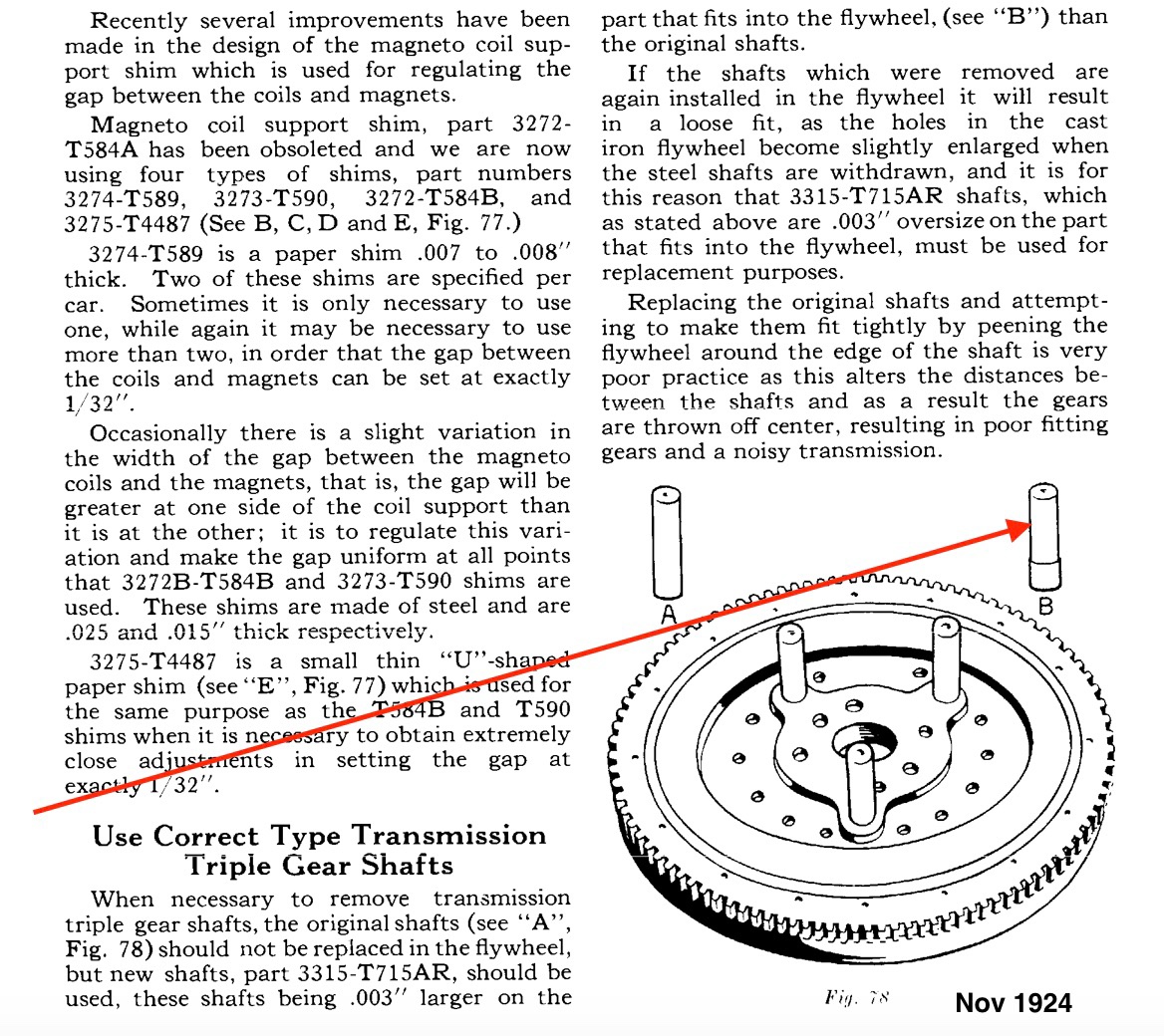

- Posts: 4064
Re: triple gear pins grinding
Ford Service Bulletin, Nov. 1924 describes the use of the 'AR' part suffix triple pin, as opposed to the factory pin which can't be reused if punched out as the hole in the flywheel is now enlarged slightly.
