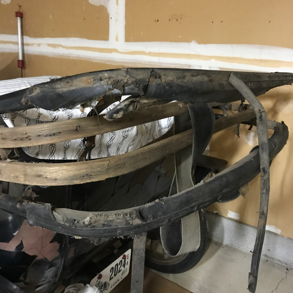

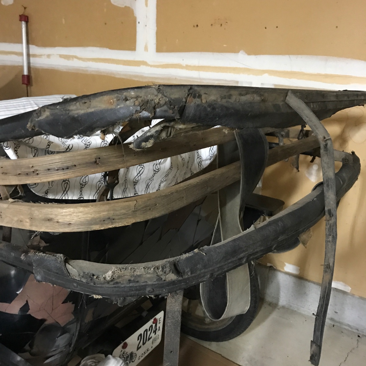

I am finishing up the rear end and driveshaft rebuild on the ‘24 Touring and simultaneously and slowly gathering parts for the ‘13 Touring project.

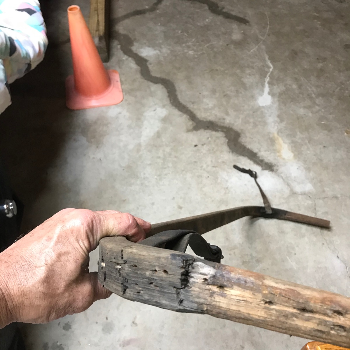

After removing what was left of the well-worn top, I have bows that have seen better days.
I have received a recommendation for new bows from a member here. I also notice that Snyder’s sells a set of 4 for $310 and Lang’s for $99. Not sure why such a big difference in price?
Both state that the ends have to be shaped to fit the irons.
Anyone here use these?
A big deal or easy to shape?
Any chance of finding a good original set?
Other advice?

The $99 set is most likely the steam bent solid oak. The$310 are likely the laminated bows. They say the laminated are more stable and less prone to the curve straitening.

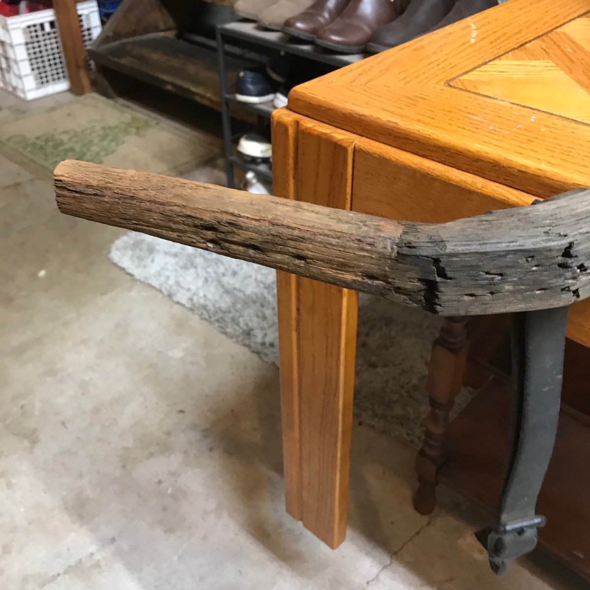

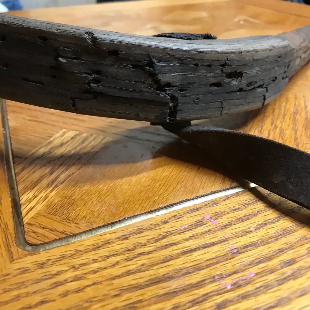

Some fellas use a product called "Quick Polly" if I am correct. It is an epoxy that fills the gaps and makes wood strong again. In past posts they talk about it.

I would call Snyders and ask to make sure, might be an old description that got over looked and was not updated and are really laminated. The 99$ Langs price is in line with other steam bent bows they sell, then a price jump for laminated.

Perry: Quik Poly was a wonderful product for repairing soft or holey wood. Unfortunately it is no longer available. The maker retired and refused to sell the formula and rights to anyone. Gone forever I’m afraid.
