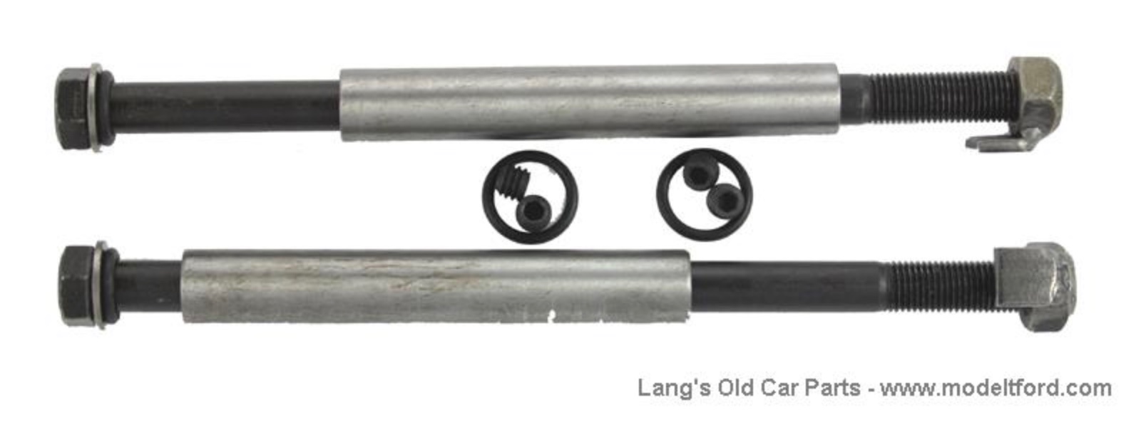

Is there anyone who has had success with Michon externally adjusted pedal shafts ?

I have those on everything, Terry and I generally like them. I have had an issue. The little tab inside on the shaft was barely hanging on by a poor weld. I caught it in time and fixed it, but could have made a mess. I passed that on to Lang’s, where I purchased them.
Another issue, I do have one on a reverse pedal that seems to loosen up by itself. Haven’t had time to figure that out yet. I’ve temporarily baling wired It in place, but will figure it out when I have a chance. Haven’t driven the old girl this year yet.

Tim, I have never used them, but I have a set, purchased decades ago, that I've never used, and I thought that I might try them in my next transmission. Would replacing the nuts that come with it, with NYLOK nuts with nylon inserts to prevent movement, work?Dropacent wrote: ↑Thu Sep 10, 2020 12:02 pmI have those on everything, Terry and I generally like them. I have had an issue. The little tab inside on the shaft was barely hanging on by a poor weld. I caught it in time and fixed it, but could have made a mess. I passed that on to Lang’s, where I purchased them.

Terry, the nut has a tab welded to it. Might be worth a try, though. You’d have to be careful not to melt the nylon when attaching the tab, and it needs welded on good.

Terry, thanks! I may have had an ah,ha moment. I have so few anymore. I looked up a picture on Lang’s site, and they look like they come with a locknut. I probably melted the nylon when I welded the tab back on, causing my shaft to loosen by itself. Maybe also why the maker is putting a little teenie weld on.
I still like them , just be careful before installing that the tab is on good.

If I had to reweld one of those tabs on, I would rig up some way to hold the nut mostly submerged in water or some kind of a heat sink to keep from damaging the nylon. Use short quick bursts with the welder to keep the heat down. JMHO. Dave
