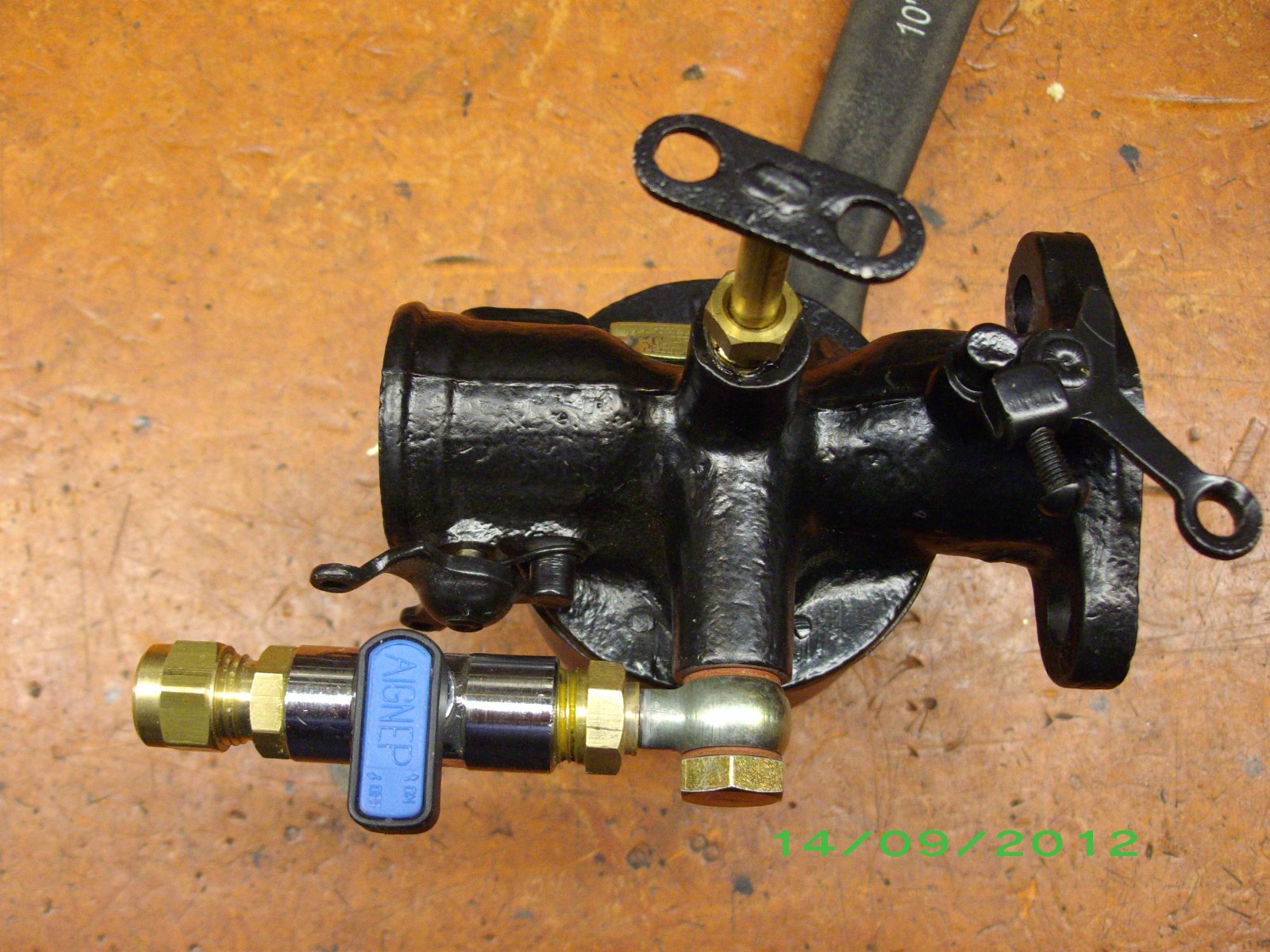

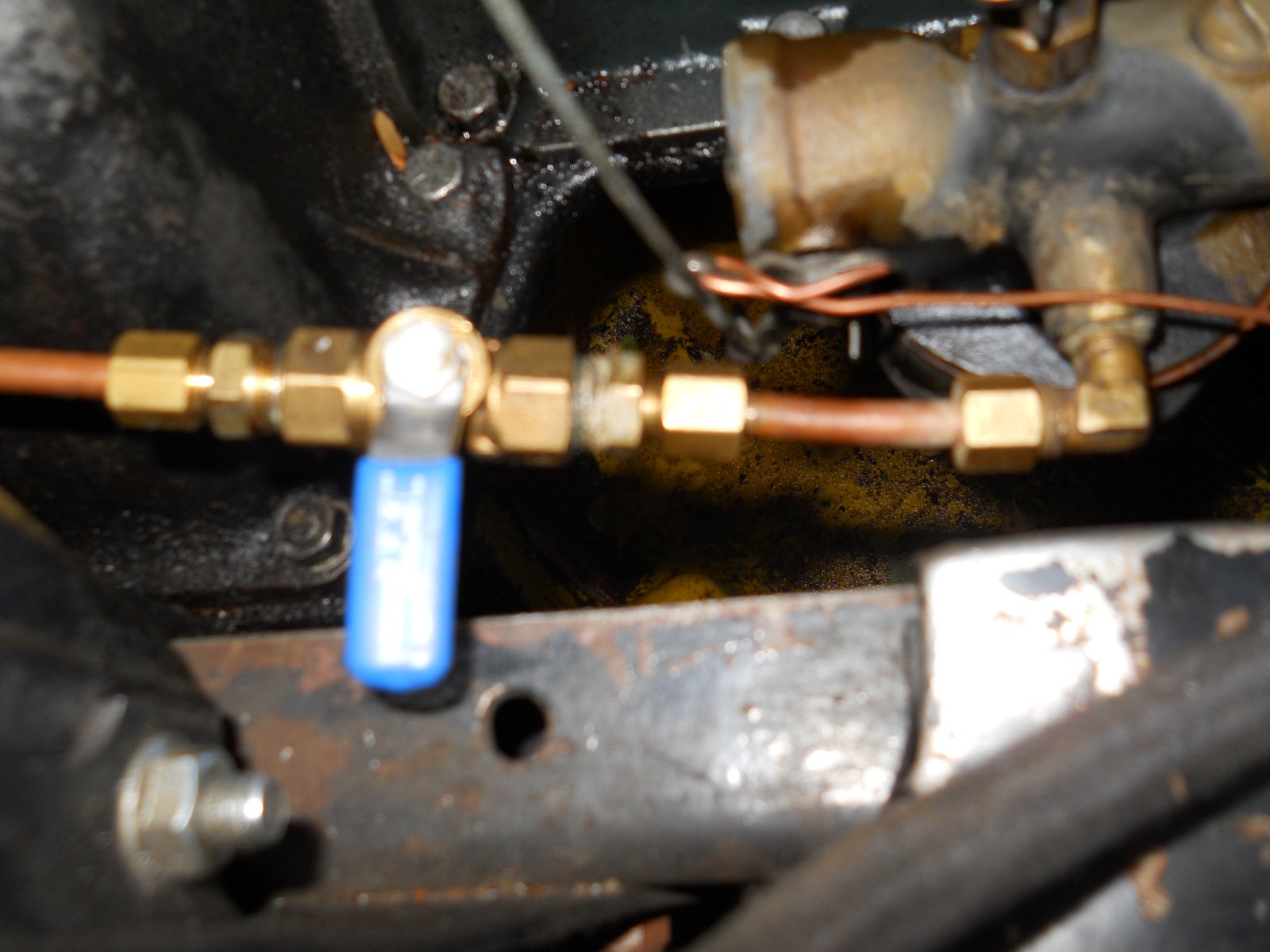

I installed a ball type inline shut off. Not original looking but would rather have one that worked then worry about appearances. In my OP, the modern type brass used to make the valves like you are using is too hard and makes hard to get a seal plus they are not real user friendly to open and close. If you want to keep the one you have you can try lapping it in with toothpaste or Timesaver then relube. Are you sure it is not leaking where it is screwed into the carb? Looks like it is installed really deep. Normally would expect to see threads showing, not seated all the way to the flats.

Post by ABoer » Mon Sep 07, 2020 12:03 pm
Bob , I use this one for years now , no problem .
Toon

There are numerous valves available to plumb inline - the "better" one that Lang's sometimes carries is a much better design - spring loaded as was the original Ford oil & radiator petcocks.
