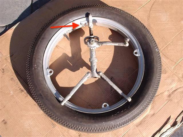

Re: 21" demountable rim lugs
I have at least one like that on my 26. The valve stem hole is in the right place. The notch will allow you to put the rim on without removing the bolt from the felloe. It is notched in such a way that when you put the valve into the felloe, the lug will drop right over the bolt. Perhaps there might have been a type felloe with non removable bolts?
