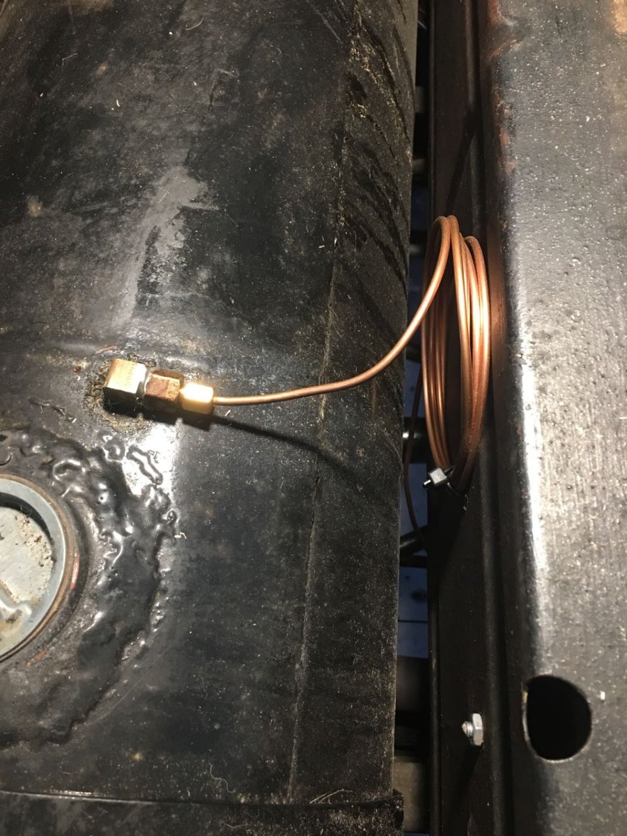

There are lots of people who will disagree with me but I use exhaust gas pressure in the tank and can climb steep hills with only a gallon of gas in the tank. Only a few inches of water pressure is needed to push the gasoline to the carburetor. The pressure builds up when going up hills because the engine is pulling and producing a lot of exhaust, exactly when it is needed. The exhaust contains mostly carbon dioxide, a non combustible gas, which is safer in the gasoline tank than air which contains oxygen. I use a small diameter copper tube which is long in length and coiled under the seat. The copper tubing cools the exhaust gas so that it is at the same temperature of the air under the seat when it reaches the tank. When cresting the hill the exhaust pressure is reduced and the flow is reversed. The gasoline fumes that reach the exhaust pipe are miniscule and mix with the gasoline fumes already in the exhaust pipe without any consequence. The vent in the cap is closed off and a tap added to the top of the tank for the tubing. I use an O ring on the cap as a gasket. One added advantages is that I don't have to live with fumes coming from the cap vent.
People have said that I am going to blow myself up, but i have used this system for years and know of other Model T owners that use the same systems. I have promised to let everyone know is I kill myself.

Seems to me that the space inside the gas tank will be so rich with gas fumes that you'd almost have to insert pure oxygen to achieve a combustible mixture. I'd feel completely safe piping exhaust gasses into the tank. Here in Florida the hills are just the overpasses and they don't give us much trouble.

Grandpa Ford,
There is nothing wrong with using exhaust pressure on the gas tank.
Some of the very first Mercedes cars had the fuel tank at the rear and used exhaust pressure to push the fuel up to the engine.

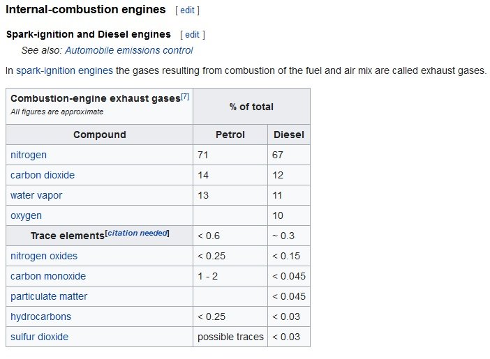

- Posts: 6478
Re: running out of gas
I don't want this to start a discussion on ethanol fuels since its about combustion in general. Water vapor is a result of a carbon based fuel and oxygen. Cooling the gases in the copper tube may act as a still causing the gases to condense. I'm certain you have been behind a car at a stop light only to see so fluid dripping from their tail pipe as the took off. Likely water vapor and/or unburned fuel. What is being pumped into the tank is likely Nitrogen oxides, carbon monoxide, water, particulate matter, hydrocarbons, sulfur dioxide and etc. Not a problem if you draft off a pint from the sediment bulb to remove what ails the engine now and then.
