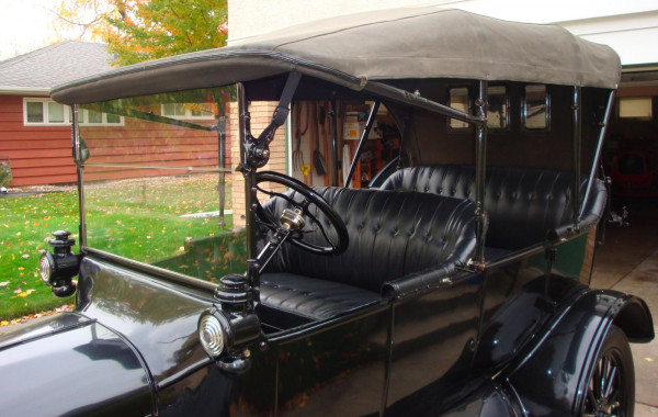

Here is an example of a wind-breaker on my dad's 1917. He made and installed the top himself in 1951 using the original top as a pattern. There was no comparable leatherette top material available at that time so he used Haartz convertible fabric.

Dave - the photo of my dad's touring that I posted shows what I call a "wind-breaker" on the first bow of the top. I don't know what Ford Motor Company called it if they called it anything at all. Click on the photo to enlarge.

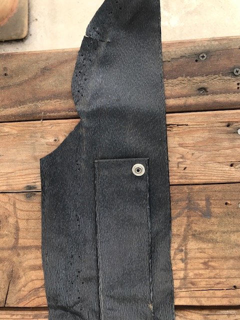

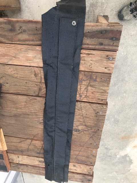

I just replaced a top on my 21 Touring that came from Carters some 45 years ago. It had the rain flap that folded down the front of the windshield. My new Classtique top did not have it. Here are a couple of pictures. It had snap fasteners at each corner for a side curtain. Would not be hard to make yourself it ypu do a lot of rain and snow driving.

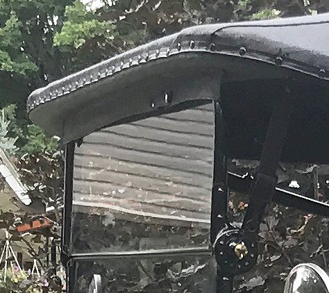

I've attached a photo that may better explain what I was talking about. First of all, my Rip Van "Wrinkle" top was in a never-opened box under my rear seat when I bought the car. The box was from J C Whitney and had a 1989 postmark. I have no idea who actually made the top but I'm sure it wasn't JCW. After I spread it out in the Sun the wrinkles disappeared and the top appeared like new. I decided to go ahead and use it.
The piece that goes on the underside of the front bow has a "rain flap" like John described. No fasteners at the ends but a little flap and snap where the windshield wiper would go if installed.
The problem comes when the wind starts to lift the piece the flap is attached to so water can come underneath. I used masking tape to hold it down on the windshield frame and that worked. I just want something more permanent. I thought of using twist fasteners since they would look more "period" and be easily disconnected should I want to fold the windshield down to let some air in.
