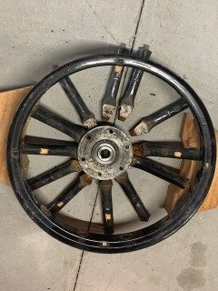

I'm stuck... Getting ready to send my 21" demountable wheels to Stutzman's for new spokes. What's the secret to removing the old spokes so I can sandblast all the metal parts?

Try this: Remove the bolts and the hub plate. Lay wheel down with the spokes on wood blocks to raise the hub off the floor with the back side of the wheel facing the floor. Put a large socket inside the hub, just large enough to fit. Hold a wood block on top of the socket and drive the socket and hub down with a BFH.

After removing hub bolts and hub plate, put the wheel on a couple of 4 x 4's, and step on it. Keep one of your free hands on a wall or you might fall down.

If you are replacing them because they need replacing, just cut them and use for kindling.

Sawsall will make quick work of the job.

Thanks for the suggestions! The one that prompted my original post is still not apart. The second one literally fell apart as soon as I took the bolts out. No BFH required! On to the next one. Back in my Navy days we had lots of those BFH references. My favorite was the Navy toolbox. It had two tools: a BFH and a prophylactic. If you can't fix it...........! Thanks again for the help.

And the winner is...... Steve Jelf, for his jump on it method.
