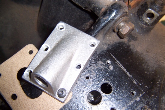

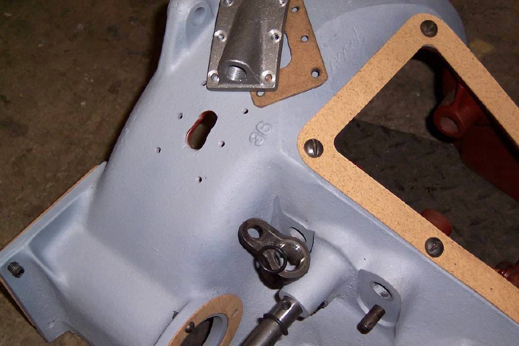

Installed mine with just drill bit. Made two holes spaced and then filed away the center portion.
Think now some new kits come with a template, and fancy defector plate too. My install was the simple one, and to get the correct spot over the magnets to get the best toss of oil thrown up, did it with the hogshead on the motor.
Knowing that only a couple of holes and stuffed rags to catch the most of the shavings. (The entire engine and trans was going to be disassembled and rebuilt so no worries)
That helped place the fitting in the best spot. Drilled and tapped holes for the mounting screws and made a gasket too. Socket head machine screws hold the fitting in place, didn't want any nuts or bolts or stuff inside the hogshead that could get loose!
Locating position and drilling main center holes and the mounting screw holes.
Finished up with hogshead off during restoration.

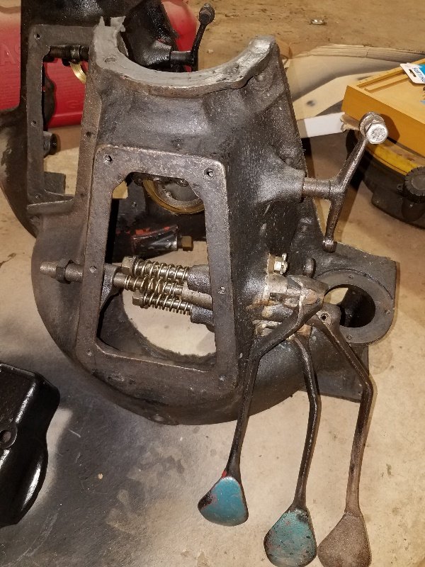

I drilled the same two holes and then used a hacksaw blade in my jig saw to finish the hole. That might not work on a wrong hand drive car with the pedals likely to be in the way.

Alan.... Luckily, the hog's head is off, and the pedals can easily be moved out of the way. Thanks!
