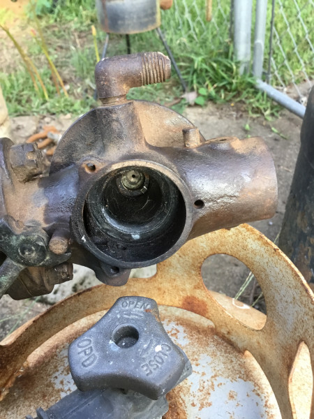

How do I get the black cone out? I removed the wire keeper, but cone is sure stuck.

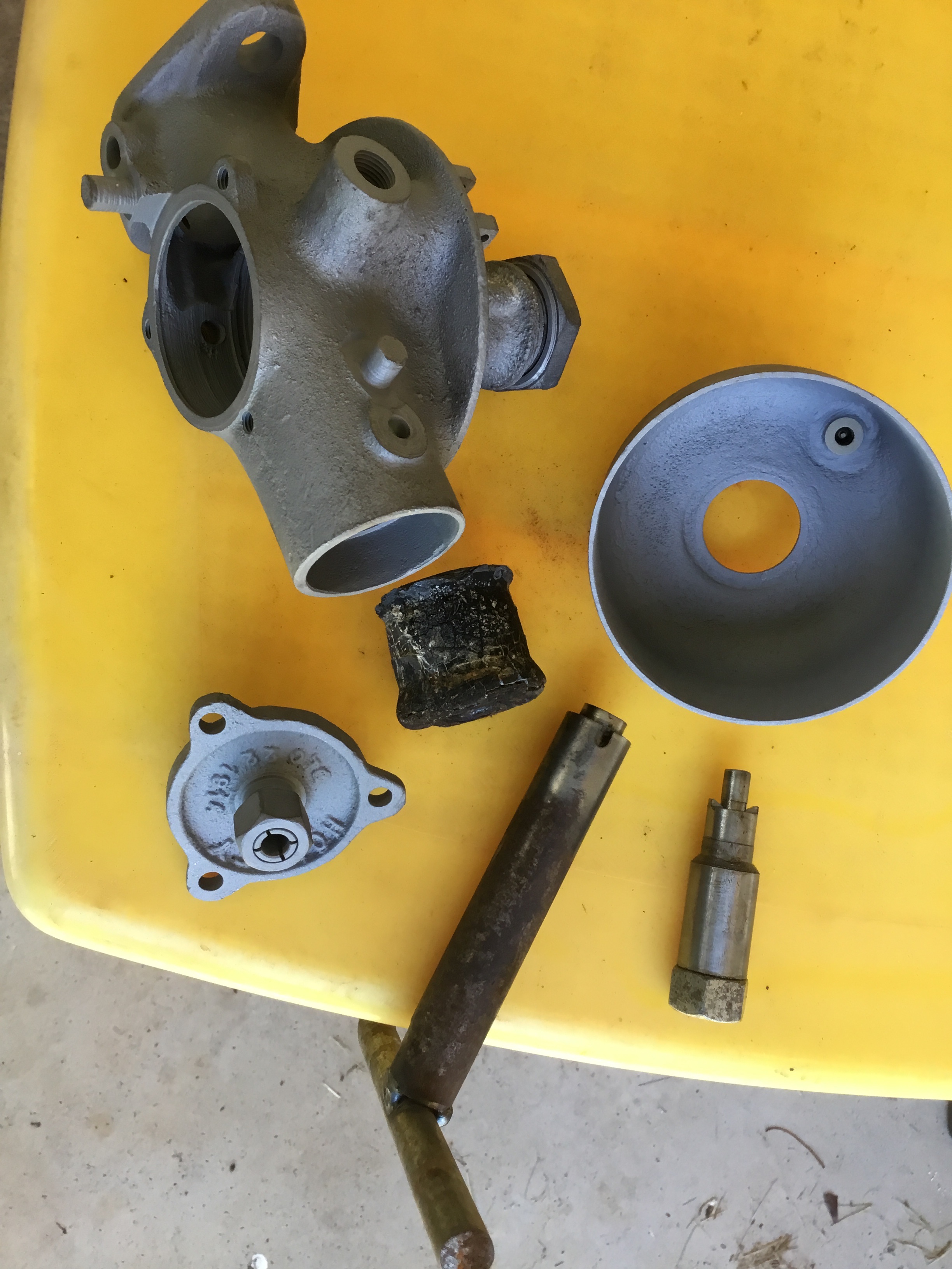

Thanks Guys, had to dig it out. Made a couple of tools to finish getting it apart and all went well after the tube.
