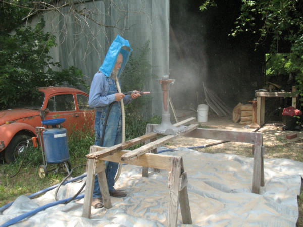

...don't use common sand, it contains silica which and lead to some nasty illnesses.
True, but there are two safe ways to use it. If you're blasting outside you can wear a hood with an outside air supply blowing into it. I made my hood from stuff on hand and use a shop vac for the air supply. The only thing I bought for my air supply was the hose.
Notice the tarp. I am cheap enough to collect the used sand, screen it, and add new sand to it.
The other safe way to use sand is with a blasting cabinet. The blasting happens inside the cabinet where it can't reach you.
Obviously, outside you can do large items that won't fit in a cabinet. Cabinet blasting has the advantage of being an indoor all-weather operation

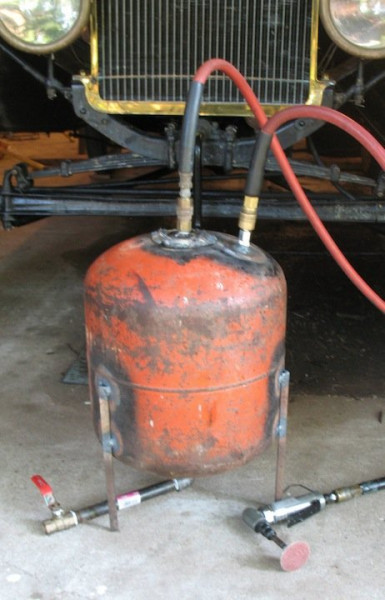

Either way, blasting takes a lot of air and you need a big compressor. That's going to be the most costly thing to buy if you do your own blasting.
Compressing air condenses moisture. Water in the lines will put a stop to your blasting. So you need a moisture trap. I made mine from an old air bubble I bought for a couple of bucks at an auction. It also keeps water out of your air tools, of course.

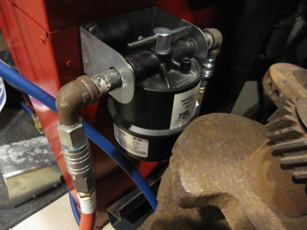

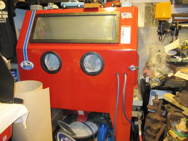

As others have stated TP tools know their business and the only folks I deal with. The new 9736 Contender blast cabinet would be my choice if I did not currently have my pictured patriot cabinet. As Steve has pictured, I also am using the pictured 30 gallon accessory tank when blasting.

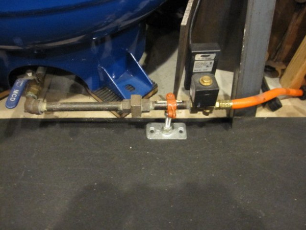

You want a cabinet coalescing moisture remover kit, #4260-01 and add a automatic low point tank relief (first picture) my relief. is set for 10 seconds every 15 minutes. I'm a big fan of the Quincy air compressors a 60 gallon a5HP 2-stage should be fine for small stuff, with my extra 30 gallon tank it's plenty but if I did not have that extra tank I would have got the 7.5 2-stage for my application.
Go for the optional HEPA vacuum, #VAC-50 as far as abrasives I have been using the speed bead that seems to cut quicker and very low dust in the cabinet. I also use the Gerson signature pro series dust respirator, hope this helps.

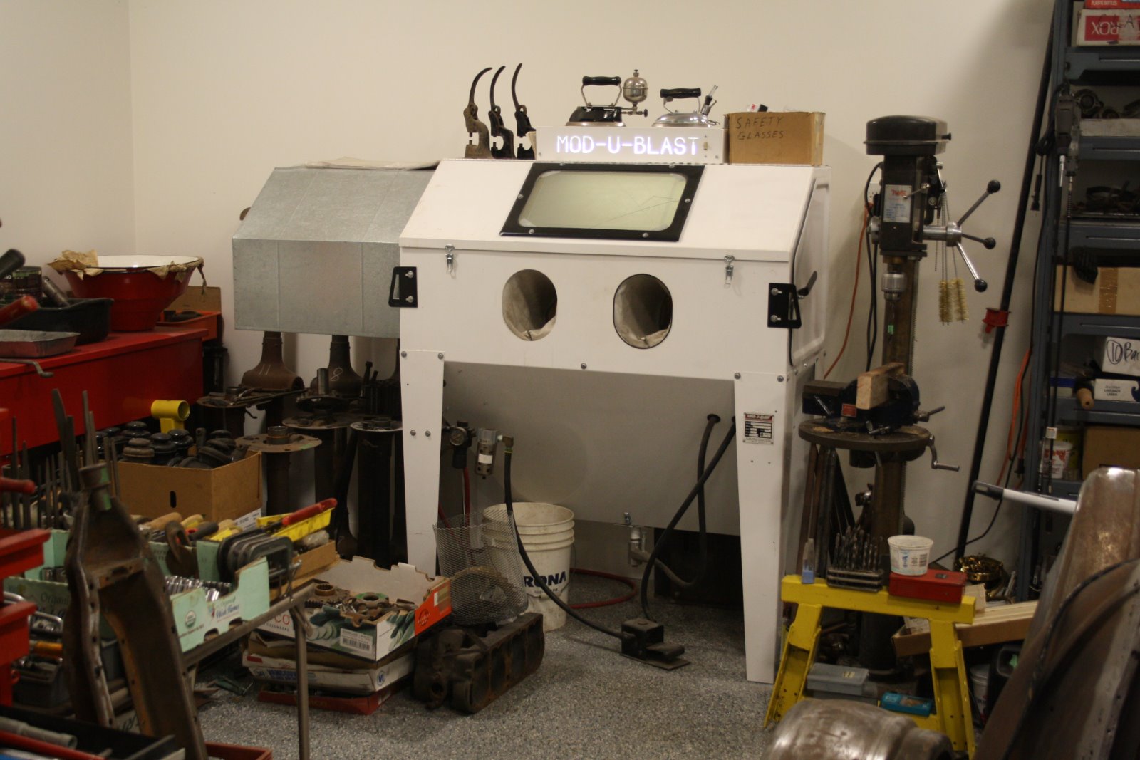

This is a blast cabinet

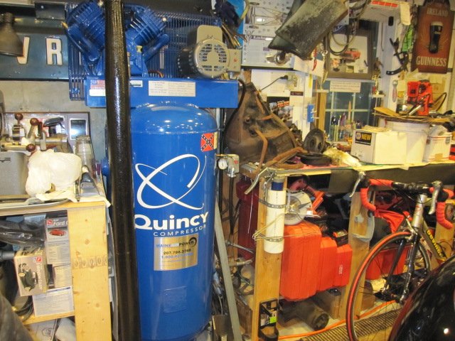

before my shop was even finished,there was a 5 hp 2 stage Quincy setting in the corner! I love that thing!BUT if you have the option,put the compressor outside the main shop in a little "outhouse" as the noise will drive you NUTS.
I would like to know more about that moisture filter made out of what looks like a propane tank?
