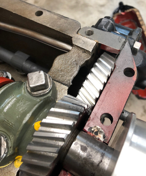

Since you have the pan off, easy to remove the front plate ( timing gear or timing cover - cylinder cover) and install the rope seal.
Seat it with the cylinder side of a socket the same dia. as the crankshaft. Then refit the timing cover, being sure to tap it in place while aligning the timer cover to the timer tool to insure the cam shaft is centered with the timer. Important to use that tool!

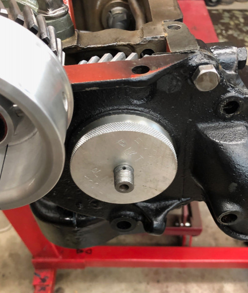

Timer tool used to align cam shaft with front plate. Keeps the timer rotor in the proper relationship to the cam and the timer case.

Oh, duh! Gosh.. I didn't think of that extra bit having off the front, that could be removed! But then, I wouldn't have known about yet another tool I don't have...the timer tool!

Yep, get that tool. The one shown was made by Gene French, the rebabbit jig guy
Works great and low cost.

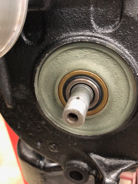

When centered the front plate can then be fitted with modern neoprene type seal on the cam shaft, to prevent oil leaks into the timer case, and do away with the felt seal and the brass plate over it. Gets rid of un-needed stuff there!

The tool shown in my photo is this one from Gene, the others work as well.The fancy KRW repro just costs more.
by Gene_French » Fri May 10, 2019 11:09 am
centering tool used to position the front timing cover concentric to the camshaft … this tool sets in the timer recess and assures the centering of the front cover during assembly … uniform timing and improved performance between individual cylinders is achieved as a result … price $24.00 + $7.60 flat rate priority mail postage in lower 48 states … actual postage outside this area or international … Gene French ph. 970-581-2808

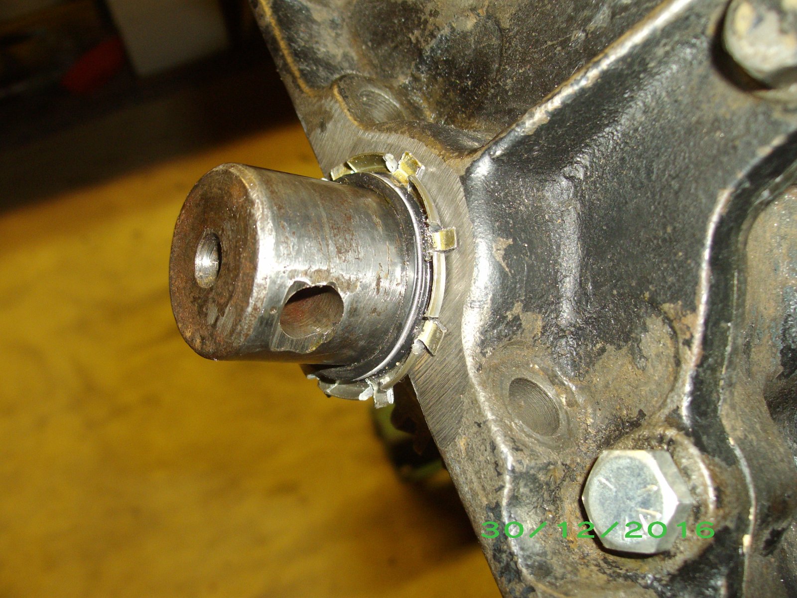

I have good experience with an oil seal , and glue them against the block with J-B weld .

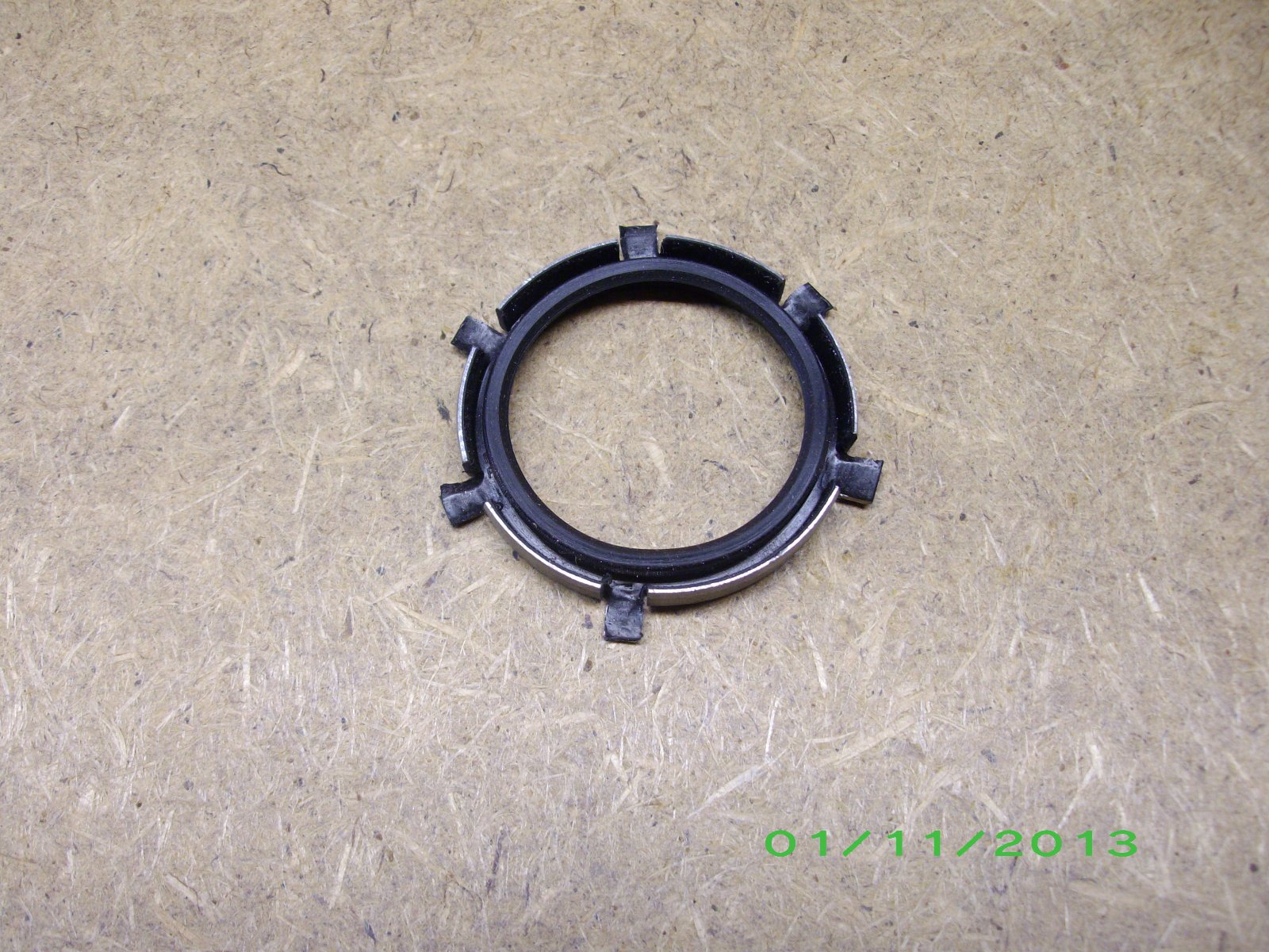

Dennis, If you don't want any leaks at your crankshaft then do as Toon recommended. but DON"T Use JB weld!! Use Ultra Black gasket sealer from Permatex because it will adhere Very well and also is FLEXIBLE. You'll have room for this seal but I bend a few more pedals on that daisy type flow of a seal. Mounted backwards it will still prevent any oil leaks till the next O/H!!

Dennis, you saw the picture that Toon posted. That is how you can install the seal without and problem. Most all T's have enough room to install a thin seal. One is Harwal 30-50-05 oil seal type AO NBR. Here's some part numbers from some seal I've used. Those are the mm sizes for the Harwal seal
CR 12458, will also work

Sorry cam seal is skf 9853 or cr is 9876 Use the Ultra Black to glue it to the block.. Check out the detailed instructions on Google that I've posted

I’ve used Gene’s technique successfully a couple times (although I prefer Right Stuff as the sealant/adhesive).
You might find your seal is a bit too thick and fouls against the crank pulley — I had that issue with one of the reproductive aluminum clamp-on pulleys, easily overcome with a bit of lathe work.

Is there any harm in bending the pieces between the pedals back as well? Looks like I could gain a bit more clearance.
