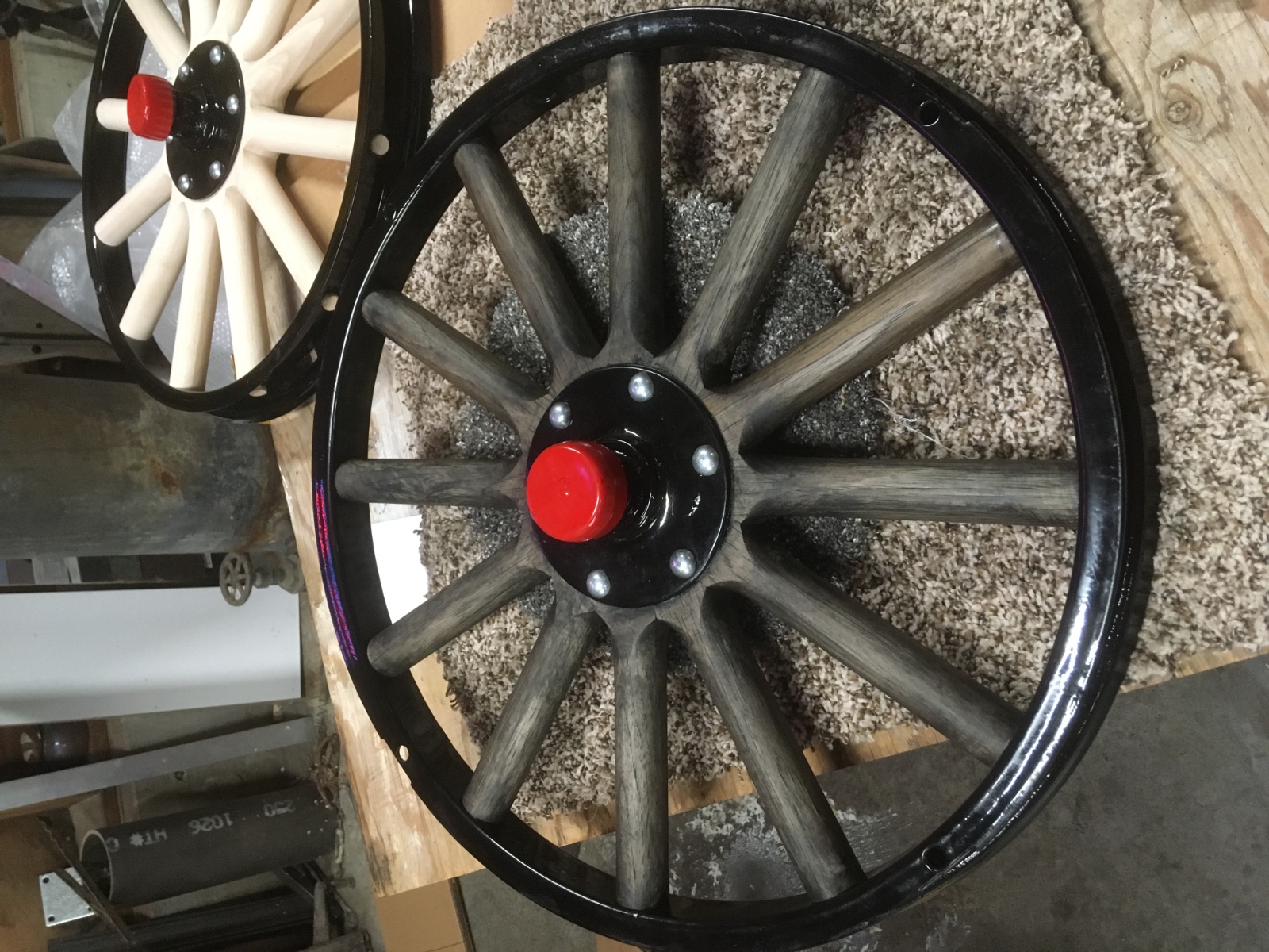

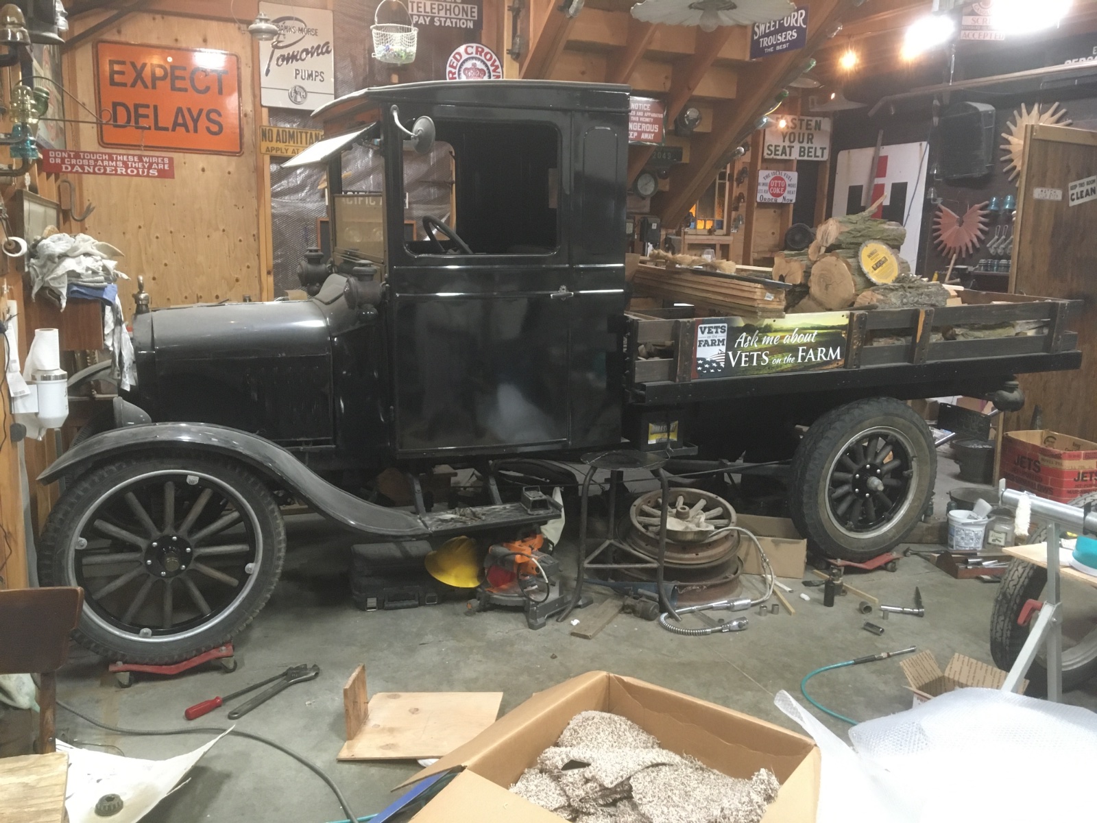

Being that my T is a TT, and I have zero interest in car shows or other
"showing off events", and that I want to present my truck as a well-used
farm/work vehicle, AND the fact that I am a painter and do a lot of exterior
wood/preservation work, I chose to oil stain my wheels with a heavily
blackened stain of linseed oil, thinned with mineral spirits. One pass got
me a nice, dark "graphite" black. A few more will get me to a "weathered
black", to match the overall appearance I want for the truck.
Sealing wood is an impossible proposition, as wood shrinks and swells,
depending on the moisture content. Soaking wood with oil repels water
and cannot crack or chip. It also allows infinite numbers of reapplications,
should they be desired, reapplications that do not require total stripping
and refinishing of the wheels. If you want the dealership-new stock look,
this is not the way to go. If you want a durable, low maintenance, looks-
like-1932 finish, this might be a good answer.
This is what they look like after 1 application:
