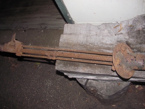

Is this a 1912 steering column?
Post by ModelT46 » Sat Mar 02, 2019 6:17 pm
Off set round holes. not square. a 1913 column up for sale has off set square holes.

Re: Is this a 1912 steering column?
Post by Colin Mavins » Sun Mar 03, 2019 9:54 am
The column in My 1912 is one offset hole and square holes ,and my spare column also has one offset hole and square holes. It is my understanding that the one offset hole would make it a 1912 column, the round holes maybe a different manufacture,or someone over the past 100 years or so has drilled them out. Cheers from frozen Winnipeg.
Post by Original Smith » Sun Mar 03, 2019 10:43 am
How about some better pictures?
