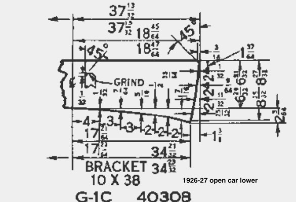

The '26-'27 open car is easy for a good glass shop to cut and install. Tell them the important aspects, that is to have the open edges of the glass ground for smooth radius. The glass is placed with 'bedding tape'. If the installer doesn't know what bedding tape is , try another shop!
Have have many done for me, a good shop does good work
Here are the Ford prints, you can take these along and help them out, but the frame dimensions will provide the guide for the glass cutter.

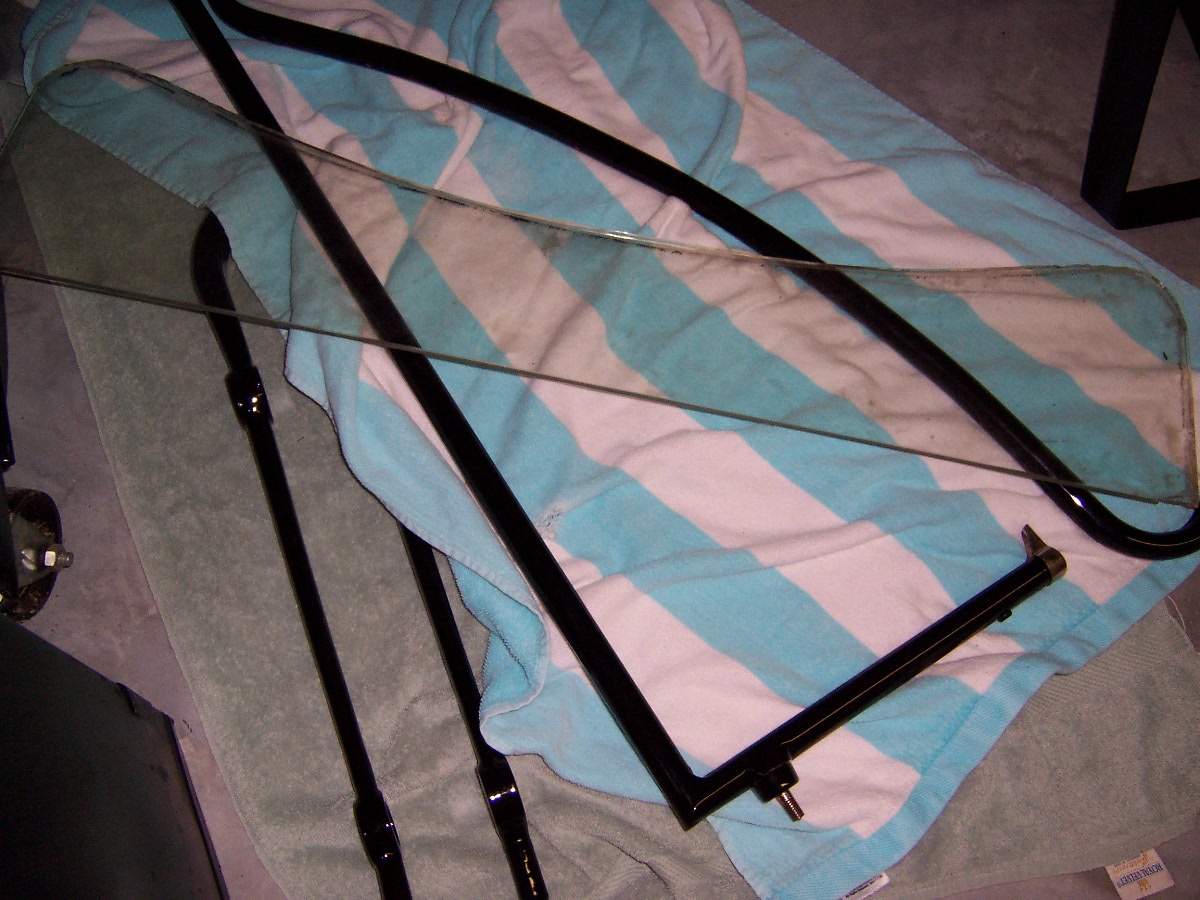

This frame is non-Ford, but had new safety put in both frames, didn't take the old curved lower glass to the shop, but did fit the metal glass top clips so the cutter knew where to trim to. You want to be sure the folding panes clear each other!

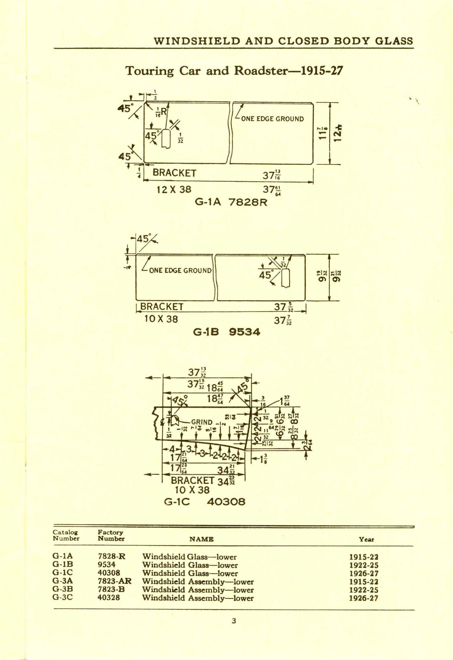

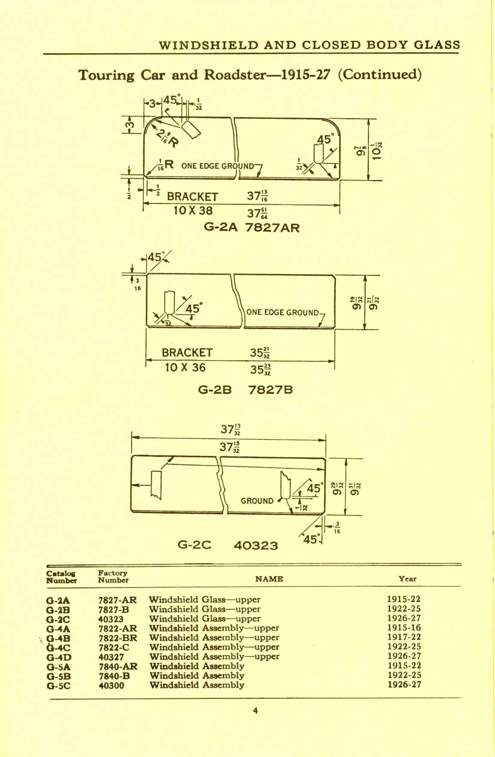

Here are scans from the Ford Windshield and Closed Body Glass booklet covering tourings and roadsters from 1915 through 1927.

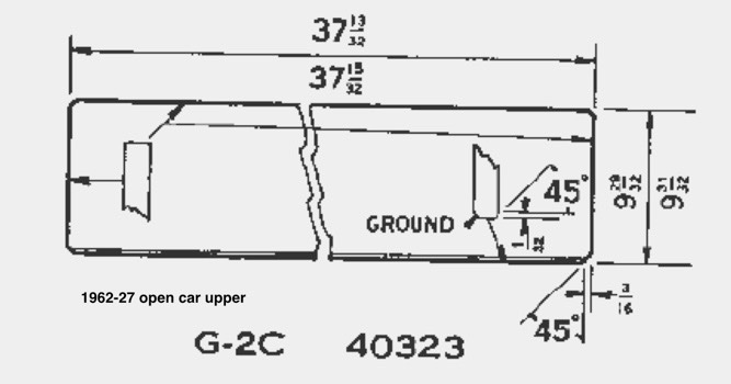

I made these drawings for my '26 Runabout.
I have these in an AutoCAD dwg and dxf formats if anyone wants copies for a CNC job. I can't attach them here. Send me a PM.

I sent you a pm with my email. The cad files will help for sure, I can plot and cut some cardboard templates for mockup.

Danny, I sent the files and I included G-2C upper too.
