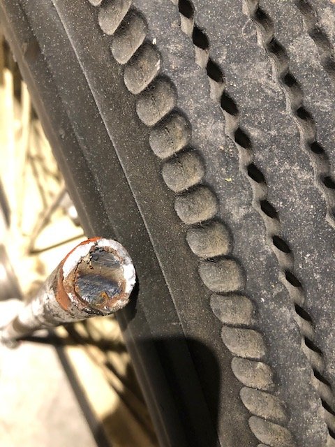

I had never really believed in a guardian angel until the events of this past weekend.
We have an old/new T in the garage, and I was trying to get it ready for the road.
After several attempts of getting her around the block. I was able to take her on a three-mile loop around the neighborhood. Got back to the house and the youngest grandson was itching for a ride. Sure, one more time around the loop would be great for him and the car. We had just made it past the first right turn then the T just died. DEAD. No lights, no starter, nothing. I pushed it back a little bit to a neighbor’s driveway. Then did a hard-right turn. Just like the one that we would have encountered at the next turn. Then SNAP something broke. The steering wheel would just spin, the wheels stayed put. I had the grandson jump and run get his brothers to help push it back in to the garage. I had been working on the electrical system off and on for some time. I was just miffed at the car, or more at myself. After the T was back in its place, I started to determine what happened. The positive lead popped off. I had tightened it. Then just left it and turned my attention to the other T. Later that night, I just started to think about the events and why the T just stopped and what could have broken in the steering. Then it hit me that I am thank full for the cable coming loose and killing the T. Just imaging what would happen if we had taken the corner and the steering had broken in mid turn. It would have not ended well. As it turns out the guardian angle saved our bacon. I still have not figured out the steering issue, that will be one evening this week. Don’t know if the T or my grandson has the angle. My bet is the grandson. He had so many health issues it is a miracle that he is here. God has a plan for him. I hope I am around to see what the plan is.

Wow. I'm glad you guys had that angel with you!
There's not much to the steering system. Whatever broke will show up pretty quick. Start underneath and work your way up.
Could be something hidden under the steering wheel in that gearbox, but I bet it's something down below.
Good luck. God blessed you!

Found the steering issue. Dodged a bullet.
I thought the steering columns were solid.
Now to find a good straight column.

Steve, Looks like it has been cracked for awhile, my guess would be excessive up & down steering column due to a week firewall at the column mounting. By the way I gather you have an early Mustang(s). I have a NY Rusty 6cyl. convertible warranty plate data date July 25th.

I honestly never would have thought that something like that could happen. I'm glad both you and your grandson are safe. This is a good reminder that these cars need to be thoroughly checked out and repaired before any serious driving can be done. I've had some big surprises what was damaged and worn out when restoring my own cars.

Surely the steering column isn’t a piece of tubing! Hopefully at least it was the standard solid
column. But I would never thought a steering column would twist in to like that. The ones I have found in junk yards and farm auctions were used as pry bars, chisels and no telling what but for a break like that I have to say WOW like Norm said!
That copper color sure looks like a piece of hard drawn copper tubing but surely not!

Not a "FORD" steering shaft ! They are solid 3/4" steel - I just cut one to make a pry bar.

Solid shaft? Maybe the early ones by the look of the throttle lever this car has a Vaporizer Carburetor which would make it from a later '26-7. The wood firewall tells me it has a aftermarket body & not as supported as it was when it would have been in the "Original" car with a metal firewall & column support. My guess old "Henry" always looking to save on the vehicle cost had hollow shafts in the late vehicles. George

Looks like a copper tube to me too. Yikes! Wounder what else is lurking out of sight.

Looks like pins holding that gas lever are copper wire too. Better check everything on that car before you go far.

On close inspection I think it was welded together at that point, and the weld has let go. It certainly is not a standard Ford shaft. The weld may ave been filed back into round, thereby further reducing its strength. I believe the copper colour is red primer. Under where the paint is buffed off it shows bare steel. The weld too is broken steel. It looks like the throttle arm is held in place with two cotter pins. All in all, I would be checking everything on that restoration. If that sort of work is done on steering components, I seriously distrust the standard of workmanship.
The angels have served you well.

George H., as frugal as Henry was, he never made hollow steering shafts, which are not columns. A column is what the shafts are enclosed in.
We need more pictures of that shaft, there is something seriously wrong going on here. Clean everything up and take several more pictures. That looks very scary, hope nothing else was repaired that way. JMHO Dave

As an afterthought, I have made most of my living for the past 40+ years as a welder. As experienced as I am, I would never weld two pieces of a steering shaft together on something that would be driven. I have seen many shafts, not just steering shafts, welded together with just a small bevel on each end, and then the weld was ground down to fit whatever, leaving very little "meat" to hold the joint. Several years ago, there were some posts on the old forum about some reproduction early '09 type front axle "yokes" that were made to weld on later axles to convert them to the earlier style. Apparently, the ends of the axle and the ends of the repro "yokes" were just beveld a bit and welded on. Then, a lot of the weld was ground off to look "original", leaving very little "meat" for strength, causing some accidents when the ends broke off. Anything like that should be beveled enough to get at least a 100% weld, anything less is just asking for trouble. As for the steering shaft that has been shown, beveling both ends to get a 100% weld would be much better, but I wouldn't trust it without some close inspection periodically. JMHO. Dave

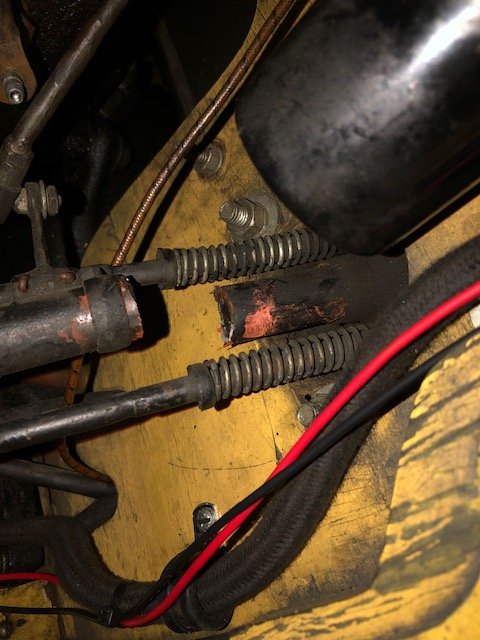

I was able to pull the top half of the steering column out.
It does not look like it's hollow.
Still does not look like one piece of solid steel.

Somebody welded two pieces together... and very poorly. Why do people do stuff like this.......

That is what is seems, perhaps the builder wanted to shorten or lengthen a Ford steering post, and drilled part way into each piece. Placed a steel rod to act as a dowel, then welded up around the joint. Rather risky for a steering post shaft.

Had the 'dowel' been of smaller diameter, had both sides of the shaft been deeply V'ed, had the weld been made deep enough to pick up the dowel too, then that break may not have happened. But, it is still a modified, welded steering component, which should be avoided. That it was done in such a manner raises alarm bells about the way other work may have been done.
