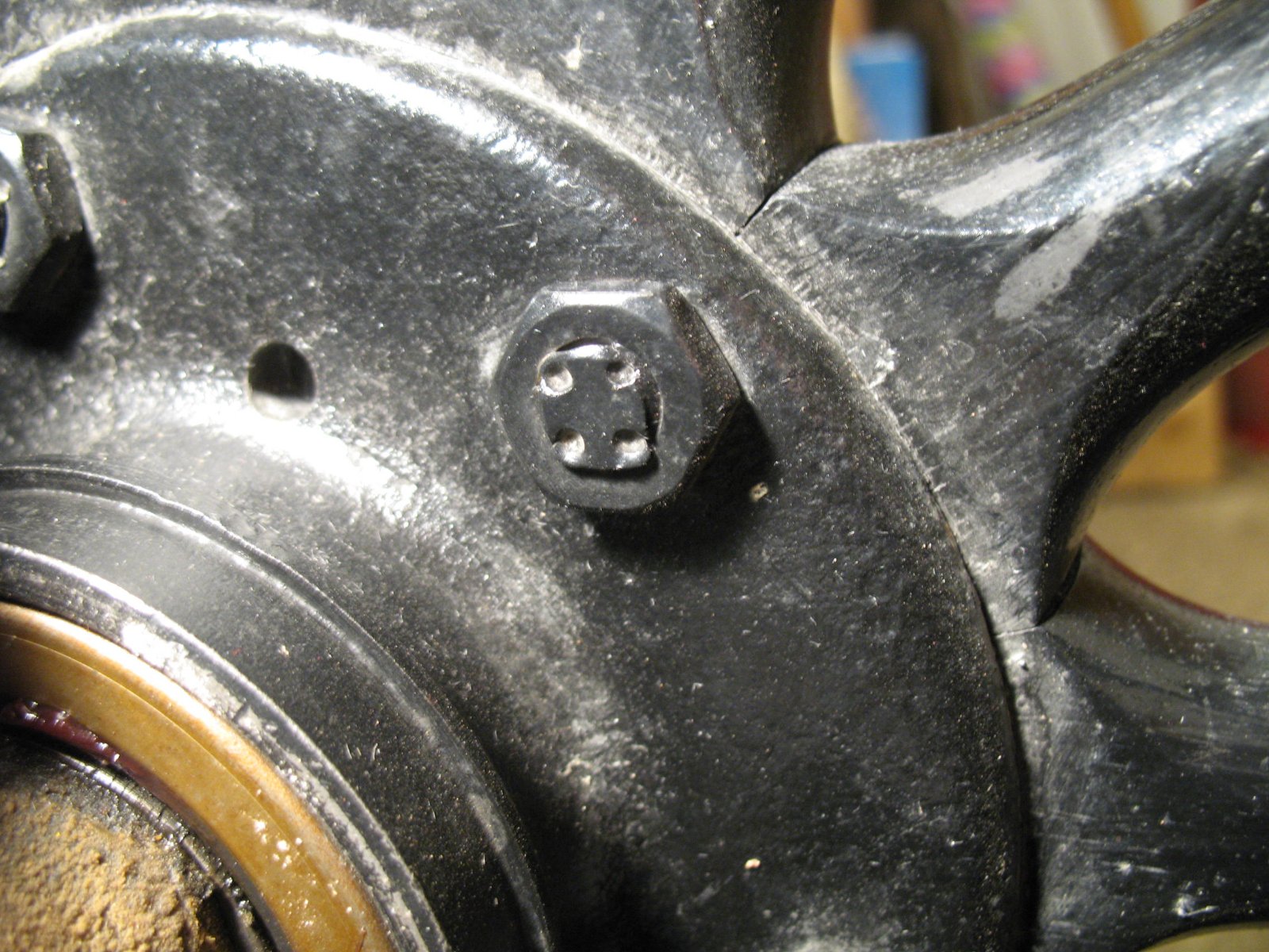

You want R.V. Anderson bolts (also sold by Lang's and Chaffin's). They are superior to those sold by some of the other dealers. They are 21/8" long for rear wheels. For front wheels you can trim a little off. After they're installed they should be peened or staked so the nuts will stay on.
