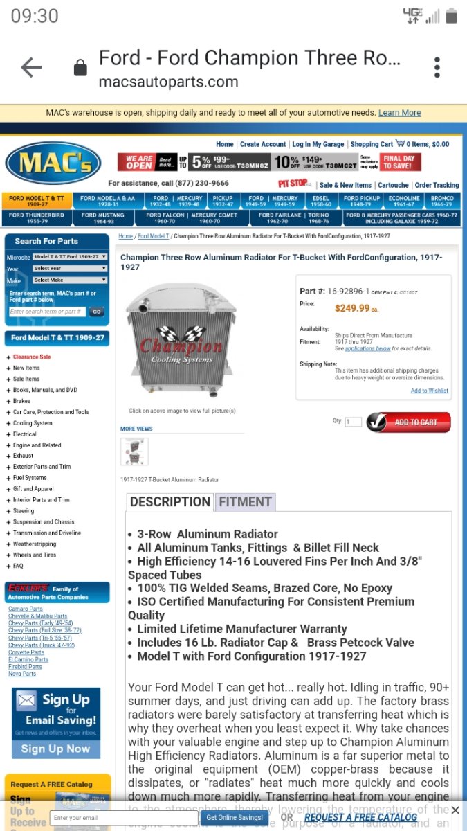

Is this radiator junk? 300 for a radiator???
Jonah D'Avella
Topic author - Posts: 700
- Joined: Mon Jul 27, 2020 8:00 am
- First Name: Jonah
- Last Name: D'Avella
- Location: Kingsport TN
This radiator is very inexpensive compared to the other radiators. Is worth buying?

They are made for street rods, ie, V8 T’s. Some have modified them to fit an original T.

That is a street rod radiator for T buckets ECT. It will not work for a stock T without modification

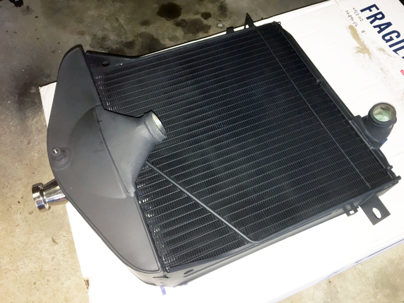

I agree with Rich. I would fix up an old radiator or buy a Brassworks one before I'd try an aluminum one. I have done both several times. However if they cooled twice as well I might give it some thought.

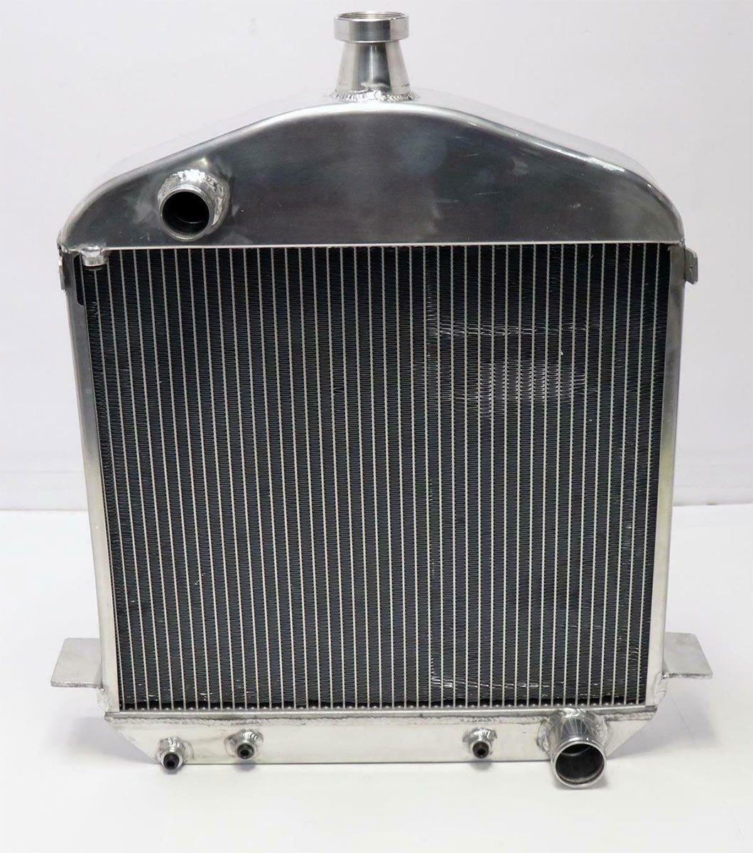

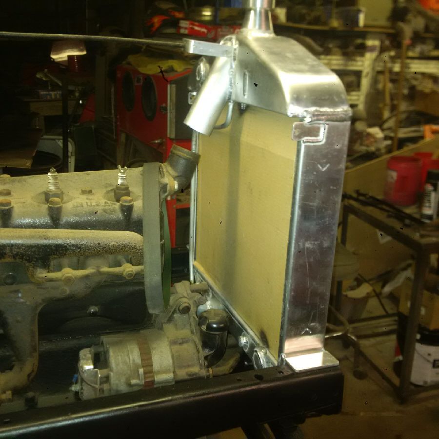

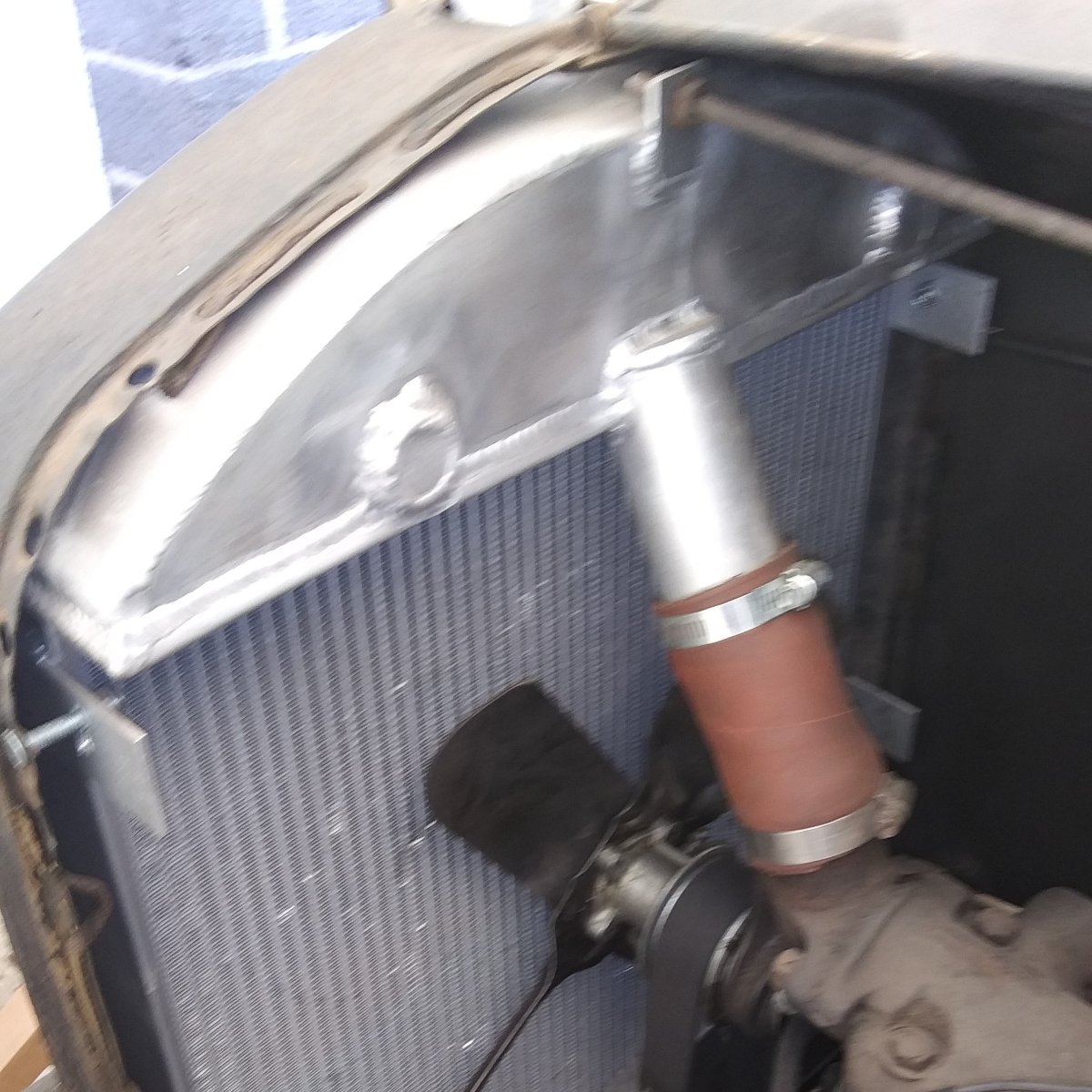

I get we all like to joke and have fun, but I feel that deters some to the original posters asking the question. Might even turn them sour on the forum with all the smart ass answers. Just saying, take it for what its worth all you complaining no new people want to join in this hobby.
Now that I have your attention, as Hank has mentioned, they can be made to work. I bought one ($140 Ebay), I have a TIG welder and could do aluminum welding, I gave the idea up when I found a used decent copper/brass original aftermarket for less than what I paid for the aluminum one (It was a good score).
So here is the skinny, being not all was explained.
--They only fit the high style grill style (after mods)
--The tank top needs to be modified so it is more roof shaped rather than dome shaped---to fit the rad shell correctly.
--The mounts are in the wrong spot and need to be cut off and refabricated and welded back on
--The bottom tank is too large, need to remove internal trans cooler and shorten the height of the tank to clear the frame crossmember and engine mount.
--Hood rod support needs to get fabricated and welded on
--If it doesn't have one, you can buy the radiator fill separately and weld it on (probably best in case they weld it in the wrong spot)
--The lower hose mount could potentially be usable as is, but then you need a curved radiator hose to line it up.
--The top hose mount you could also probably cobble together with different radiator curve hoses OR cut the port off and reweld in the center with the proper angle.
If you have to pay someone to do this, just go buy a Bergs and be happy that it cools and functions AND Bolts right on as stock would.
If you have a friend that wouldn't charge you time (because there would be alot of it) or if you can weld aluminum yourself, it might cost you $50 -$100 extra in materials and welding gas, but would be a fun do it yourself project.
Last edited by Chad_Marcheese on Tue Sep 22, 2020 7:50 pm, edited 2 times in total.

Dennis, I wasn't saying you were wrong in any way, you were correct in your post. I am sorry if you took that as me saying you were.
Being I have one in hand, I looked hard and long at it and the list I came up with was pretty comprehensive.

John, you are exactly correct. I first wondered why the stock rad shell wouldn't fit. As it turns out, these are meant for obviously T-bucket guys, but are designed so no shell is needed, and you can just paint it black, or the upper tank and side panels to match whatever color the body is. I've since seen these on T-buckets with a Ford emblem stuck to the upper tank.John kuehn wrote: ↑Tue Sep 22, 2020 7:58 pmGood post Chad on the modifications that need to be done for the aluminum radiator to fit.
It sounds like you could have a new core put in an original radiator if you paid someone to modify and buy an aluminum one. Some have the skills to do it and others not so much so that would be an issue for some. And as I said in my earlier post the marketing description needs to be more clearer about fit up. There is a lesson here. Just because an add says for a Model T it’s not always quite like it seems.
Thanks for the post.
But even if I was building a T bucket, to me it still has the wrong looks for use with no shell. And most realistic people will sell you a real T shell reasonably. This aluminum rad in a T bucket application, I would just lengthen the sides of the stock high shell until it fit the radiator...because obviously no hood would be in use.

Like Chad, I bought one of the aluminum radiators with intentions of modifying it to work on my speedster. I was up for the challenge since this question seems to come up from time to time and I wanted to see if I could make it work.
A few months ago I found a good deal on a new Brassworks radiator so my motivation to modify the aluminum one as ended.
Just like Chad and Hank said, it can be modified to fit a T with some work. If you are able to weld aluminum or know someone who can, you could have yourself a nice radiator at a reasonable price.

i bought a new one off ebay and have $135.00 in it now. i have used it for 3 years. the temperature drop from top to bottom is about 60 degrees. this is temporary until i find a good used one. i did not modify my car only the radiator

Thanks for posting Charlie, That is the same way I was modifying them.

I purchased one off eBay that is setup for late model Ford (I believe). The radiator outlet is in the correct location. I fabricated an "S" to line up the engine outlet with the radiator inlet. The fittings on the radiator is smaller in diameter than the "T"
Several modifications needed but very do-able by garage mechanic/engineer.
