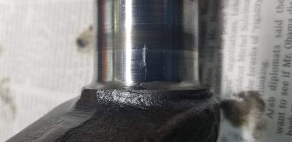

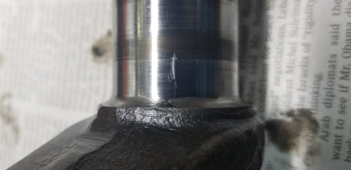

Dare we analyze my cracked crankshaft?? I say we do.. but INTELLIGENTLY
I pulled the engine out of my 1925 Coupe. It had a few things wrong with it so I decided to take it out. First thing I did is have the crankshaft magnafluxed as always. In the attached photo, you will see a photograph of a 1/4 inch long crack in the #4 rod journal. I am considering putting it back in the car. Here are my reasons why. Please keep your rebuttals polite and thought-provoking. Making a blanket statement of "ITS CRACKED, REPLACE IT..." does nothing for good dialogue.
Here's why:
1, From the looks of the crack, and the fact that I can feel it with my fingernail tells me it's been there for years. The edge of the crack is rounded, speaking to years of use, polishing the sharp edge away to a rounded bevel.
2, The crack runs axially... along the length of the journal. If it ran diametrically, I would replace it without another thought. But this crack is not cutting the journal in two.
3, It's in the downward stroke side.... meaning it's in the crux of the crank, so when the piston fires, and pushes down hard on the journal, the crack is being forced closed... not open. I doubt this scenario promotes rapid crack growth.
In the end, I may choose to replace it. But a crack this small, running in this direction doesn't make my alarm bells go off. Forget that we live in a world of Scat cranks. If you only had this one to use, lets figure out what everyone thinks the probability of failure is?
And GO....
Here's why:
And GO....

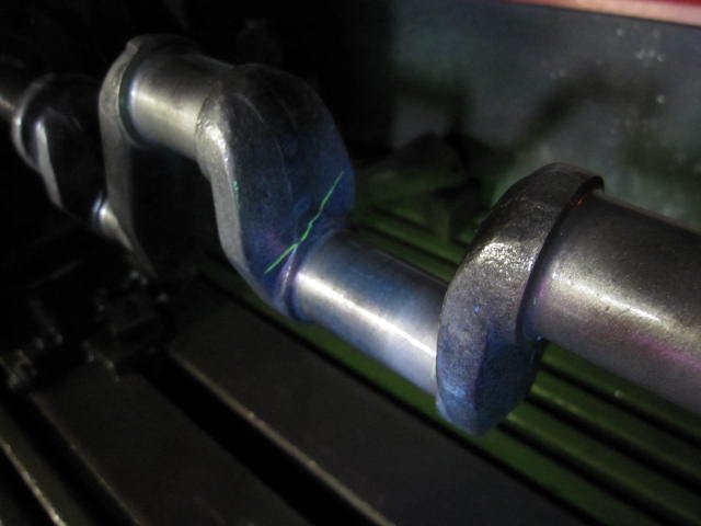

Could just be a deep gouge. I would have it magnafluxed to check. On my own car if it passes that test I would use it, customers car no.

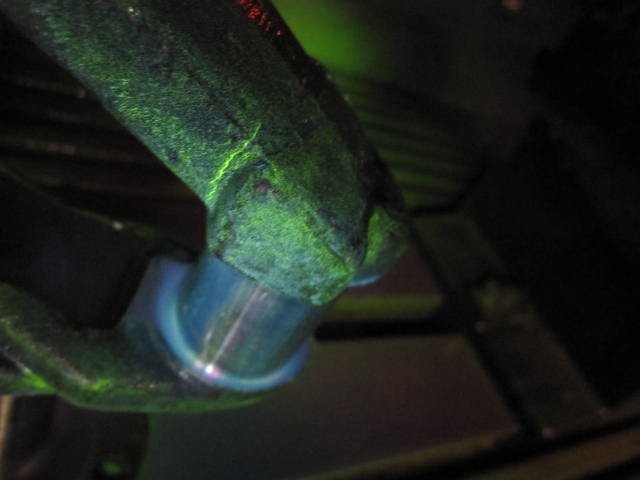

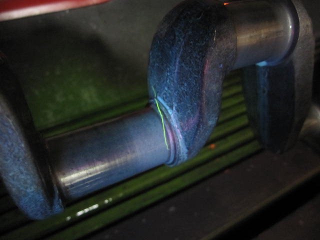

You didn't say "Wet magnaflux" as if it was done dry it only gives a one dimensional image whereas the Wet mag will give all three.

James, in your original post you said, "First thing I did is have the crankshaft magnafluxed as always."
Have you actually magnafluxed this particular crank in the past ? Was this same flaw seen previously ? If yes, then the only question you need to consider is whether it has grown since the last time you looked at it. If you have looked at the crank before and this is the first time you have seen the flaw, then I'd be worried.
The other possibility is that this is the first time you have ever inspected the crank and you have no idea if the flaw is a long time feature. Then we're not much smarter other than your observation of the wear evidence along the edges of the flaw.

I have seen forging lines run across two throws of a crank, they look like cracks on a wet mag machine but they are rolled pieces of steel in the forging, this could be one of those? not saying it is but possible?

I say it's a forging flaw and not a crack. "Crack" suggests something that was not always there, but has developed over time, use, stress, etc. I would propose that what you're seeing has been there since day one.
