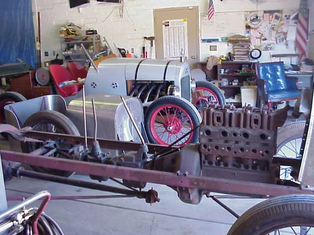

I'm still working on my "DODO" speedster........

AandTman wrote:
Sat Sep 26, 2020 7:16 pm
You need a rucksell...

Looks like it has a ruckstell shifter??

FordFool wrote:
Sat Sep 26, 2020 9:24 pm
Its two transmissions behind the T.

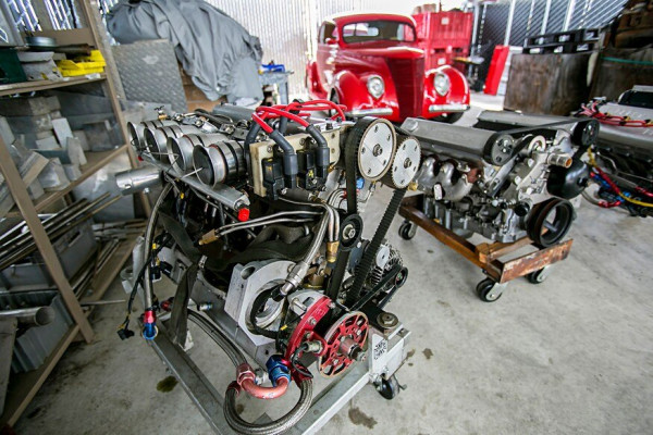

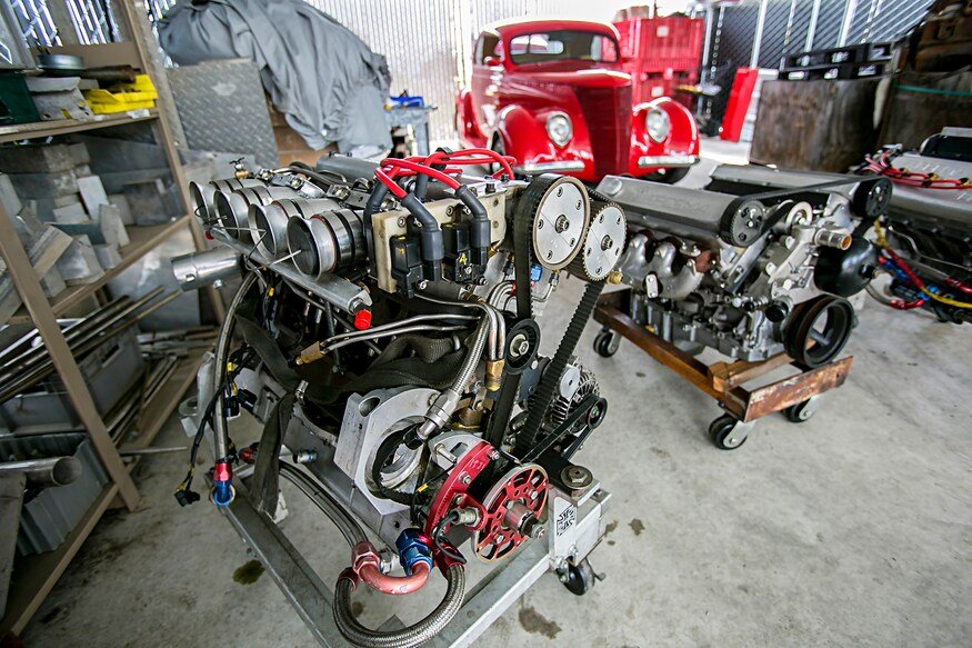

Here is the Aardema 4 cylinder running the subaru heads so it can be done... he reports 200hp naturally aspirated which says there are gains.. again this is discussion, but someone might decide to do this. These types of discussions have always been in the hobby because people like to go fast.

VERY cool... I had no idea that it could even be done... where can I find out more about this?
I'm assuming that at 200 ponies he's done some other significant work to this motor, but again, I want to know what? All that power is pretty awesome, but if it's main effect is to grenade a T motor then it's kind of moot point (unless I was building the ultimate T powered dragstrip sleeper)...

There is no doubt that this motor makes the list of extremely modified T engines... but I’m afraid they passed the $4500 mark loooooooong ago😉
I think the underlying question is whether the “other” cylinder head could be adapted without all the Bonneville modifications... at some level yes. But where does your $4500 run out...? You’ll have to tell us when yur done👍

Post by pete eastwood » Sun Sep 27, 2020 9:43 pm
Many years ago , Pete Smiley applied DOHC Westlake cylinder head technology to a model T block .
When the engine was finished , it looked like an Offenhouser , it was a work of art .
He did one dyno pull & made 300 hp , normally asperated ! Then he stuck it under his bench .
When he died it was sold on e-bay , and I believe the Speedway Museum in Nebraska has it .
I wish I could find the picture I had of it

T4Tom
Posts: 71
Joined: Sun Jan 06, 2019 11:26 am
Last Name: Magee
* REQUIRED* Type and Year of Model Ts owned: 1924 Speedster
Location: San Jose CA
Re: OHV, OHC, DOHC Heads
Post by T4Tom » Fri Oct 09, 2020 4:13 pm
Check out the Northwest Vintage Speedster website's Technical Page. They uploaded a bunch of MTFCA articles on speedsters, endurance runs and hill climbs. Major drool factor here: https://www.nwvs.org/Technical/MTFCA/MT ... cles.shtml
Here is screen shot from one of the MTFCA articles on NWVS showing the Gemsa DOHC engine in LaRue Thomas's roadster at Long Beach.
Tom

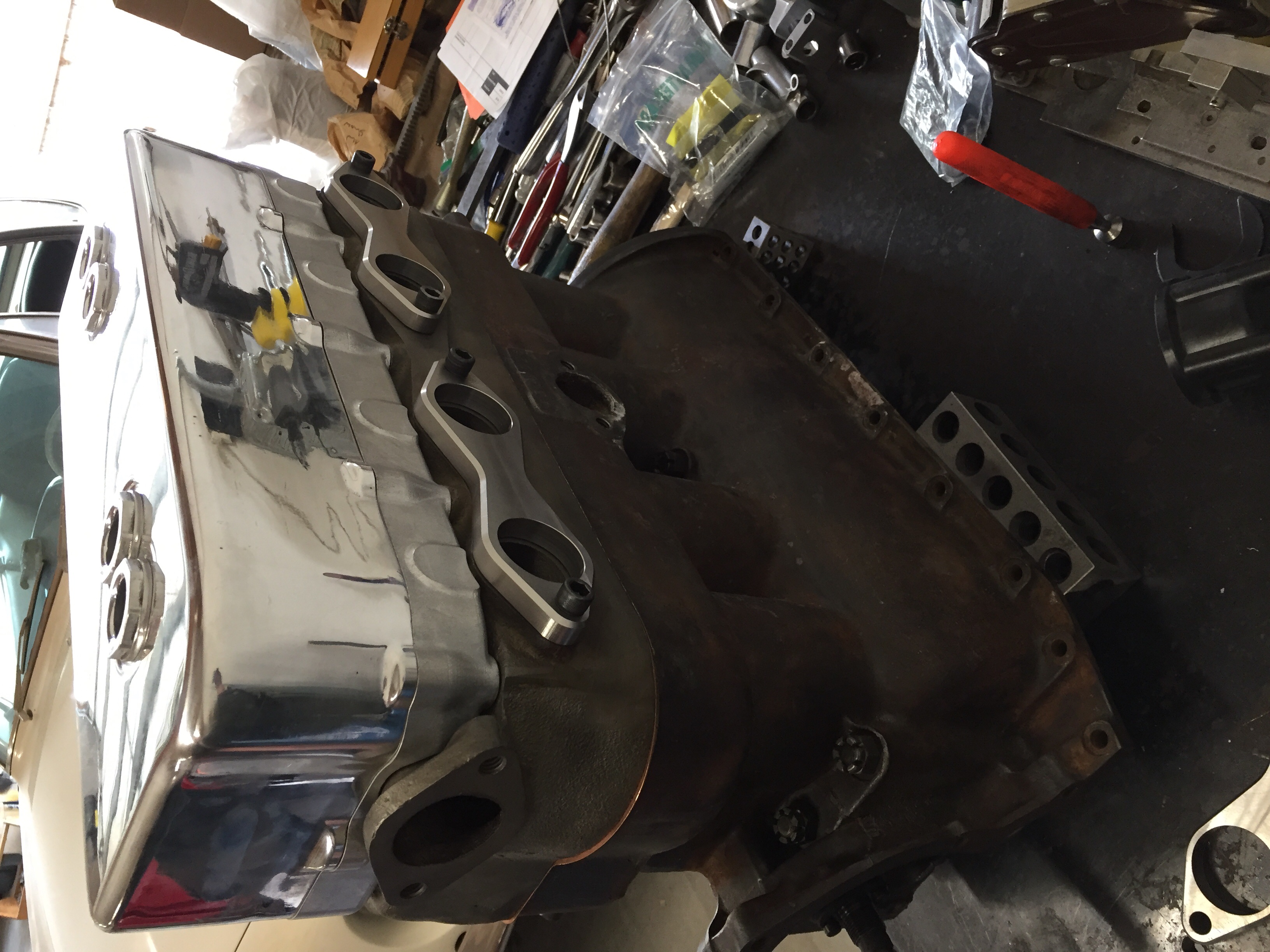

Mike Penserini
Posts: 64
Joined: Mon Jan 14, 2019 1:53 am
Last Name: Penserini
* REQUIRED* Type and Year of Model Ts owned: 27 roadster pickup, brass speedster, Mercury # 253 B, Mercury # 1070, Faultless "Hoosier" parts collection.
Location: Sacramento
Post by Mike Penserini » Fri Oct 09, 2020 11:22 pm
I have a fondness for flatheads. Here is Jerry Sherman's.
fullsizeoutput_1c7.tiff
fullsizeoutput_1c7.tiff (1.34 MiB) Viewed 14154 times
Kevin Pharis
Posts: 1656
First Name: Kevin
Last Name: Pharis
Location: Sacramento CA
Post by Kevin Pharis » Sat Oct 10, 2020 12:17 am
Well today’s your lucky day Mike...! I happen to have a real nice Sherman head... and I’d be happy to trade you straight across for... say a SOHC Fronty...? 😉

Erik Barrett
Posts: 542
First Name: Erik
Last Name: Barrett
Location: Auburn, Ca.
Post by Erik Barrett » Thu Oct 22, 2020 2:39 pm
The Sherman car is the fastest flathead ever to run Signal Hill. We have worked on it here. My friend owns the Thomas car pictured minus the engine. The next year that engine in a lighter car set the all time record on the hill. The car still exists, we have seen it. It has not run since that day. The only Gallivan/Rajo/Gemsa D.O. we have seen with a timing belt instead of gears.
