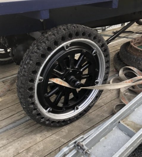

It has been my unsubstantiated belief that early stock TT's were equipped with "solid" rubber tires. Pneumatic tires were, I believe, an upgrade which later became stock equipment. Over the years most of these trucks were equipped with wheels and tires suited to the users needs and pocketbook. What you see is what you get.
My '18 TT has 650 - 20's on the rear and 450 - 21's on the front, which is what what was on it when acquired by my grandfather in 1946. . Interestingly, tucked up under the bed on top of the rear chassis cross member was a 30 X 3 1/2 spare, which fit none of the wheels on the truck. I accept that as evidence that none of the wheels on it are original. It probably originally had 32 X 4 1/2's on the rear and 30 X 3 1/2's on the front when new, but who knows? It also could have been originally equipped with solid rubber tires.
I think Steve is right. Finding matching treads in the two sizes is going to be difficult or impossible.
