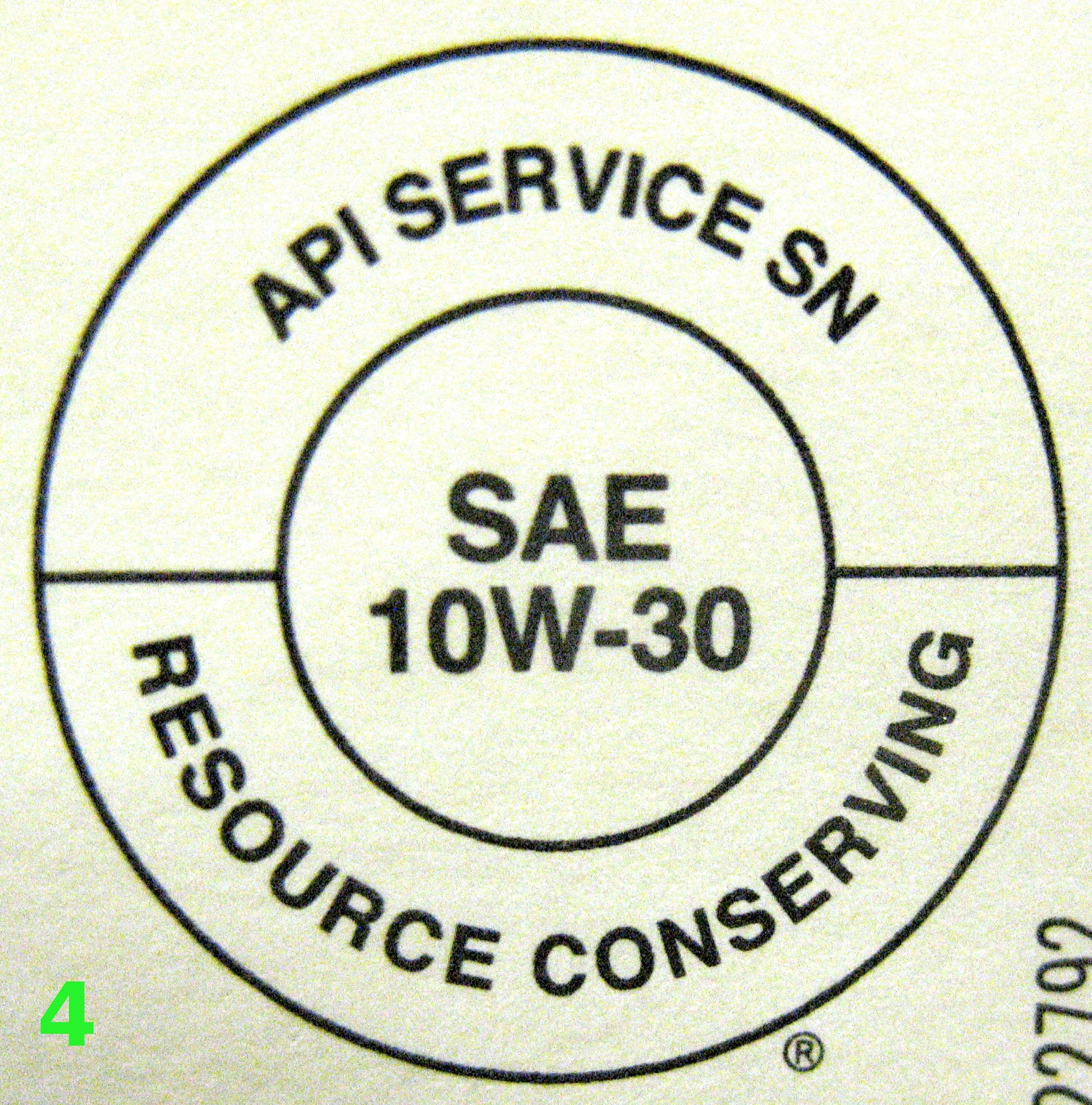

I responded to a similar question in a recent thread and rather than point to it I'll modify it for this context.
There are a lot of responses/preferences/successes based on oil viscosity and detergent versus non-detergent motor oil. Viscosity choice should be based on the climate/season that the car is to be driven in. Multi-grade oils are a good choice for temperature ranges while a mono-grade would be better where the temperature range varies very little. Based on the amount of use of my car (low mileage); climate (all 4 seasons) the most practical choice is multi-grade.
Non-detergent oils were intended for engines without oil filters. They cause the contaminated oil to stick to the engine walls and valleys to prevent the dirty oil form damaging bearings etc.. Detergent oils contain additives to keep the contaminates in suspension so the can be filtered out through an oil filter. There are many arguments for using one or the other - either way you need to first drop the inspection pan in the engine and remove and slug build-up before you add your choice. Because the engine has no oil filter it is necessary to regularly check your oil for cleanliness, and change or drop the inspection pan as required.
Lastly as is often mentioned in discussions about engine oil - if you use (or have) a magneto you should never use an oil containing graphite (most do not)
In my response to the other discussion there was specification JASO MA/MA2 for Motorcycles using the same oil for lubricating the engine and the wet clutch. Interesting spec! https://www.oilspecifications.org/artic ... ASO_MB.php

Re: What oil do I use in my T? 5w? 60w?
Are you referring to the type of oil, brand, viscosity, synthetic? I am leaning heavily towards Motorcycle oil so far because of the wet clutch references and some previous discussions where grabbing/chattering when changing gears were discussed. No idea on the effect for those using Kevlar bands. As far as viscosity gores - the benefit of a lower viscosity oil is two fold, easier starting in cold weather but also because its thinner at starting temperature it is likely to spread itself more quickly. Higher viscosity is better for lubrication. This would infer that a multi-grade might be a good choice (for some). Some new car manufacturers are recommending fir cars with high performance engines 0w20 grade oil -image the low viscosity is to lube quickly in any temperature and no doubt it thickens quickly. Since the T has no oil filter checking the cleanliness of the oil is a necessity and since it has no real shelf life (over 5 years) it should be changed when needed. Dropping the inspection pan for sludge buildup is something that should be done whether using detergent or non-detergent oil needs to be done. What's found the each time will set the schedule for the next inspection.
Synthetic vs non-synthetic and brand - If one chooses to use a particular Viscosity and API service, car or motorcycle etc - then the cheapest oil meeting that specification should be the choice. Current ratings for the "best" oil are based on (high) mileage between changes that retain their specs. The best are good for 7,500 -10,000 miles between changes
