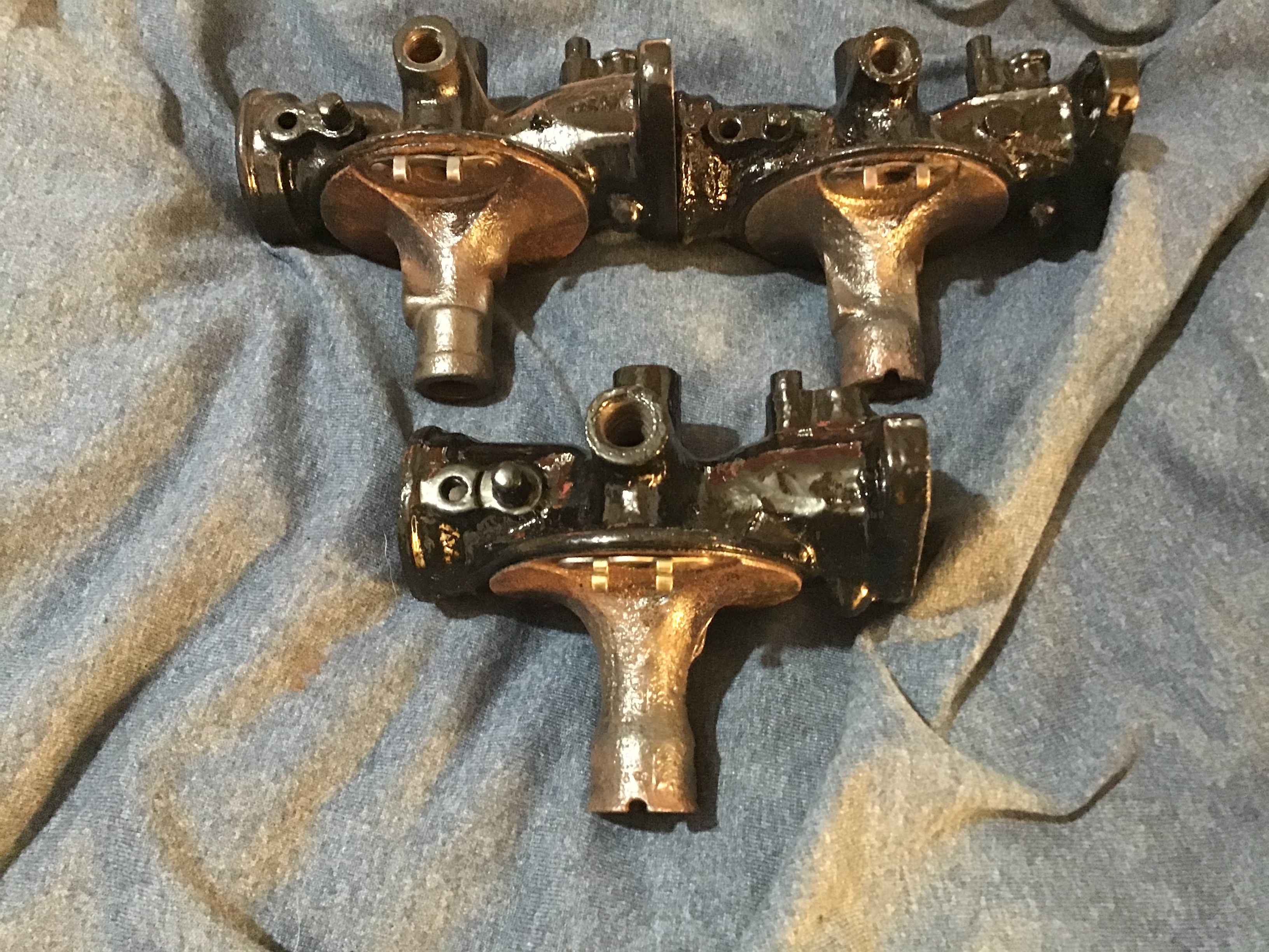

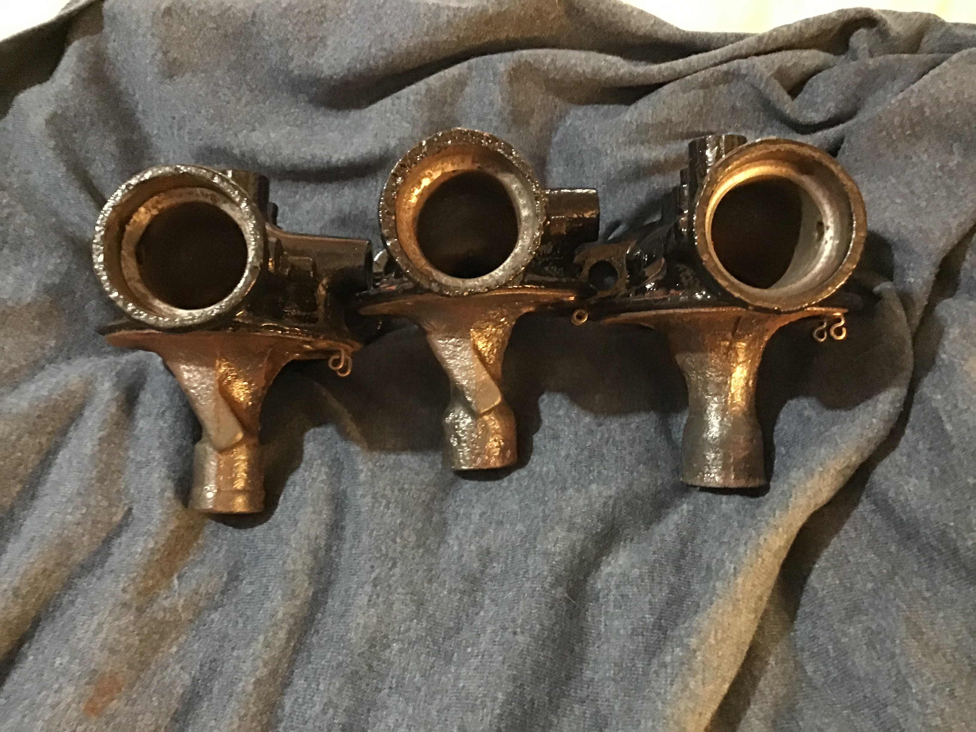

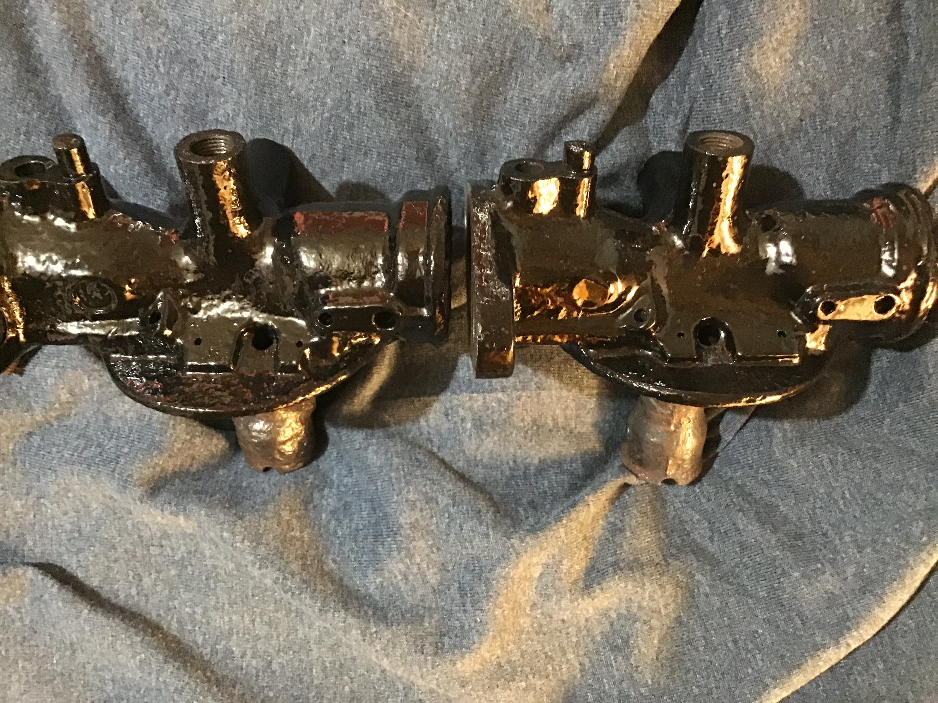

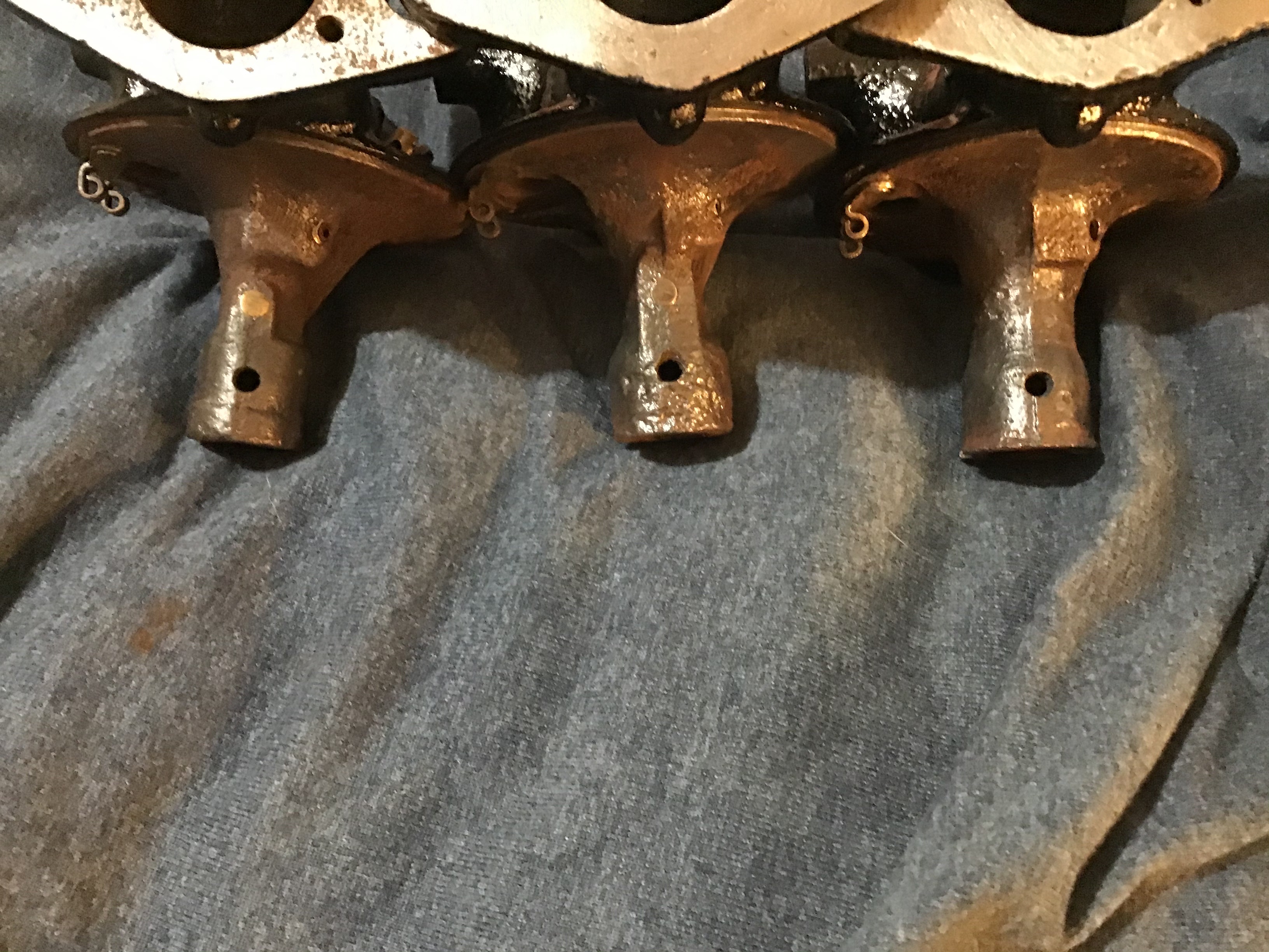

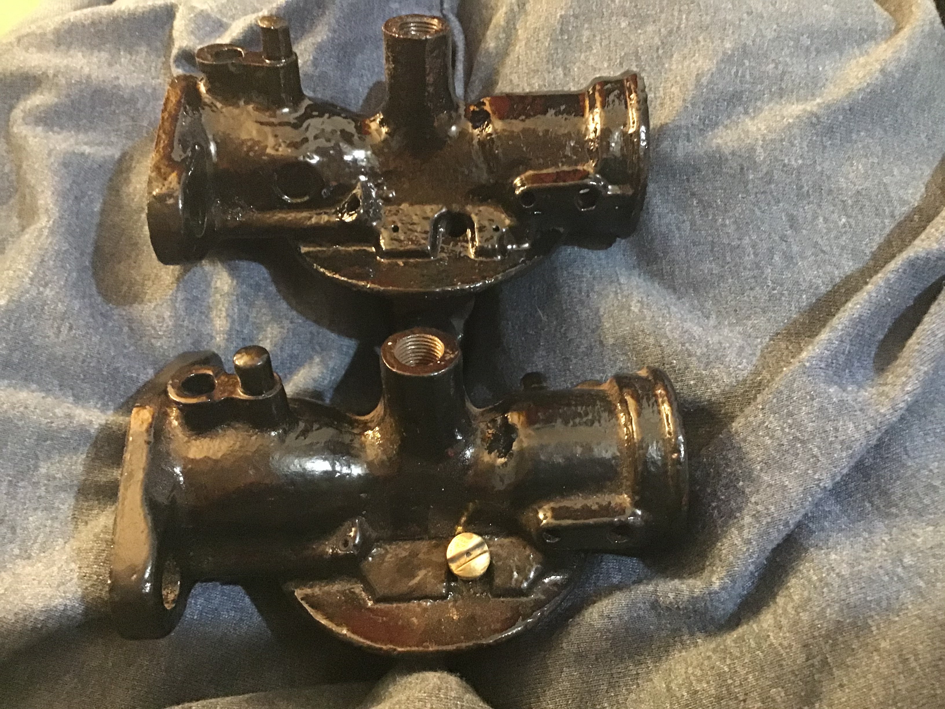

The offset drain NH’s came with long arms. Some of the earlier center drains came with long arms. The casting for the side drain NH’s was different, having the air bleed/vent hole to the side requiring an extra passage to be drilled and plugged. The casting was modified when the center drain came out with a couple slots in the bottom to allow all the gas to drain out from the center but the long arms remained. Later this casting was simplified further, the air bleed hole being drilled straight down into the mixing chamber without the cross drilled hole and plug, eliminating a few steps in the manufacturing process. This change and the shorter arms came at about the same time with some overlap of the long arms. Some of the first swaybacks lacked the name tag and had the brass vent like the early straight through models and some of the straight through’s lacked this and used the familiar ID plate that said “Holley” but were backwards like Kingston ID tags. The early straight through used cast arms carried over from the G, the short arms were modified with offsets later on when the new swivel top mixture adjuster was introduced and also the brass staple for the throttle and choke plates was discontinued and the plates were held in place by upsets punched into the plares. These in 1926 also came with a slightly taller float to compensate for the increased fuel pressure from the cowl mounted tank. The vaporizers used this float as well.
