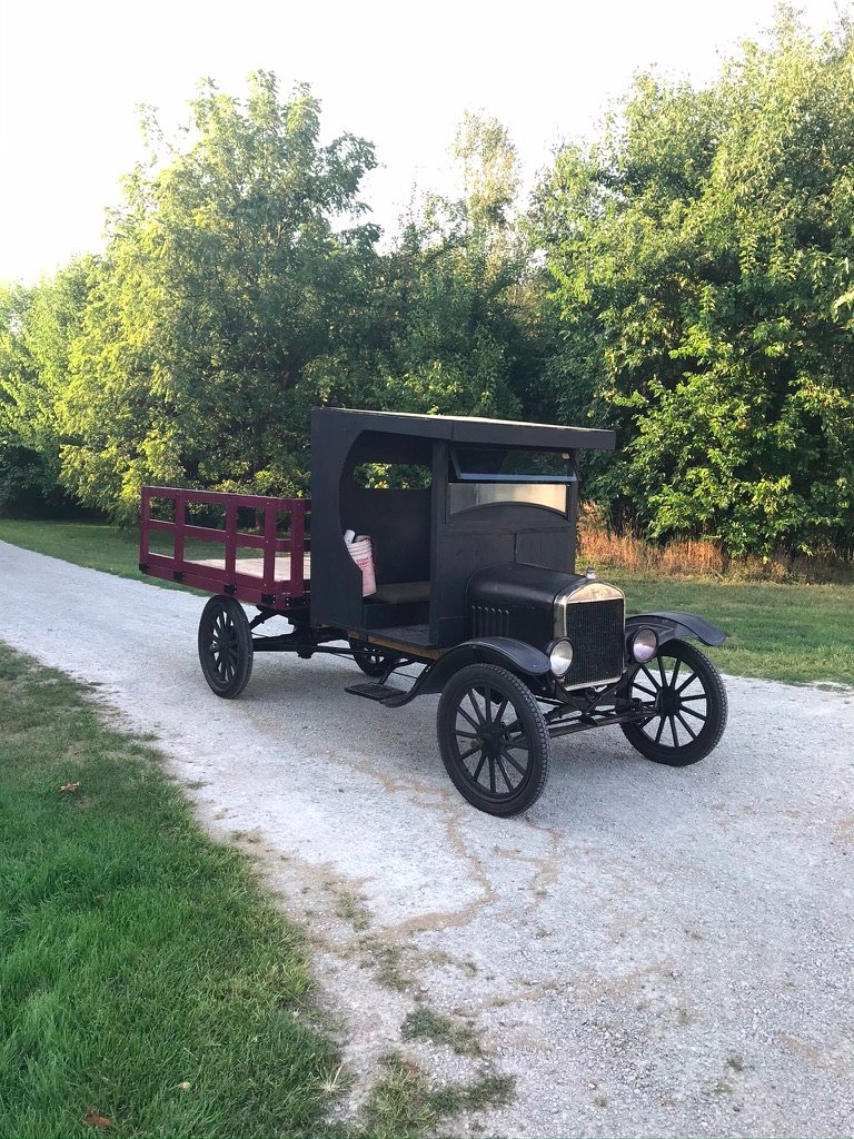

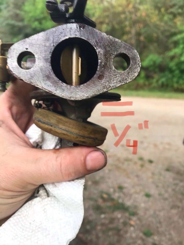

My TT is killing me. It runs great once it's started but getting it started it the problem. I've got 40,45,45,45 dry compression, 45,47,47,47 wet compression. I've got a Truefire ignition and it is timed right, before it was waaay advanced, but it started easier with more timing. I've got a new fuel filter (yes I know) as the old one was full of a fine talc / sand. I pulled the carb off and found that the float was way out of adjustment, 5/8" of an inch or so vs the 1/4" it should be (it's now fixed). It runs well with about 3/4 of a turn of the enrichment rod. It will do 23 MPH easy once started at about 3/4 throttle.
Today, I pull started it with my pickup and once started it ran great. Hand cranking not so much. It doesn't have an electric starter.
I've tried starting with various amount of choke, various amount of enrichment and all I'm doing is giving my shoulder a workout. I occasionally get a backfire through the carb which I think is due to the extra spark of the Truefire.
Maybe I need to rebuild the carb? It huffs when crank starting and raw gas will puff out of the carb in various places.
Thoughts?
Thoughts?

Re: Hard starting TT, ugh....
Hope you are not using ethanol gas - if so drain and switch to ethanol free - available at a Marina as last resort.
You running a Kingston L-4? Never hurts to rebuild the carburetor, if for no other reason than to eliminate one problem area, but it sounds to me that there is something definitely wrong if your carb is puffing out vapor all around it (an L-4 doesn't have that many places to "puff" from).
And I'm not sure why some folks think that ethanol isn't good enough for a Model T engine to run on, mine runs fine with it, never had any problems with it. Hell the bloody thing was designed to run on anything with alcohol in it, include booze (a tad expensive that is), the damned thing will even run on Kerosene for that matter, so ethanol gas isn't really a problem.
But if won't start at where you've got your spark set, maybe you should try it a bit more advanced and see what happens. Glen Chaffin has a car that won't start with the spark lever all the way up also. He pulls if down about 4 clicks and that were it will start. Lets see you're using a True Fire, does that little magnetic pickup where the timer should be have both magnets in it (they're set 180º apart, the second one is suppose to keep it from double sparking, but I suppose it would also help it start easier also). But then I run Coils/Timer, not one of these new fangled gagets, but George Clipner does, he might know more of what could be your problem.
But this sounds to me like your fuel isn't vaporizing by the time it hits the combustion chamber, soooo, you've either got a carb problem or ignition problem which could also be spark plugs...have you pulled any of them to see their condition? Are they gaped for .030? or .032? Try .030, short spark quick response.
Always check the easy stuff first, because that's almost always where the problem is to begin with.
Scott, I replied to your PM. My Betsy runs a Kingston L4 carb and a Truefire ignition.
Mine starts fine with the timing lever fully up. My timing is set so that the #1 spark plug fires when the lever is fully up and the #1 piston is 1/8 inch down the bore after top dead center on the firing stroke (this works out to about 15 degrees ATDC). I had to make a longer than stock timing rod to achieve this while allowing clearance between the timing rod and all of the timer terminals over the full travel (see sketch).
If the temperature in the garage is above 60 deg F, I don't have to richen the mixture for starting. Below 60 deg F, I turn the mixture 1/8 turn rich for starting, then back to the normal running position a few seconds the engine has started. If I leave the mixture on 1/8 turn rich, the engine starts to labor from the rich mixture after 30 seconds or so.
If I am using the crank, I always give the crank a couple of pulls with the ignition off and the choke full on. Then I release the choke and turn on the ignition with the timing lever fully up. Occasionally I will get a free start, but usually I get a light puff of a backfire through the carb. The engine then starts on one pull of the crank. If I don't get a free start or a puff, it means Betsy is in a bad mood and I have crank more.
It's a NH carb. I'm running regular pump gas.
So the plan is, my neighbor guy has a TT with a good running carb. I'm going to stick his carb on my truck and see if there is a change. That will rule out a jankey carb. I kind of hope that is what it is.

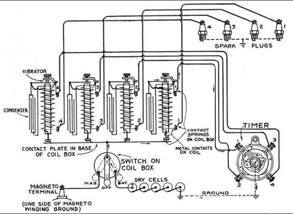

Now that you are talking about getting a larger 12V lead/acid battery, hooking up your one wire 12V alternator, and adding wiring to your TT, here are some diagrams that may be of help. Starter equipped Ts and TTs came from Ford with 6V NEGATIVE ground electrical systems.
The first diagram is for a non-starter car (no starter, battery, or generator). The dry cells shown in the diagram were not supplied by Ford, but could be added by the user. They were the old, large 1.5V telephone batteries.
The second diagram is for a later starter car (starter, 6V battery, 6V generator, negative ground). It includes a firewall terminal block, an ignition switch, and an ammeter. The vendors sell a small bracket to hold the ignition switch and ammeter:
https://www.modeltford.com/item/INST-PAN.aspx

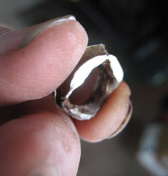

I used some permetex...
I hope it wasn't the original stuff.
I found that a few years of hot coolant turned it hard, brittle, and leaky. After that I used Permatex Ultra Black. So far it has been OK.

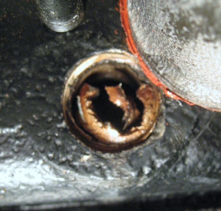

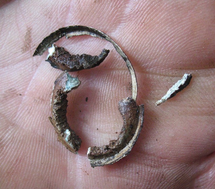

The old freeze plugs were some leaky brass ones put in by the previous owner.
It's worth noting that my neighbor guys truck had a pin hole leak in the middle freeze plug that would shoot water out about 3 feet due to his water pump. He pulled them out yesterday and they were steel and if they weren't leaking at the time, they would have in a short time.
