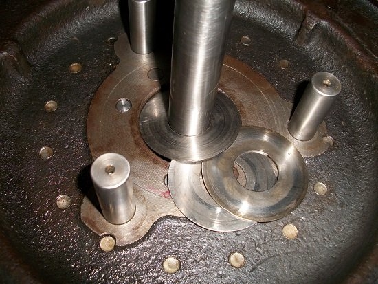

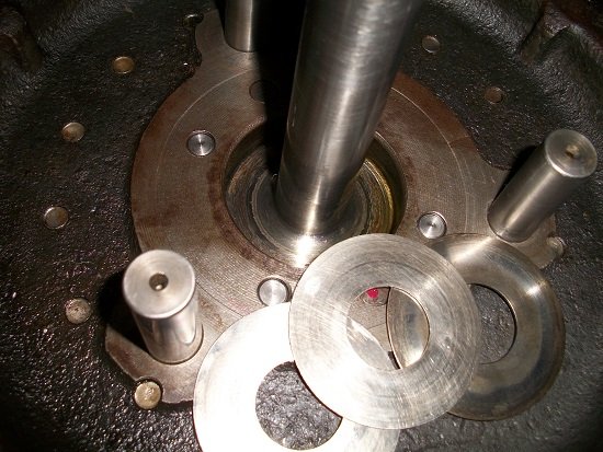

I have the the gear shaft and flywheel on crank ready to go , but i cant get the thrust washers to go down on the flywheel hole all the way down i dont want to force them in , Question -can i grind the edge of the 3 washers down some to fit them in ? Thank you for any info--

No thrust washers go in the flywheel hole. Maybe a photo would clarify what you're asking.

pictures this is a 26 trany

The best thing to do is read the Ford Service book! The reason those washers won't fit is because they don't go there!

That's NOT where they go - they go on before the clutch drum !

Yes thats right,. Thank you all for the input

Use the MTFCA Transmission book and/or Mike Bender's Model T-Tips videos on YouTube.

Wrong location. I use the Ford service manual when I put a T transmission together. Or at least refer to it before I put a T transmission, differential or engine together. I’ve rebuilt a few T components but a refresh of what I’m going to do keeps me from doing the wrong thing. Been there and done that.
