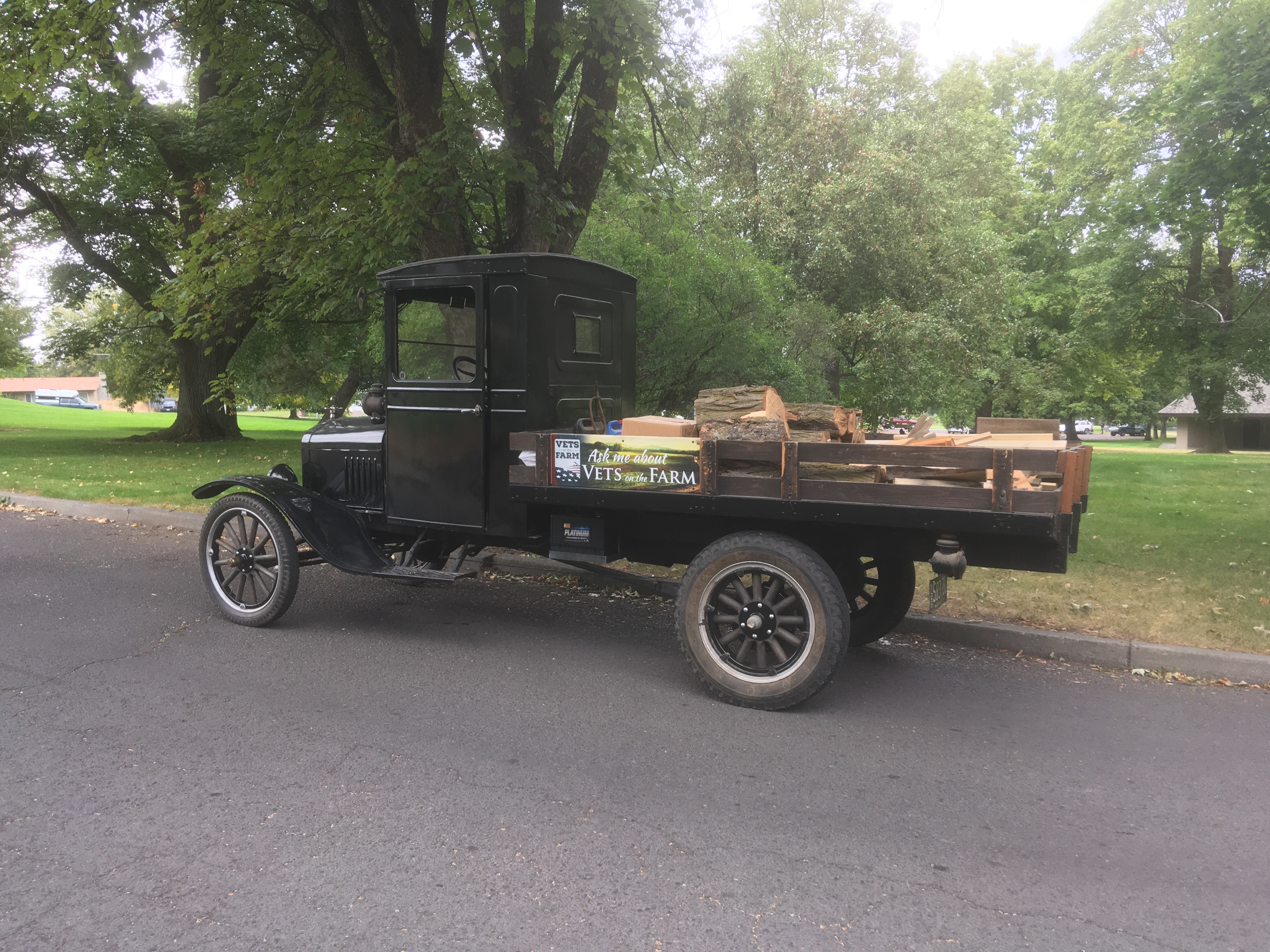

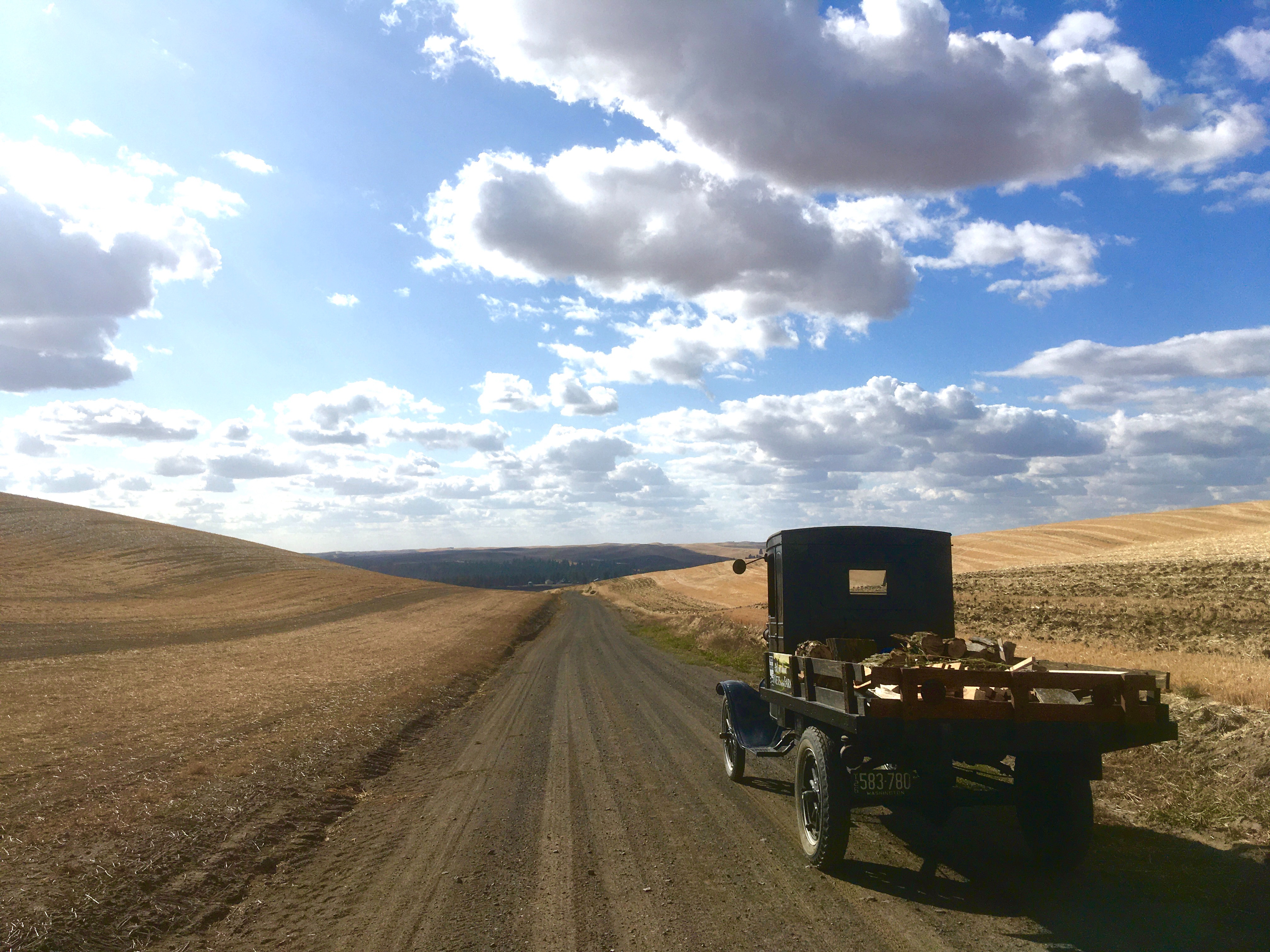

I have been driving my TT a lot since getting the rebuilt wheels on it. Twice now,
I have experienced erratic spark and after wiping down the inside of the timer with
lacquer thinner, was back to running nice and smooth. The first time was when I got
it running again after being dormant while the wheels were off. I've driven about 500
miles in two weeks and it began to feel like it was intermittently running on 3 cylinders.
Another wipe down and I was good to go. What is typical ?
