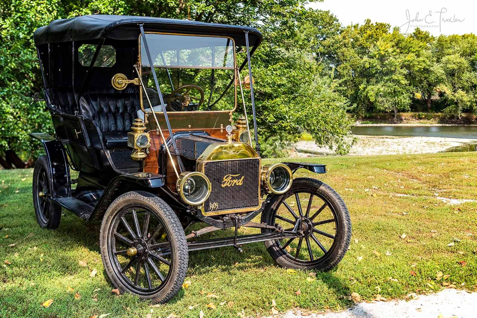

After 111 years a lot of later parts are on mine but it has the aluminum skinned body that was discontinued in Sept. of 1909 from what I have read somewhere. This is my late 09 on a rest while giving rides a couple weeks ago.
