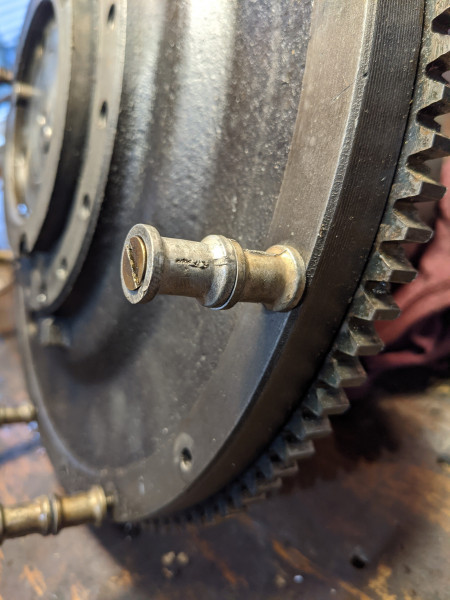

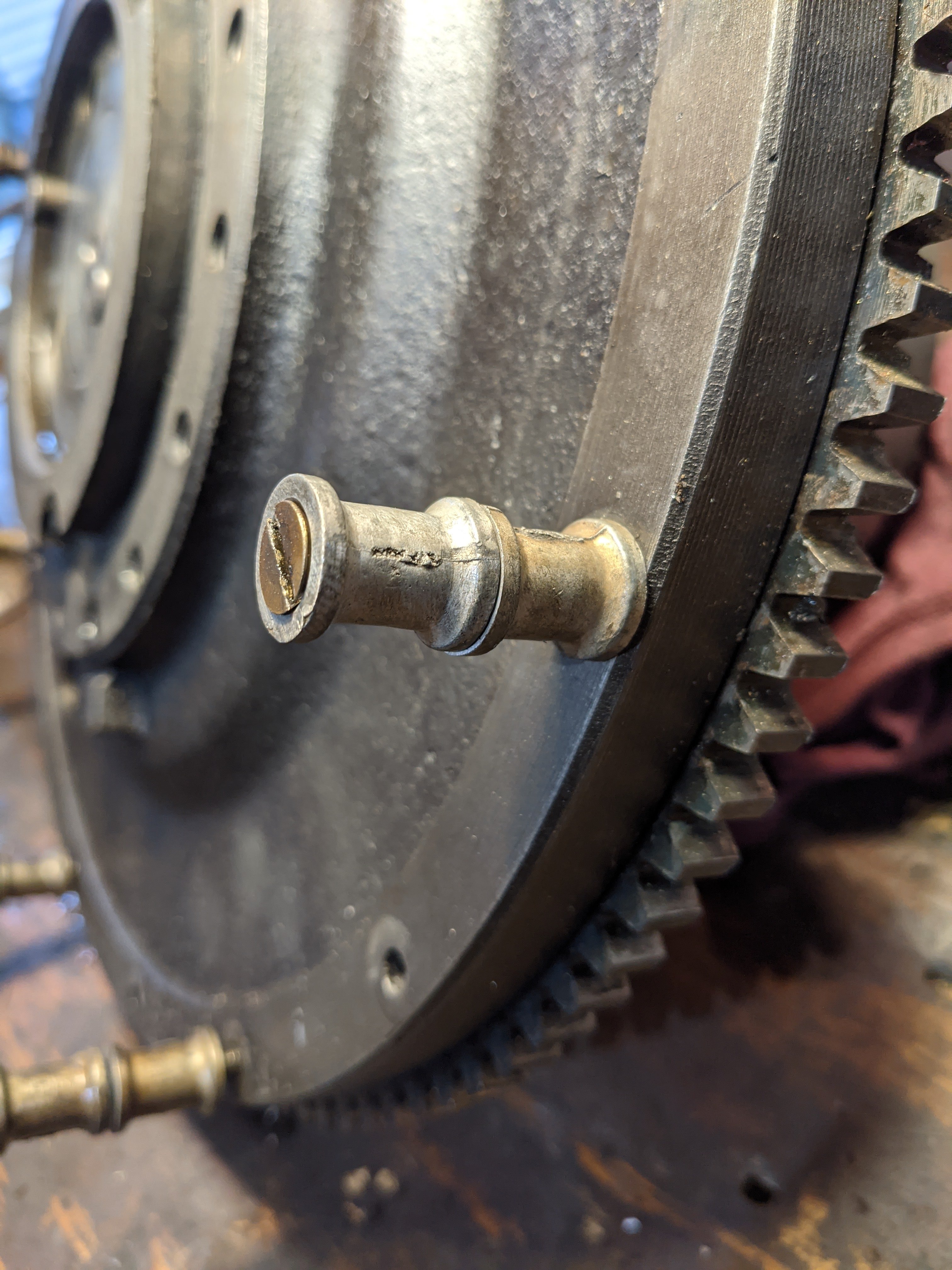

walber wrote: ↑Fri Oct 02, 2020 1:28 pmOn my speedster, I left out the mag ring and magnets but kept the spools on the flywheel to help fling the oil. Not sure about long term but it's worked for me since '94.
On a stock T I would keep the mag ring and magnets. The momentum from the flywheel is good for the heavier car and you or the next owner may want to go back to coils some day.
Like this? I feel like the splash from a single stack would miss the mag post oiler and maybe even the funnel. There's enough parts to do 8 stacks.
R/ Roger.
walber
- Posts: 267
- Joined: Sun Jan 06, 2019 12:55 pm
- First Name: Walt
- Last Name: Berdan
- * REQUIRED* Type and Year of Model Ts owned: '18 Speedster had 25 touring and 26 coupe
- Location: Bellevue, WA
Re: Engine building considerations
I used a single stack all the way around but while the internal funnel is installed I also run pressurize oil to the mains which gets plenty of oil up front. The spools are there mainly to ensure enough oil gets splashed around for the transmission. Doubled spools might well be better if using a splash system augmented by a mag post oil fitting.
