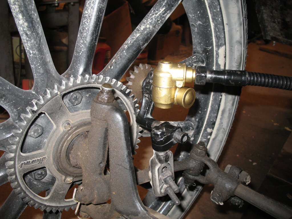

When Ford quit supplying speedometers in 1915, they continued using front hubs that were machined for mounting a road gear up to 1918. That's why I sent Noah Stutzman 1918 hubs for my new 1915 wheels. They are not only a little sturdier than the earlier hubs, but are also made for mounting a speedometer road gear. They were also originally equipped with roller bearings, so I added notches inside the hubs for removing Timken bearing cups.
This shows the screws that hold the Stewart road gear against the machined hub flange. The hub has Ford-supplied holes for the screws. If your hub is later than 1918 you need a gear that mounts on spacers and is screwed to the spokes, and you need to be very careful to get it centered. Russ Furstnow's book tells you which speedometers are right for your year (several companies made them).
