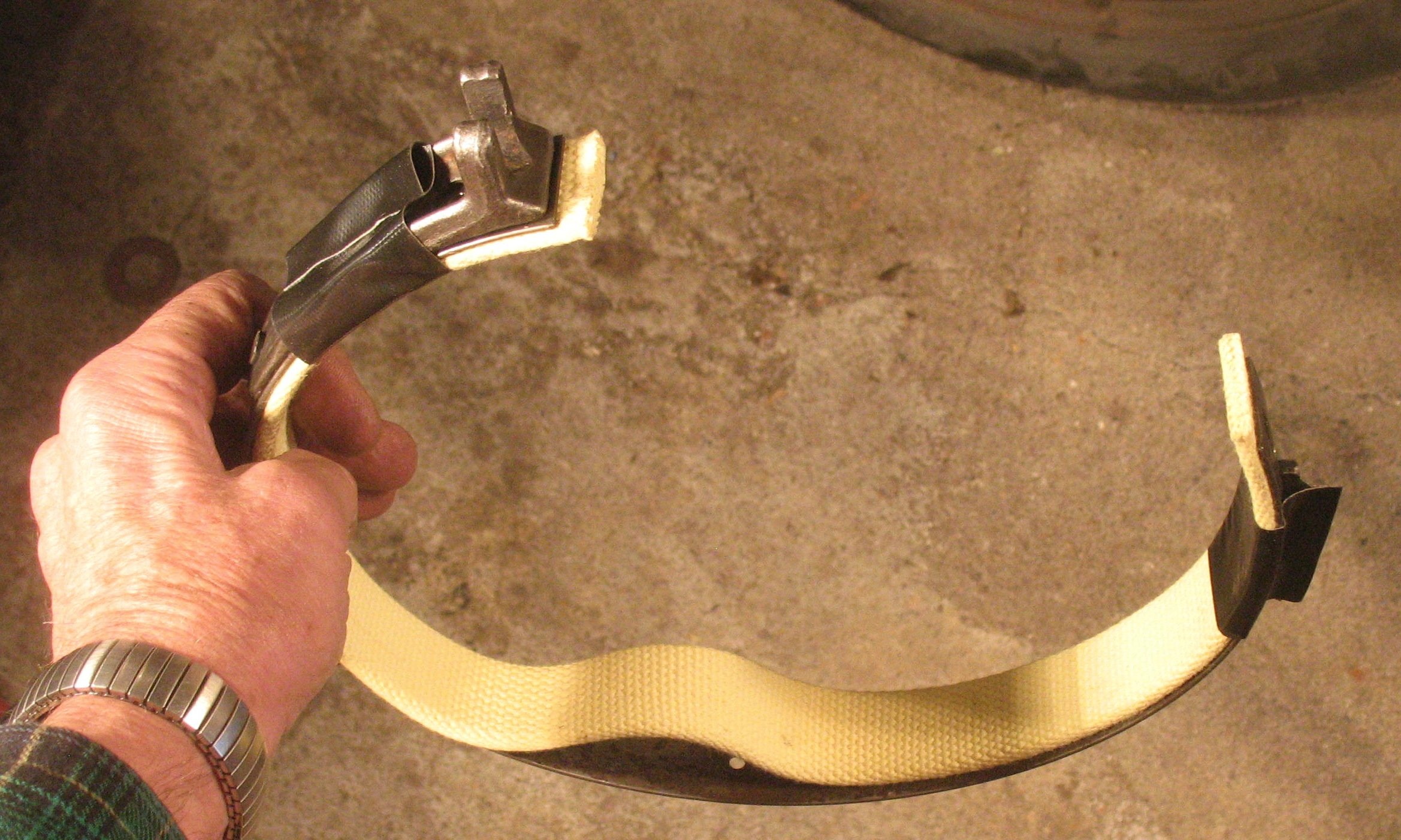

Fresh Kevlar is light yellow.

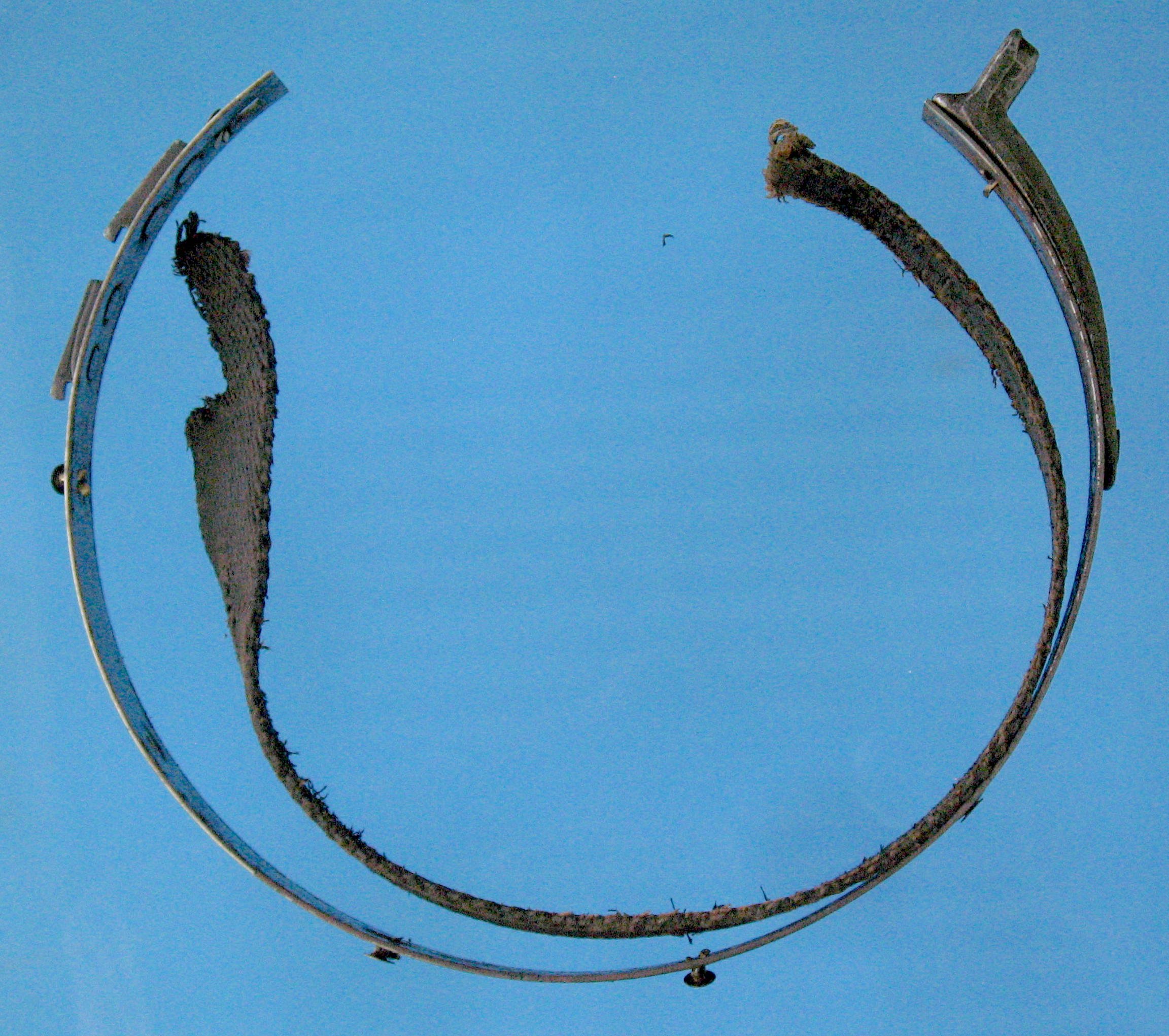

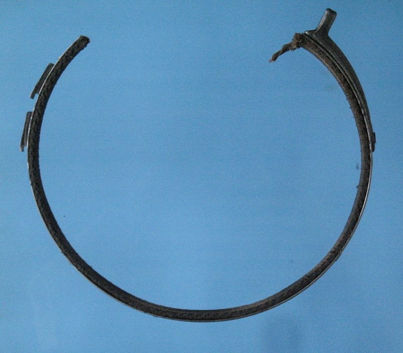

This Kevlar lining (damaged by a bad drum) has turned light gray in oil.
Used cotton linings are dark brown.
Cotton also rots.
Cotton also rots.

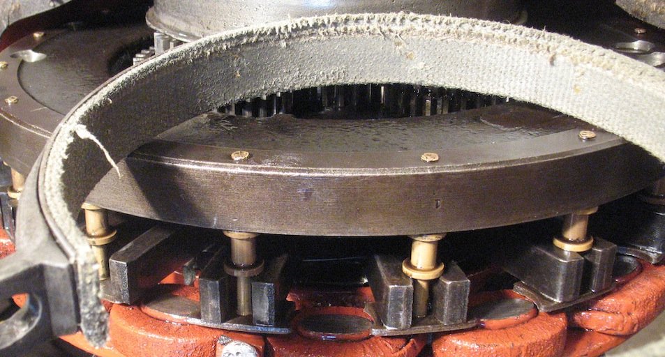

They still look great.
My NOS tires looked great, too. Like new. They didn't last 500 miles. I realize rubber and cotton are different, but cotton deteriorates with age too, as that last picture shows. If you use them, check them often.
