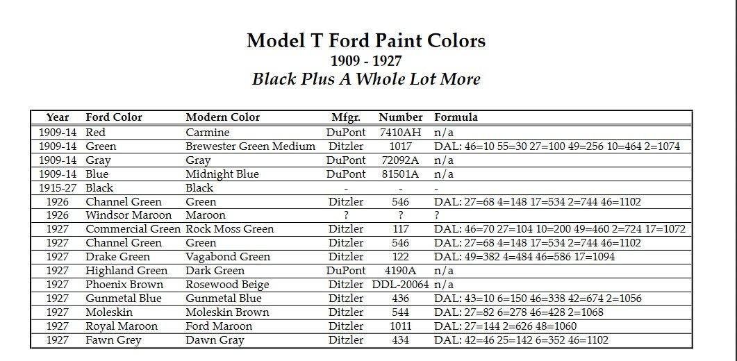

My name is Dave Beck and I am restoring a 1926 roadster. I would like to paint the body the gun metal blue if possible but have been unable to find a current Dupont paint code for it. I have tried the old codes and none will cross to Dupont. I would like to do a base coat clear coat paint job. If anyone can help please feel free to contact me. e-mail is drillmotordave@yahoo.com
Thanks for any and all help.
