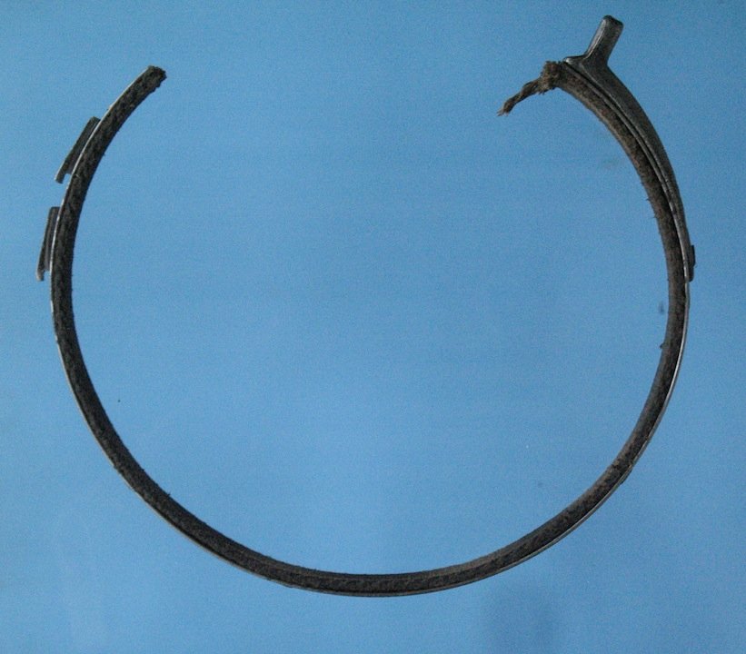

The ends of most Kevlar linings have been treated to stop them fraying. This makes those edges feel really hard. Cotton linings are much more forgiving and will be softer. Prod those with a blunt point and they will give somewhat, whereas kevlar is much tougher and will not yield to prodding in the same way. You might prise the suspected kevlar lining up off the band between two rivets and see the oil stained but still yellow colouring of Kevlar bands.
Fresh Kevlar is light yellow.
This Kevlar lining (damaged by a bad drum) has turned light gray in oil.
Used cotton linings are dark brown.
Cotton also rots.
