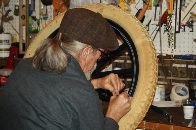

I have a set of white Universals purchased new just over a year ago with new tubes purchased at the same time. The car has been rolled out of the garage twice in that time. They are turning yellow. The fronts went first and now the rears are turning yellow. Art

I experienced the same issue than Art...with same timming. Comming yellow slowly but surely too. I bought the right tube at Lang's but the garantie about white turning yellow expired unfortunately. I decided to keep as is. It's look like she had the original tires. It is the only way I found the positive.
