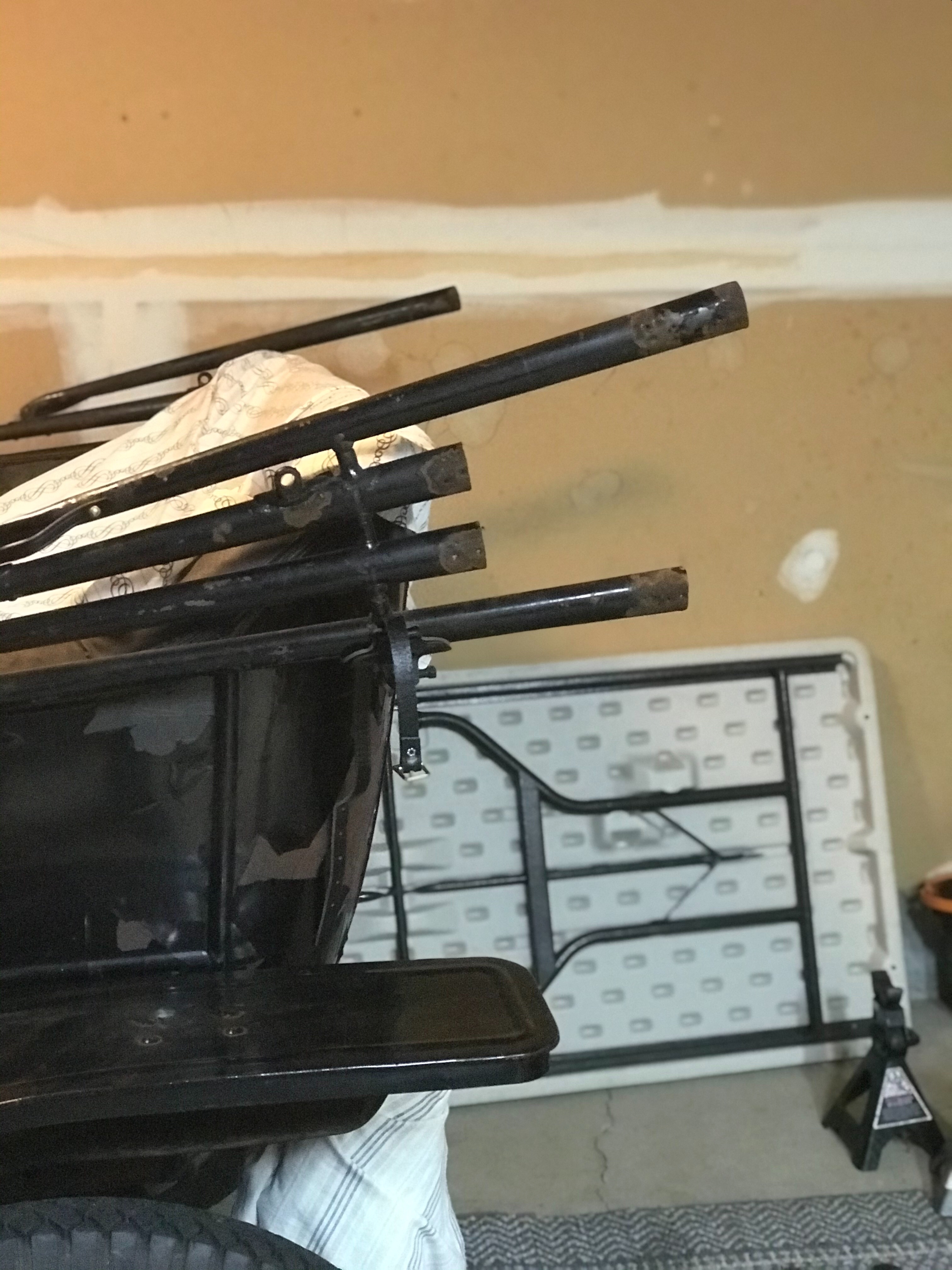

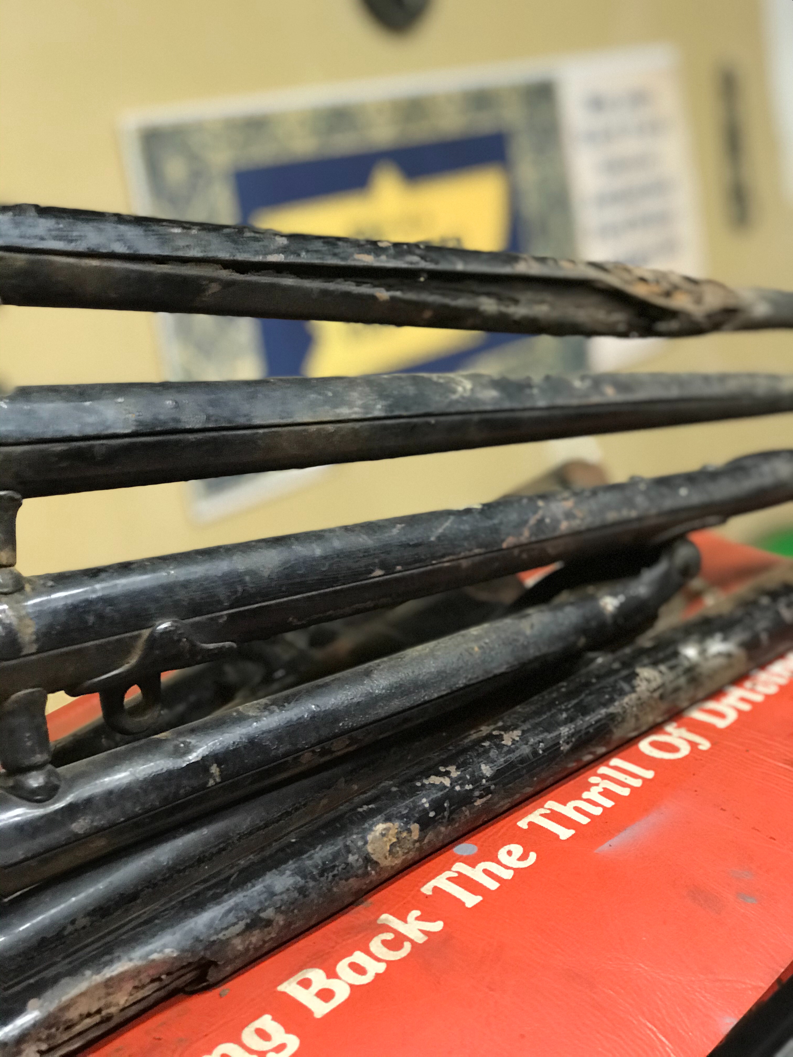

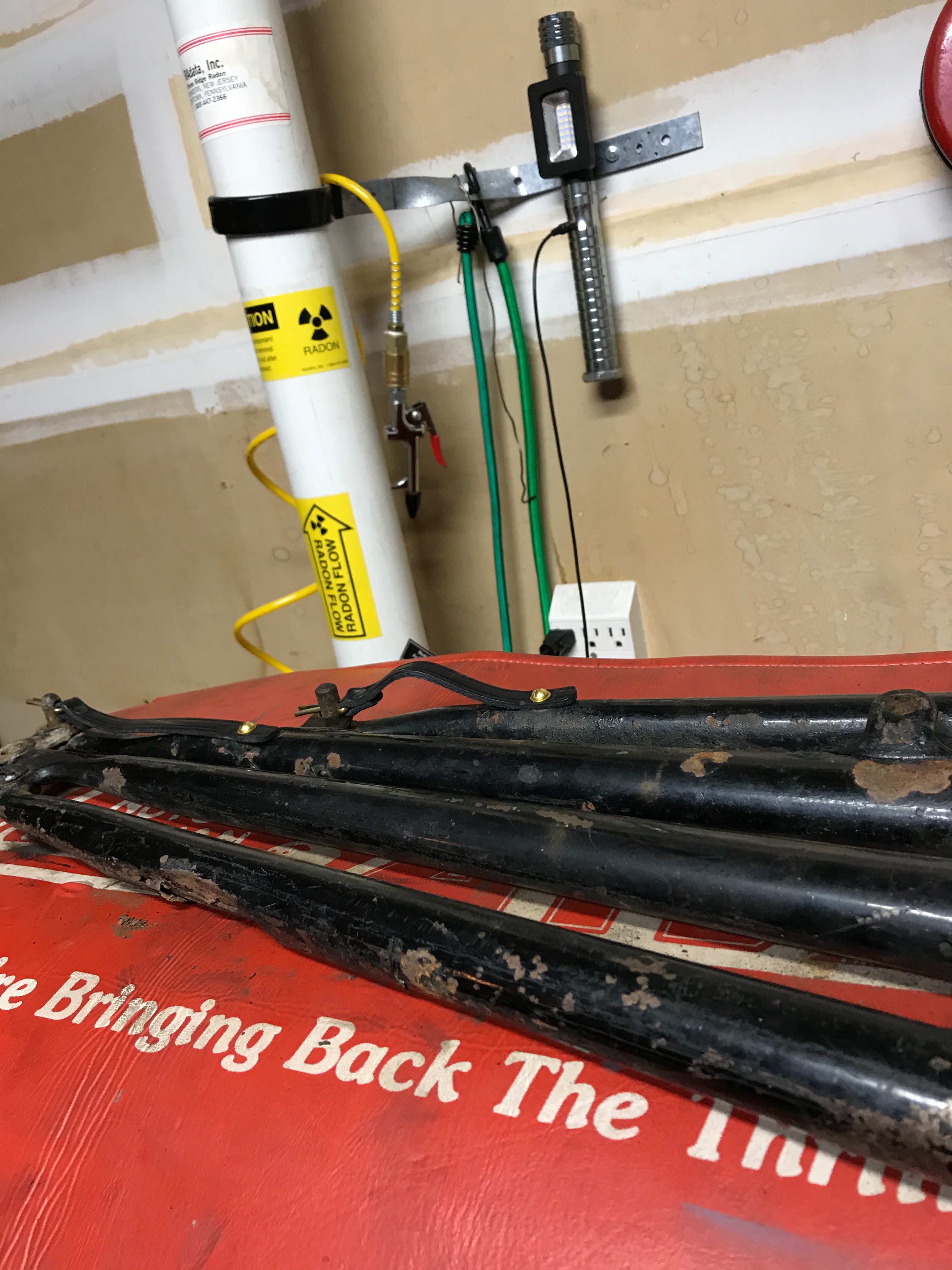

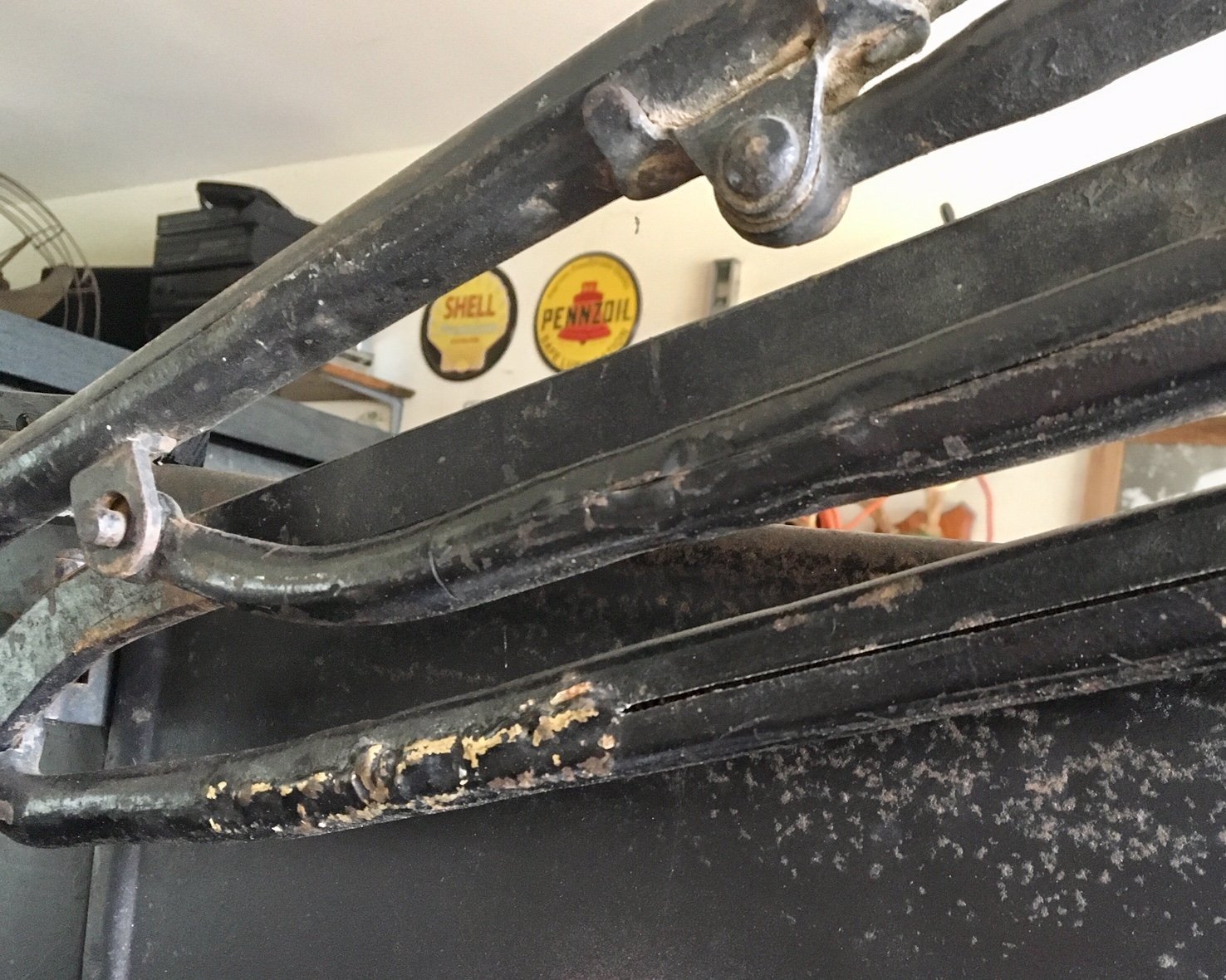

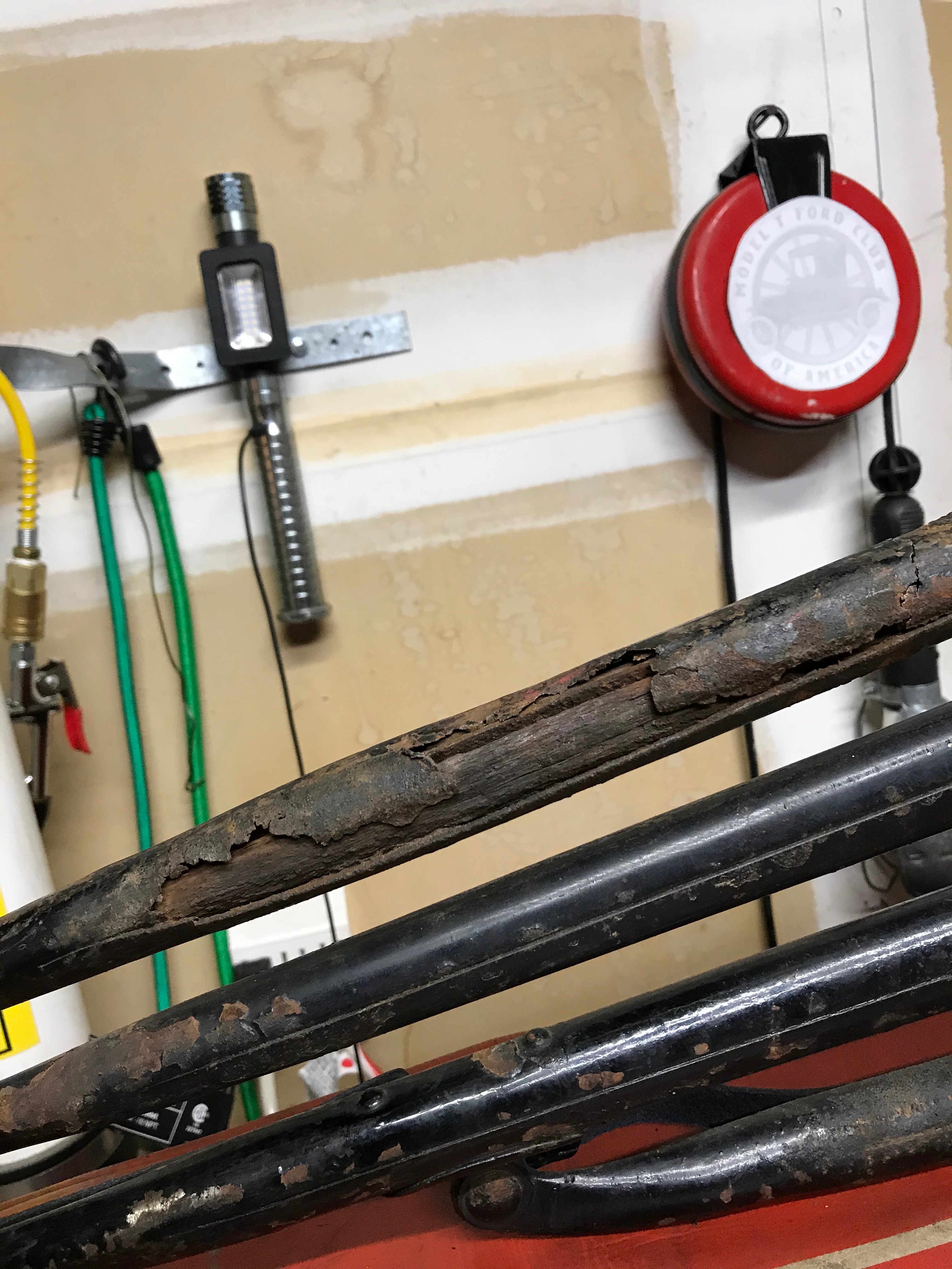

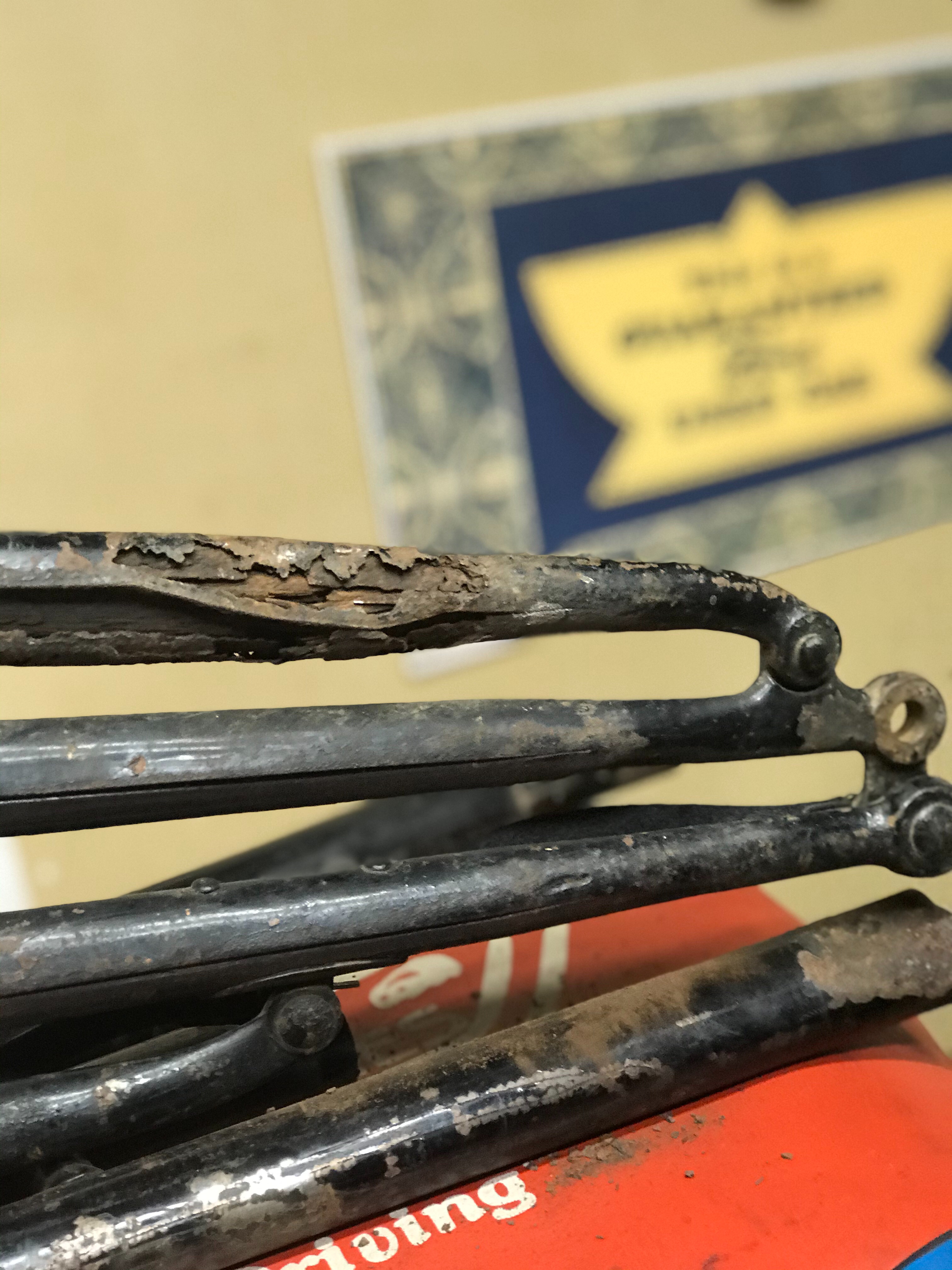

Are these 1913 Touring irons worth restoring?
Have members here restored worse?
Any advice appreciated.

Sure watch this;

I would say no, unless you can source new tubes to fit to your cast fixings. The top irons are the foundation for perhaps the most visible part of the car. There is nothing worse than spending heaps of time patching up rusty tubes and the having that same rust break out a couple of years down the track and the top assembly being weakened by recurring rust problems. I consider the cost of new irons an investment in peace of mind, knowing the job has been done as well as possible.
Others will differ.
Others will differ.

They might be available reproductions for a high price, or maybe find them at a swap meet. I would say at best you might be able to remove the wood and fashion out of sheet metal a part to slide inside and braze in place. You don't want to be driving along in the wind and have the top collapse on you! If you have a low garage door or use an open trailer it is necessary to lower the top, and continual raising and lowering the top, those bows get a lot of twisting force. I would, if it were mine, look for a better set.

There was a time when you could find decent bows and irons at swap meets and maybe you still can but the ones that are being reproduced now are pretty good. The later irons around 1919 and up seem to have survived longer than the earlier oval ones.
If you can repair yours that’s fine but for me I would buy some new ones. This sort of falls in the category of whether to try to repair or replace an original T radiator.

I would suspect from the photos that there isn't much salvageable sheet metal there. However the ends and fitting are certainly good enough to use. Many good looking irons are rusted badly inside and fail after restoration. The early sockets made in two layers are terrible moisture traps.
http://www.mtfca.com/discus/messages/70 ... 1509727571
