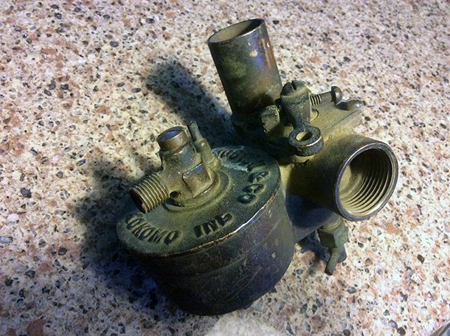

Are you talking about this Model A carb?
