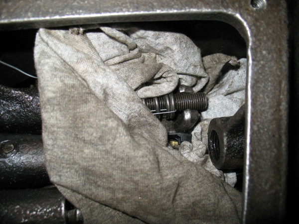

AND DO NOT DROP AN ADJUSTING NUT OR WASHER DOWN INSIDE.
Stuff rags or paper towel down the side of the casing, below the nuts.
Best to tie the ears of each band together with thin wire before you start.
(Or there is a tool)
Then there is no tension on the nuts.
And when you withdraw each band, having removed its detachable ear, pull a cord or wire round to help pull the new band back.

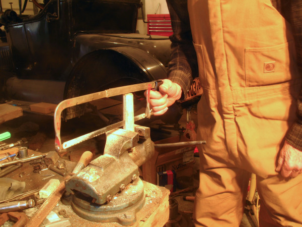

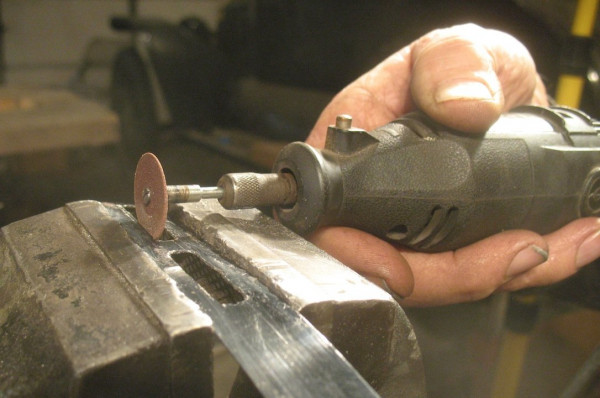

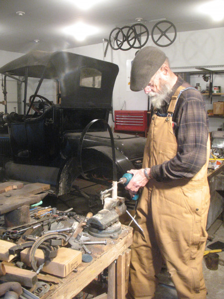

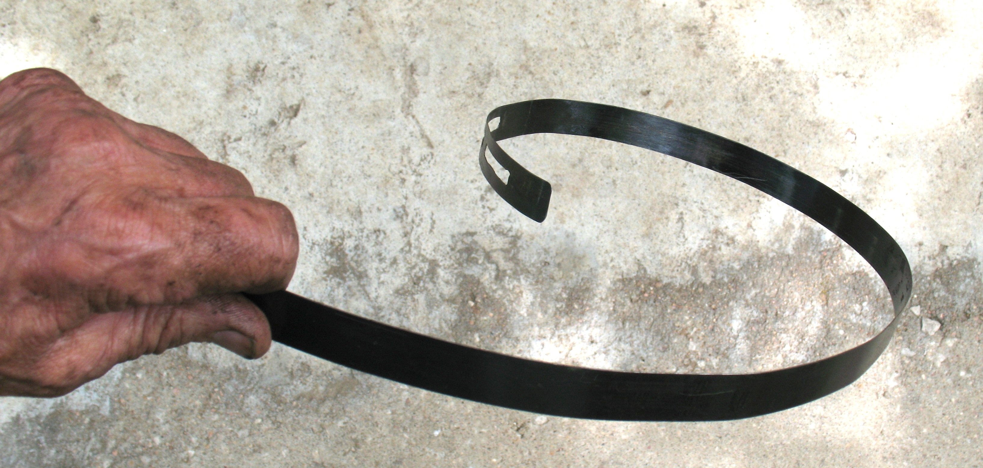

A handy tool is this puller. It pulls the bands around the drums. You can buy it or make it from a piece of pallet strap.
This is what Chris mentioned to avoid dropping nuts and washers into the transmission (a major PITA). Either use one big piece of cloth like a towel, or count the rags going in and coming out.
