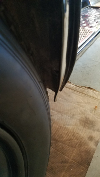

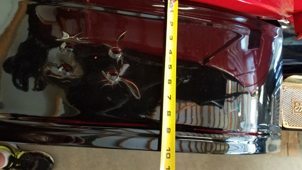

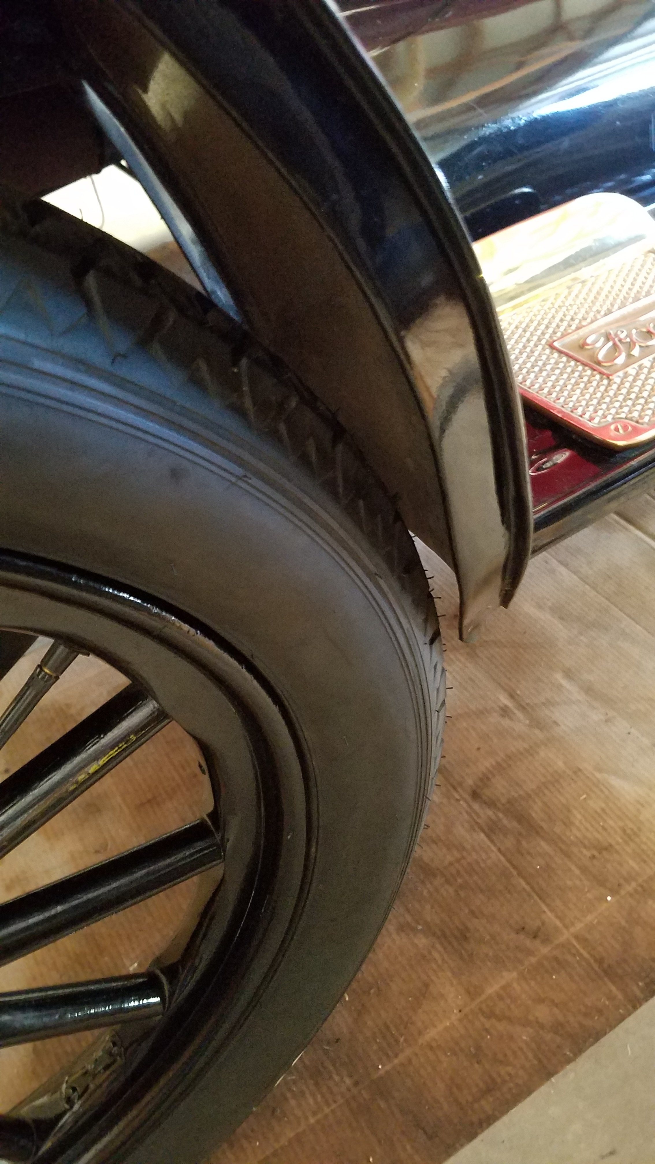

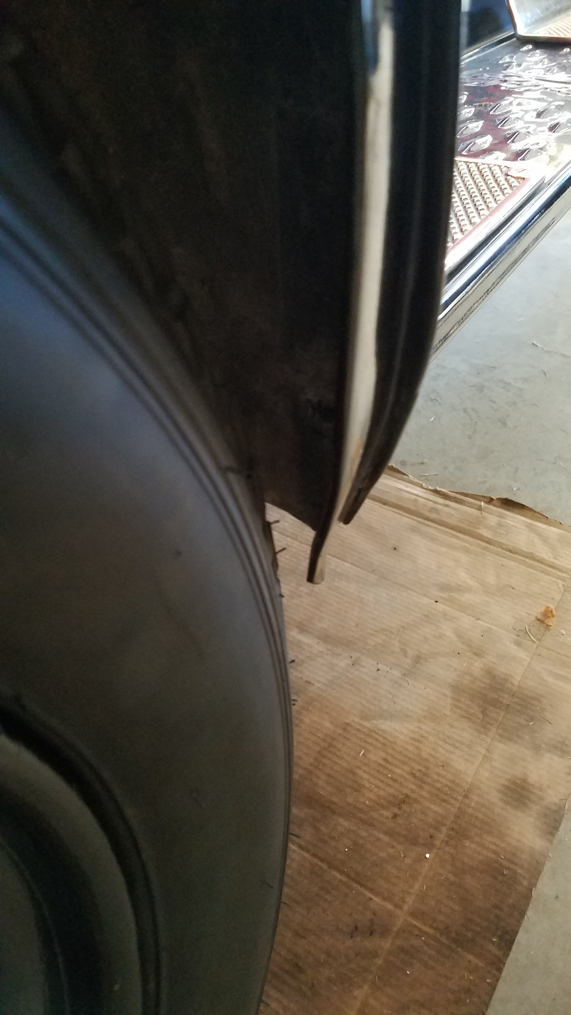

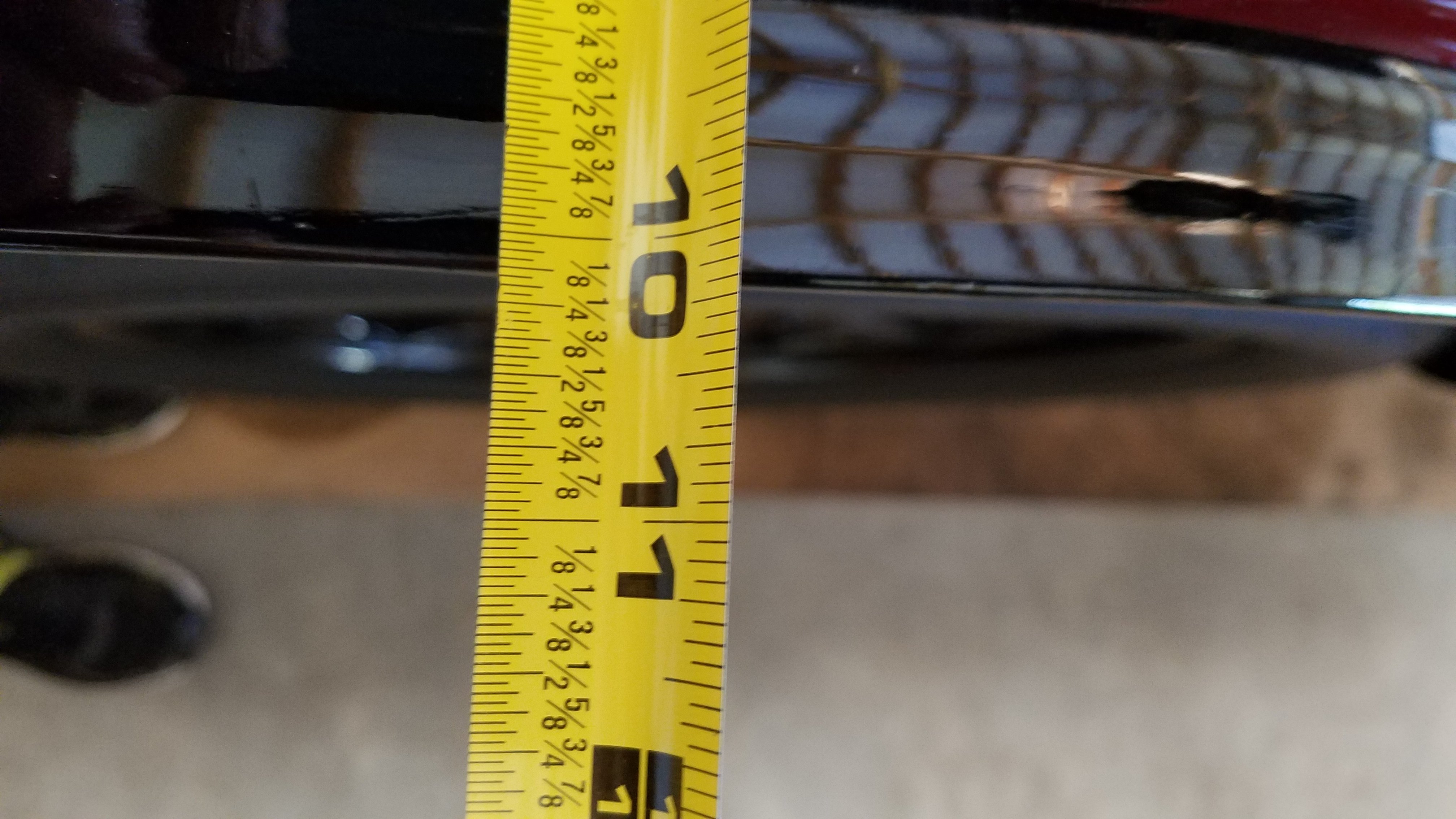

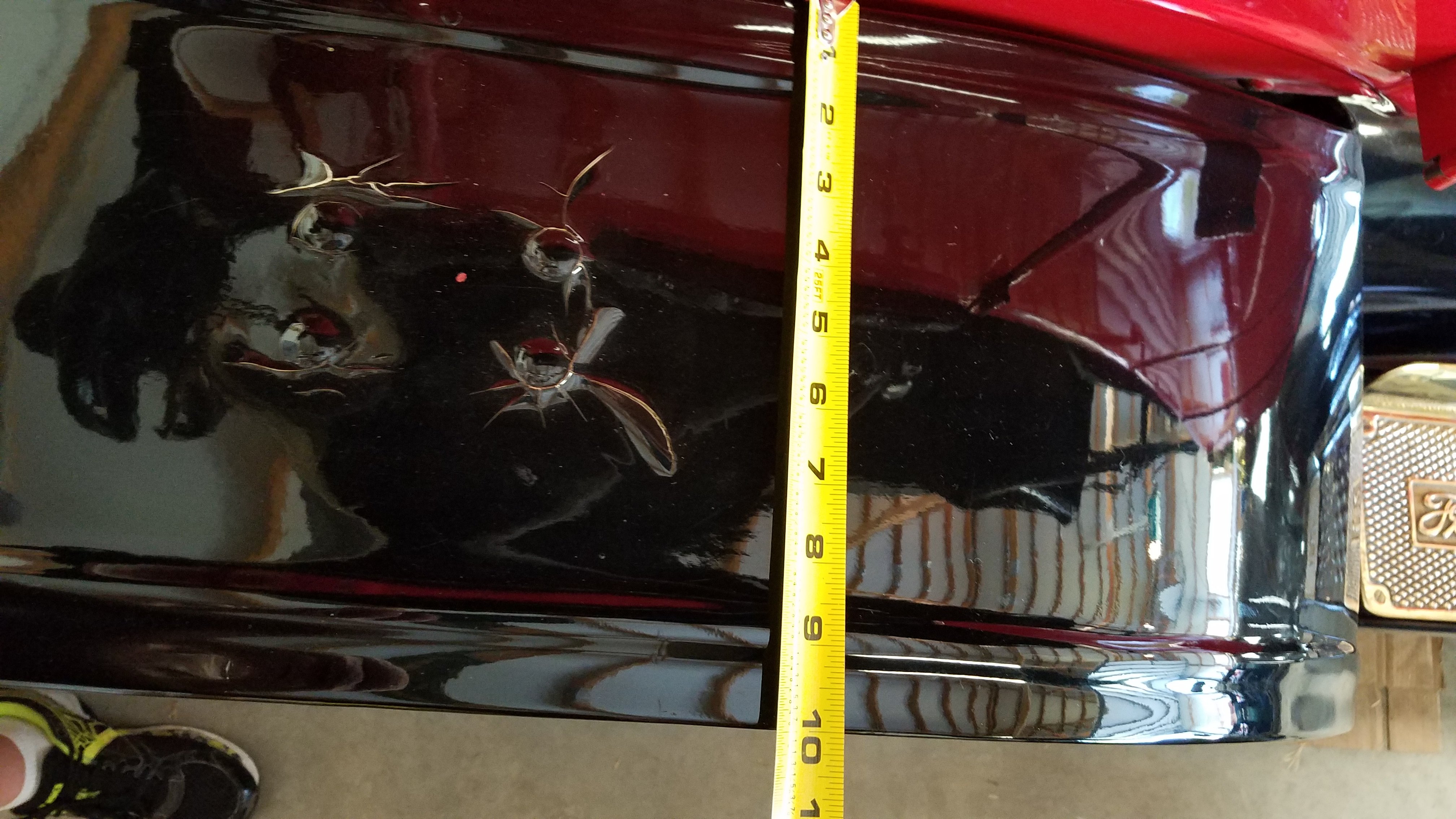

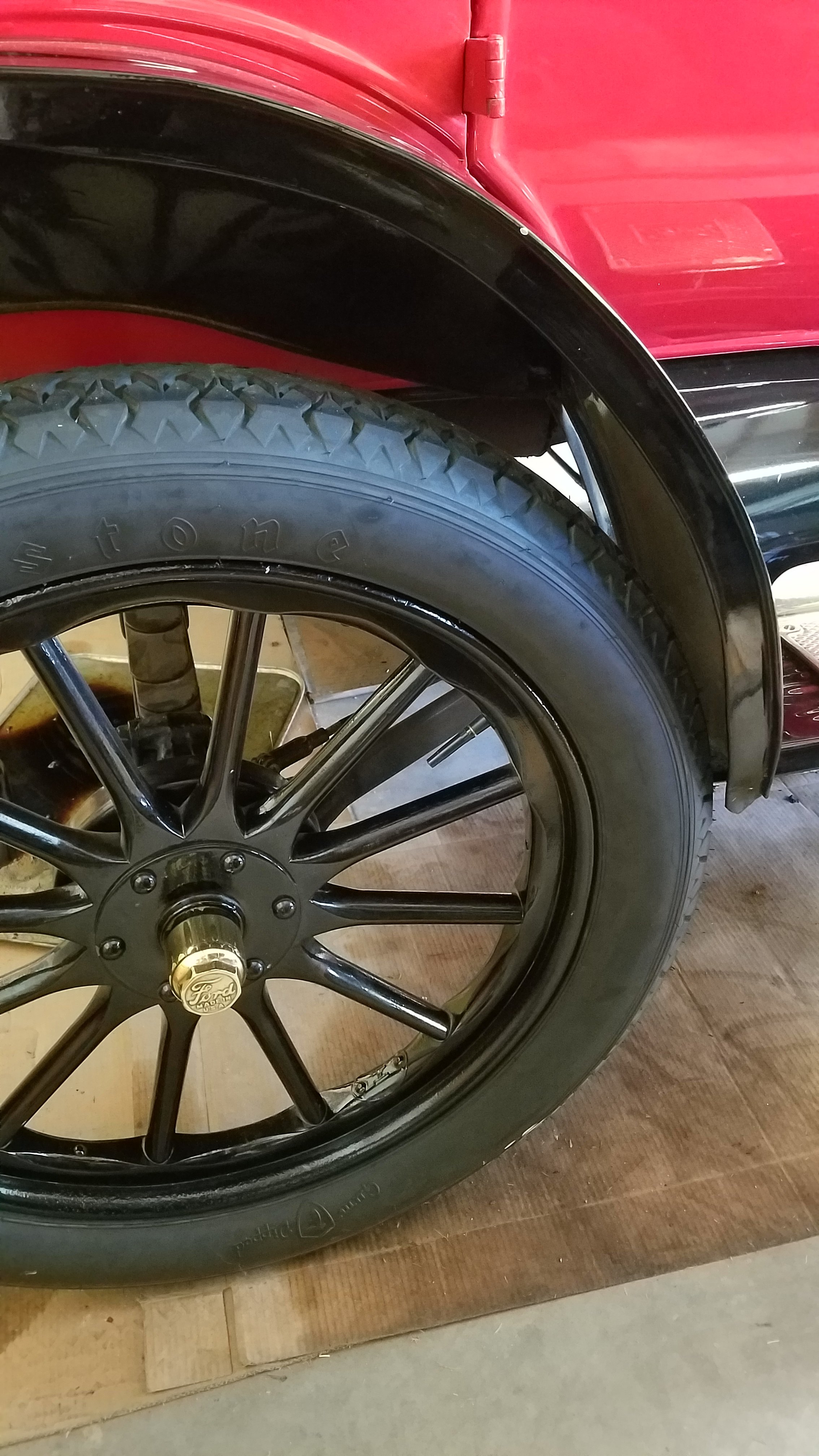

Here are some pictures of the issue. My fender is roughly 10 and 1/8 in wide.

Are both sides that way or just that one? Dan

Post by Wayne Sheldon » Sat Oct 10, 2020 8:01 pm
That appears to be a wide-track fender. Check very carefully whether the rear end (axles) is/are properly centered and square with the chassis. Also check that the body is squared, and the running board brackets. Any and/or all of those things being off even a small amount can result in the rear end and fender not centering between themselves. Many people are bothered by that fact when they look at their unloaded car and see how close the tire is to the fender. Remember, the rear end forward position is fixed by the torque tube, which slopes down from the transmission to the rear end. When heavily loaded or hitting a bump, the rear end is pushed up in relation to the chassis and the torque tube being leveled out a bit shoves the rear end back significantly.
Normal clearance is tight in that spot. If the rear end is slid over a quarter of an inch to the right, and the running board bracket is pulling the running board in to the left another less than half inch? the compounded error is enough to cause the tire and fender to collide. Remember, that rear spring's sagging or poor quality re-arching can also shift the rear end sideways a bit. Another one many people never look at, is if one side the spring perch is frozen in place, it with throw off the axle centering properly.
Your simplest fix may be to carefully bend the rear running board bracket to move the running board out less than a half inch. It doesn't take much, and many if not most original running board brackets over the years got tweaked enough to cause problems. Problems that most restorers do not check for or fix while restoring the cars. Then a simple centering of the top fender bracket to balance and square the fender. But you want to make SURE there isn't a centering issue with the rear end first.

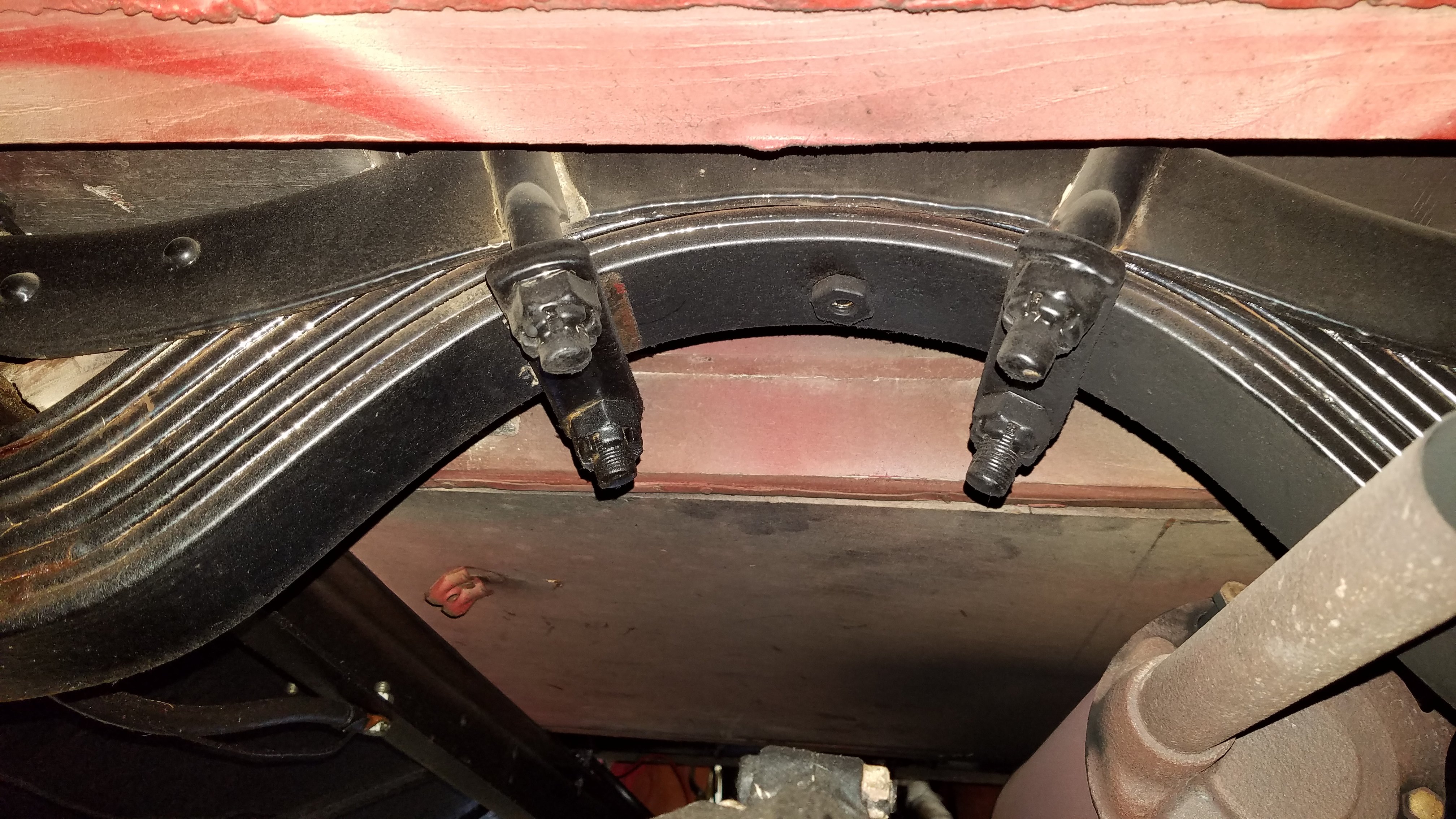

Post by dr1960 » Sun Oct 11, 2020 5:55 pm
Looks like I may have found the issue...with Wayne's help. What is the best way to re-adjust these spring clamps to re-position the spring in the right spot?
rear spring appears skewed to the passenger side (to the right), clamp on the left has obviously move since the paint job
