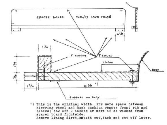

This may be posted too late to help you, but perhaps it will be of help to someone else with a 1926-27 coupe in the future. I had tried posting this as a link to an earlier posting. But when I click on the link it gave a 401 error or something similar. Since I had it saved, I will repost it here. It all deals with moving the early 1926 and 1926-27 Coupe seat back.
More room in 1926-27 coupe Service Bulletin
More room in 1926-27 coupe Service Bulletin part 2

The following is from the Jul Aug 1981 Vintage Ford page 43 used by permission to promote our hobby:
From Don Ball – answering in the column “Questions and Answers”
The [1926-27 Coupe Package] tray was made of wood and was covered with the
same material as used around the rear window area of
the body. …. The holes were not for ‘drainage”
but rather were for the retaining screws which held
the shelf in place. (They used large washers to allow for
the usual lack of precision in body construction.)
Ford had realized by 1926 that people don’t all come
in the same size and had allowed for the seat back to be
moved back for more leg room. The job was not easy;
you had to remove the package tray, saw off a couple of
inches; unbolt the seat and move it back, then reinstall
the whole mess. This procedure is detailed in the Ford
Service Bulletins and is reprinted in Ford Service Bulletin
Essentials (Post Motor Books, 1966) on pages
367-370 and 463. [note page 463 was how to move the seat closer to the steering wheel - so not included]
A drawing of the shelf, as well as the rain gutter is
reprinted here.
26-27 Coupe Package tray
1926 - 27 Coupe Package tray Jul - Aug 1981 VF pg 43.JPG (34.3 KiB) Viewed 4014 times
See also the posting at: http://www.mtfca.com/discus/messages/80257/81912.html
