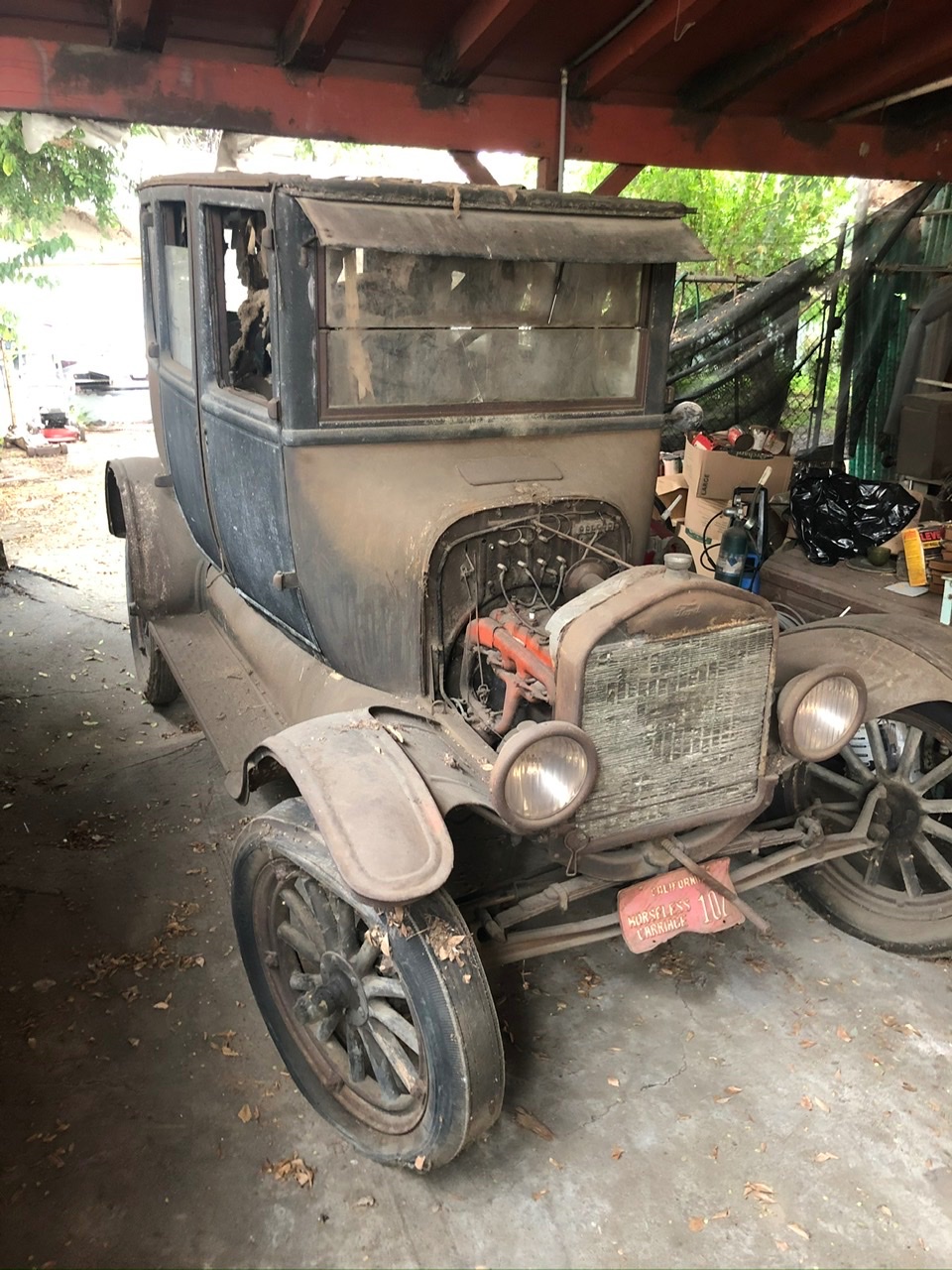

I thought you guys might like this project

I'm not sure rescuing is the right word for pressure washing the interior.

is that a high or low radiator?
“The trouble with retirement is that you never get a day off.” – Abe Lemons.
- Posts: 7411
Re: Rescuing a 23 Fordor on YouTube
23 is a low radiator.

I was thinking the body is a 24 or 25. The high radiator cars have the cowl vent as this one does.

It’s Definitely a low radiator. Others have mentioned the vent. I’m new to model Ts so I don’t know what’s what yet

It appears that the metal firewall is a low firewall which would be a low cowl late 23 Fordor.
The earlier 23 Fordor didn’t have the cowl vent.
Doing a little reading Ford began to make changes in anticipation for the higher cowl or high radiator bodies. The difference in the earlier 23 and later 24-25 Fordor bodies would be the aluminum earlier bodies on some Fordors and the cowl section difference.
This car has the earlier cowl section. While the later has the 24-25 cowl section. It appears the 2 cowl sections at the front part of the bodies would interchange and that would be the only difference in the the 23 and the 24-25 bodies.
The rest of the body it self was pretty much the same. Or so it seems.
Bruce McCalleys book From Here to Obscurity mentions changes in this period weren’t clear cut and sometimes just appeared. The vent on the later 23 body might be one of them.
The majority of the cars with the vent seem to be in the 24-25 period and seemingly not many in the transition time were used in later 23.
Others may have other ideas for sure.

If it's truly rescued it'll be a lot of work getting the red paint back off the wheels.
And one should go ahead and have the complete interior reupholstered as it will never dry out. The coil box is also probably ruined.
I believe he has done more damage with the pressure washer than the ravages of time have done. Sad videos to watch. Depressing. But it is his car and he can do as he wishes.
