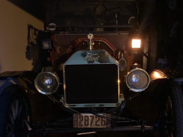

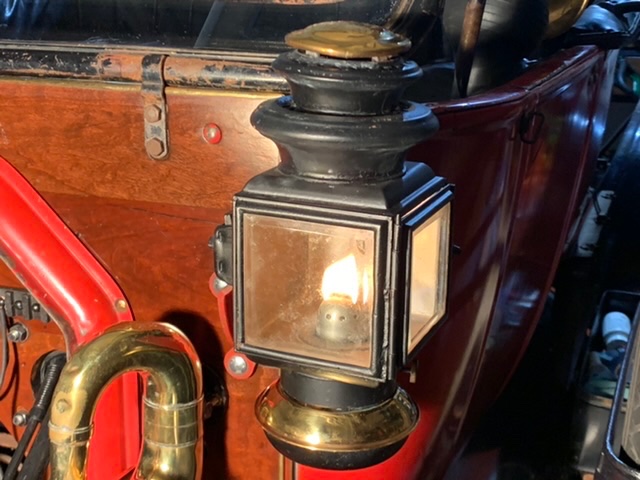

Decided to work toward getting functional lamps since I picked up an acetylene generator at Luray. Was able to get one of the oil lamps immediately started up with a new wick. Attached are the pics. The other oil lamp has a leaking base. So will see if I can seal up the pinholes then get it lit with its new wick.
For the acetylene head lamps, have parts to order and some supplies. So, I will post pics in the future as I make progress. Don’t plan on operating the lamps often... but want to know they are back in working order if the magic needs to happen.

Looking good! You might want to turn the flame down some it's too tall and looks like it about to start smoking. The wick should be tight across the top, no fuzzing and cut straight across and maybe an angled snip on each end.
