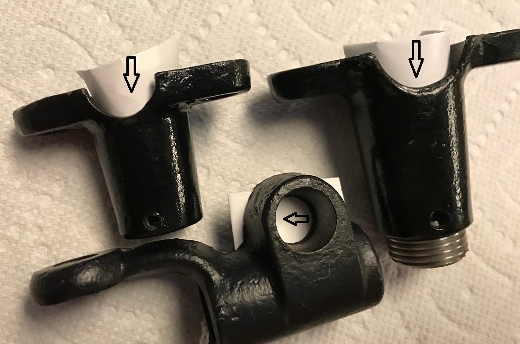

Post by TRDxB2 » Sat Oct 24, 2020 11:40 am
Another factor in choosing one over the other is the wear on the rim of the ball cap, tie rod and drag link ends. And while your at it check the un-threaded end of the yolk for wear. I used APCO style cap ends - don't have any worn stock ones
