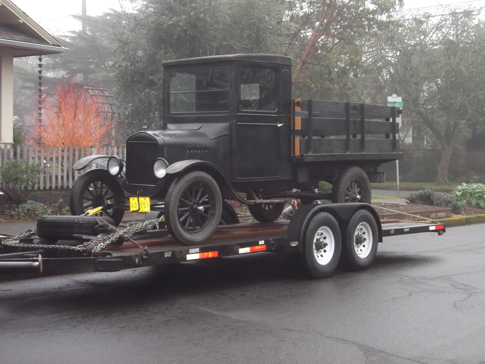

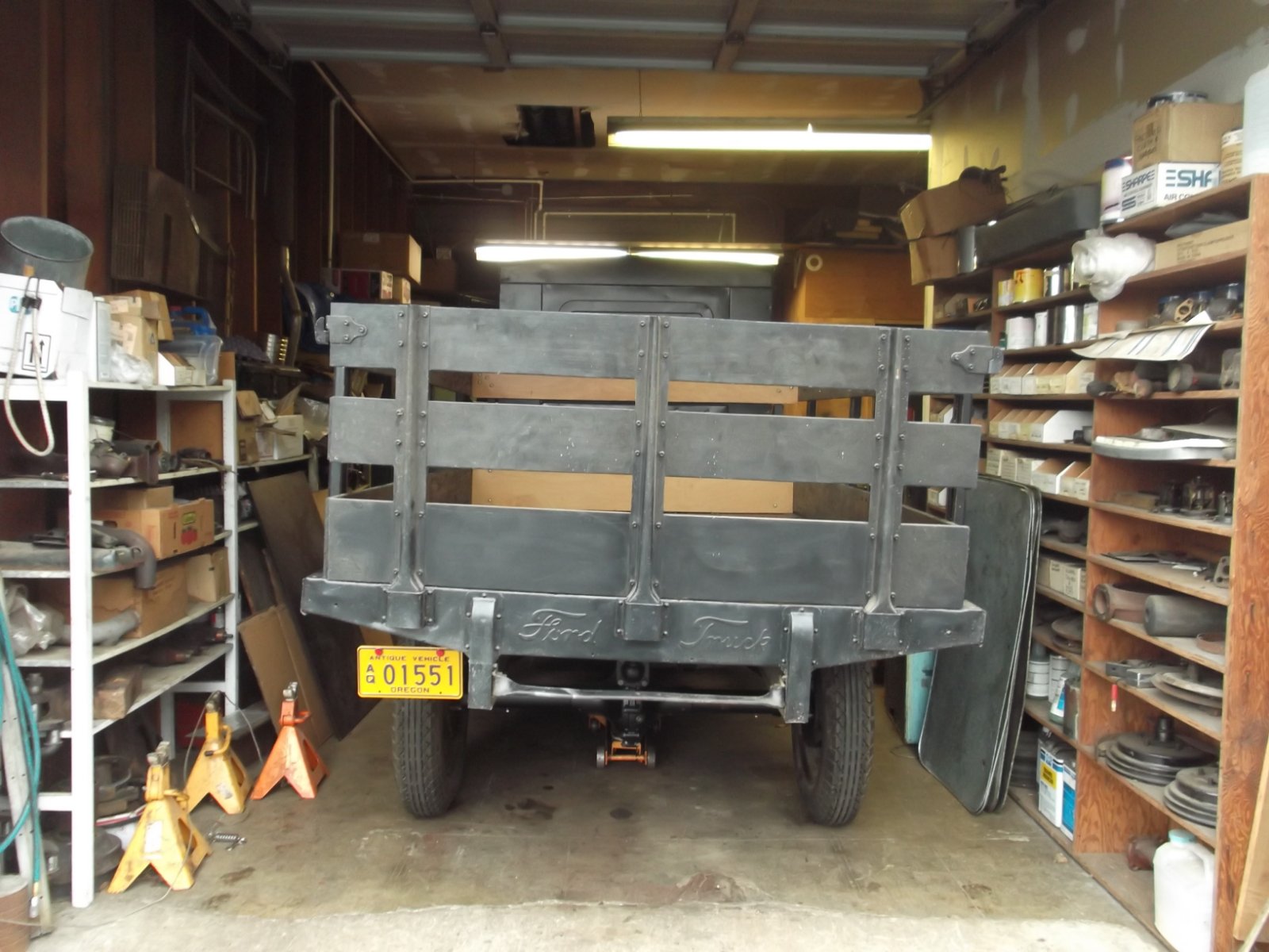

Once you get the stakes you then have to round up the latching links that connect all the sections together. The TT that I worked on had 6 panels that made up the set. I don't know if they all came that way. Sorry these are the only two photos I have right now. It would be a while till I could get more.

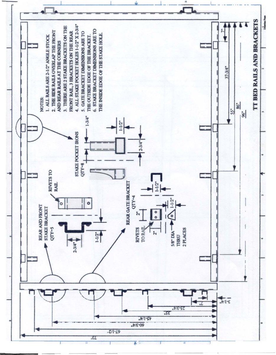

Here are the drawings of my frame rails, with stake pockets, not factory Ford, but original to my TT.
