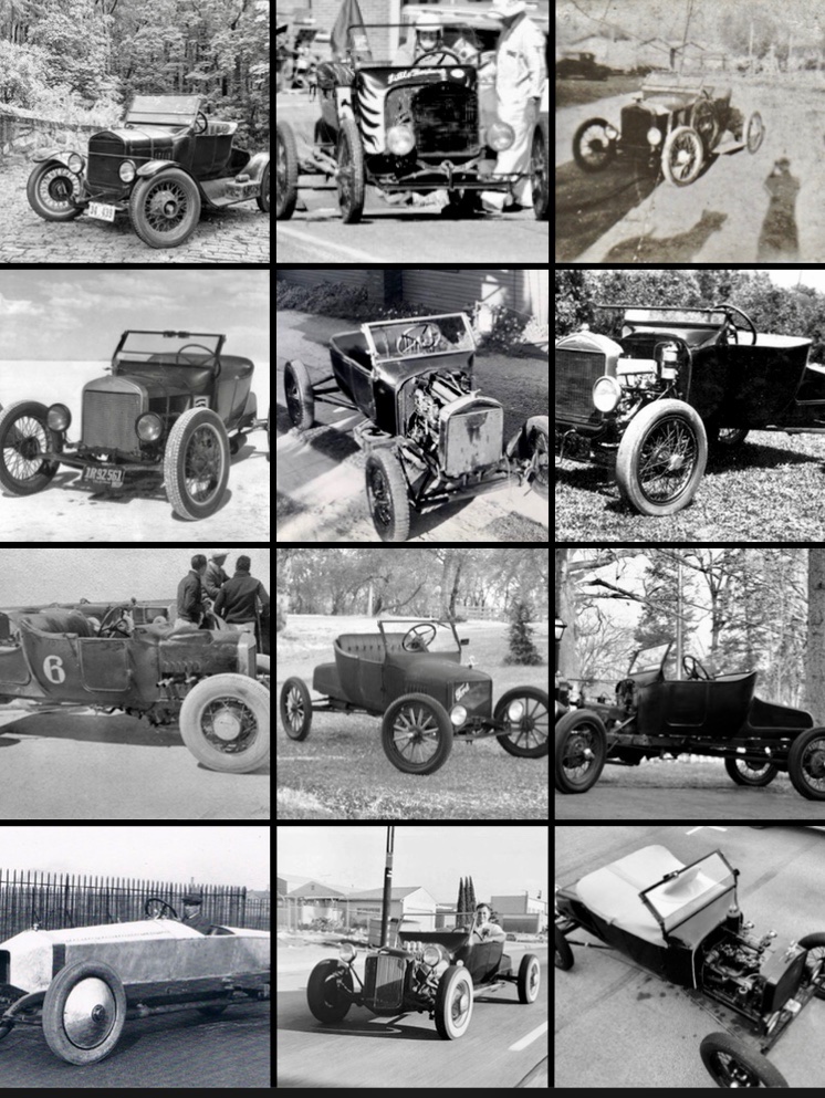

Pictured is my intended result so it's not going to be a heavy car and speed is not my goal- just more grunt at the throttle...

Tim, sent you email. Also btw we are building essentially the exact same car! I am building a lowered, fenderless, 25 roadster. And in another note I’m in western ma, and there are four more people building very similar correct 1920s-30s style hotrods in my immediate area. Drop me a line!
